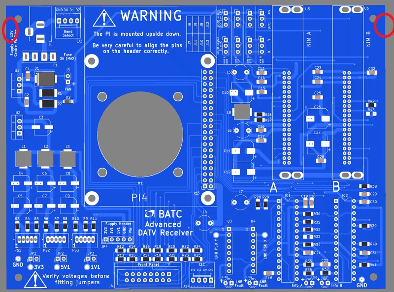

a question to the Winterhill experts or the PCB layouter of this board:
Due to some circumstances I would need to reduce the size of the board in the marked areas to fit in my case:
Are they any hidden traces at those points?
Thanks.

It was designed specifically with people like you in mind Rainer.
It is a two layer board. There are no hidden tracks, a few that may have been misplaced, but none actually hidden.

Thanks Mike for the quick reply and the good news that the board will fit in my ordered case!
