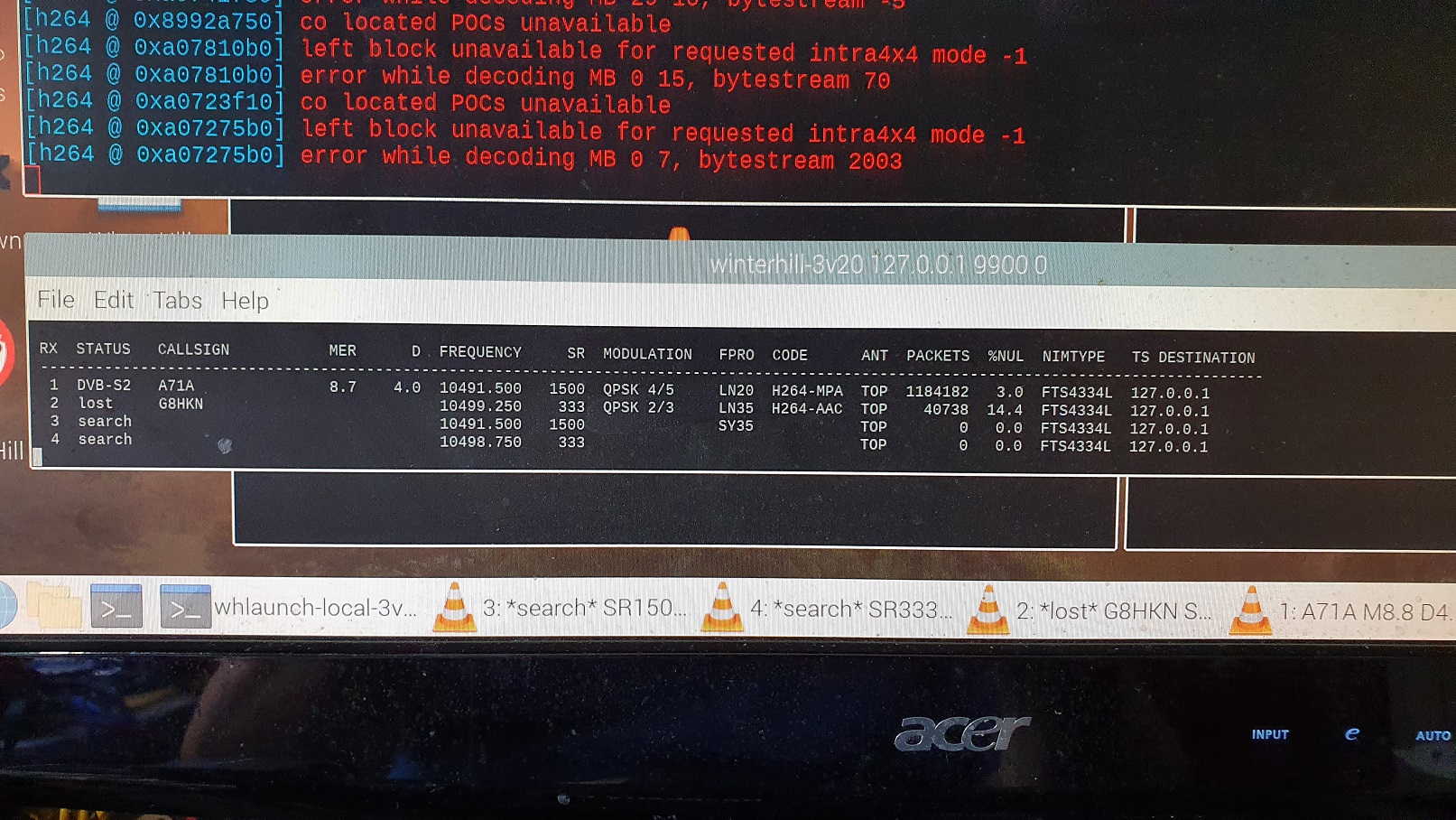

When I have a cable (to the lnb) in Nim A, Top socket, I get the beacon, with the garbled video and good audio, AND I then have got a P5 picture on VLC window 2 from a Amateur DATV transmission as well, despite NO other lnbs being connected.
What I cant seem to figure out is which Nim socket is associated with which receiver. Sounds daft, but I cant see anything in the docs to tell me.
Logically I would expect Nim A Top to be rx1 and, the bottom to be rx2, and Nim B to be Top for rx3 and bottom for rx4.
OR Nim A to be rx 1and 3, and Nim B to be rx 2 and 4.
When I first fired up my Winterhill, I got P5 with good audio from the beacon.
Now I cannot get the beacon video as its garbled with vertical striping, although the audio is still good.

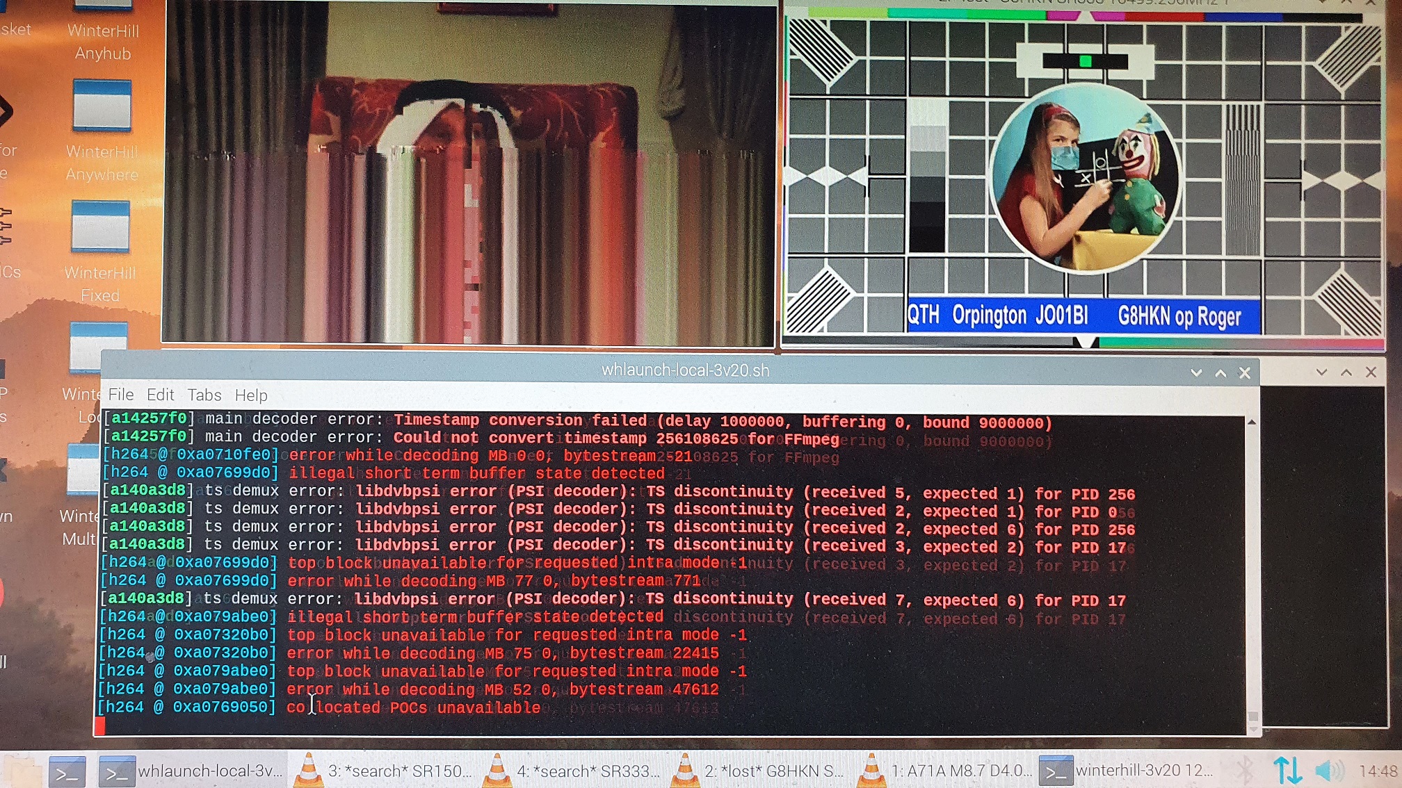

I don't understand why I get garbled video on Vlc Window 1, and P5 picture on Window2 (This is the G8HKN transmission in the picture)despite only one lnb cable being connected.
Can someone tell me which socket Nim a/b, top / bottom etc is associated with which receiver (1-4).

Furthermore the Launch window is scrolling (in Red) like crazy, they look like error messages (see picture below).

>>There are 4 receivers, and 4 sockets. Logically that's one socket per receiver.
No. The NIM effectively has an RF router on each F socket. The default configuration for WinterHill is to feed the LNB signal into the TOP F socket on each NIM and route the signal coming in on the TOP socket to both receivers in that NIM.
The WH system has 4 receivers: RX1 and RX2 are in NIM_A and RX3 and RX4 are in NIM_B. Each of the 2 receivers for a NIM can be independently fed from the TOP or BOT F socket on that NIM. This is selected in the receive command sent to WH.
If you are using QuickTune, each receiver in the settings can be set to FPlugA, which is the TOP F socket, or FPlugB, which is the BOT F socket. The default for WH is to always use FPlugA (TOP).

You can often get VLC errors in the launch window, even though video is being displayed OK. It may be complaining about the faulty beacon data, although mine isn't doing that.
