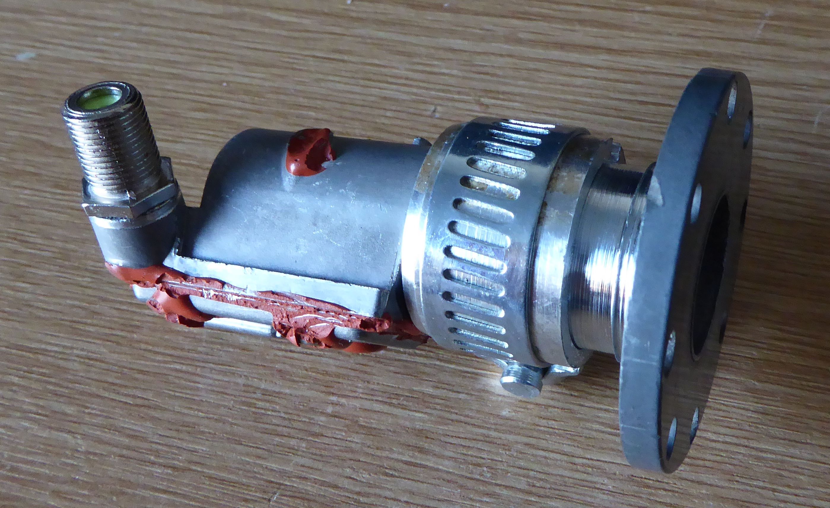

I made a PLL C120 LNB by taking a C120LNB cutting off the flange and a little of the pipe and an Octagon LNB and cutting off the horn, joining the PLL LNB to the C120 flange using a hose clamp and some thin aluminium sheet.
- C120.jpg (665.52 KiB) Viewed 6935 times

Wow, I am surprised you can get away with something like that at 10Ghz.

Don't be surprised, it's only waveguide. The two diameters are the same usually so it is only a matter of getting a good join between them so the RF flies straight past without perturbation. Make sure there is no gap between the tubes and it will be fine. That's exactly how the C120 flange works when fitted to the feed horn. If you don't have a C120 flange you can bore out a bit of aluminium to k=make one and graft it on to your sawn off LNB. It doesn't have to be a good electrical contact, it is merely a way of clamping two bits of tube together accurately.
