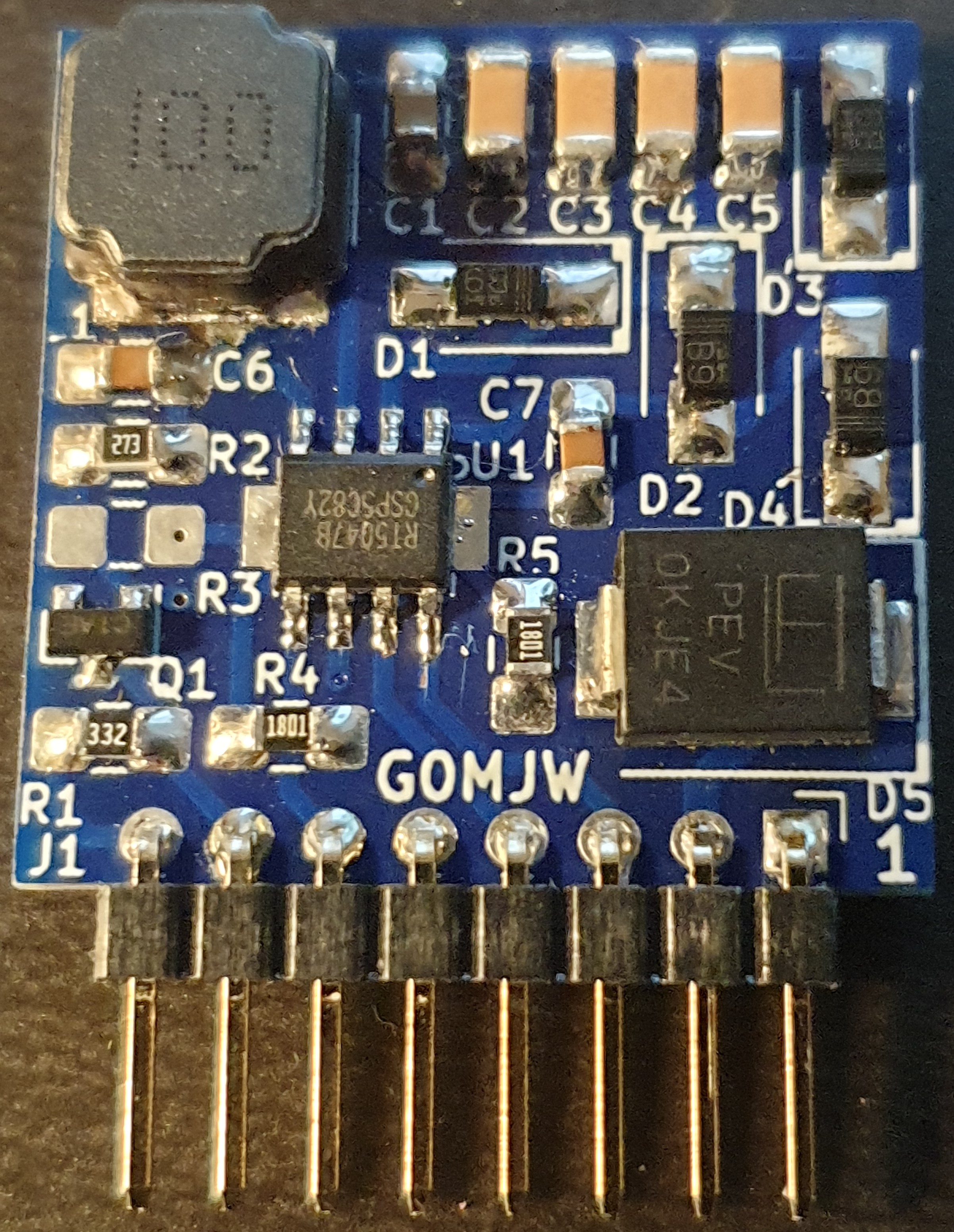

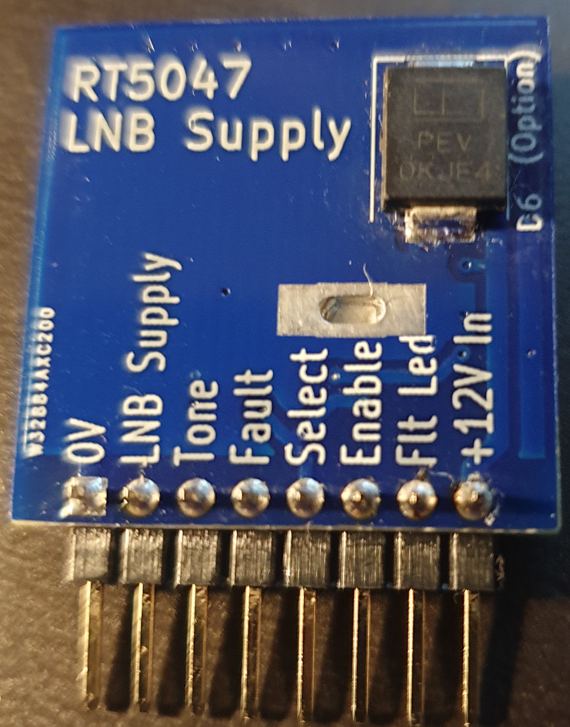

Over the Xmas break I finished my Winter Hill.
Only problem is I cannot get 18V out of the NIMS?
I have built two cards for the X and Y Generators but neither seem to be enabled .
The boards are both getting a supply but the enable pin is 0V.
Struggling to find where this comes from on the schematic.
The LNB Voltage being output from both boards is 5V.
When !2v is selected this is present on the NIM
What have I overlooked?
Hope someone can advise
Thanks in advance
73 and a Happy 2022
Nick G1BVI
Thanks in advance
73 and a Happy 2022
Nick G1BVI

Re: 18v for LNB
Hi Nick,
The LNB boards are controlled by the tuning commands that come from QO-100 QuickTune, or whpcrxcom, the PC program for sending tuning commands for any frequency.
When you enter the receiver parameters in QT, set the voltage for each receiver according to how your LNB is orientated. Normally, 18v would be used to select horizontal polarisation for QO-100.
It is also possible to set the LNB boards in the winterhill.ini file. You don't have to set them here and you still need to put the correct voltage in QT, but setting the LNB boards in winterhill.ini will allow WH to automatically calibrate the receiver frequencies using the QO-100 beacon.
Below is an extract from winterhill.ini. To enable the LNB boards, put a # at the start of the first block of commands and remove the # from the second block of commands and then reboot.
Are you familiar with Linux? You can edit the file as follows:
cd /home/pi/winterhill
nano winterhill.ini
DO THE CHANGES
CTRL-X then Y then ENTER to save
sudo reboot
You will need to use the whpcrxcom program (on the Wiki) to control the second LNB board, rather than QT.
COMMAND = [to@wh],rcv=1,freq=10491500,offset=9750000,srate=1500,fplug=A
COMMAND = [to@wh],rcv=3,freq=10491500,offset=9750000,srate=1500,fplug=A
COMMAND = 3 # a single digit causes a delay of that many seconds
COMMAND = [to@wh],rcv=2,freq=10499250,offset=9750000,srate=333,fplug=A
COMMAND = [to@wh],rcv=4,freq=10498750,offset=9750000,srate=333,fplug=A
#COMMAND = [to@wh],rcv=1,freq=10491500,offset=9750000,srate=1500,fplug=A,vgx=hi
#COMMAND = [to@wh],rcv=3,freq=10491500,offset=9750000,srate=1500,fplug=A,vgx=hi
#COMMAND = 3 # a single digit causes a delay of that many seconds
#COMMAND = [to@wh],rcv=2,freq=10499250,offset=9750000,srate=333,fplug=A,vgx=hi
#COMMAND = [to@wh],rcv=4,freq=10498750,offset=9750000,srate=333,fplug=A,vgx=hi

Re: 18v for LNB
Hi Brian
That makes sense'
I am going to have to change the ini file anyway as I have a non standard offset on my LNB to bring it out on 70cm.
I tried it and I get about 8 volts now.
The Inductor is also getting hot
I just noticed too that I have fitted R4 and R5 pull up resistors on my boards
It looks like there has been an update as these are fitted on the main board.
What voltage should I expect on the enable and select lines?
Thanks again
Nick
That makes sense'
Thanks again
Nick
Re: 18v for LNB
8v doesn't sound right. Is that the open circuit voltage?
R4 and R5 SHOULD be fitted on the LNB psu boards. These pull down resistors stop the enable and select lines floating when the PICs are reset.
Both LNB psu boards are controlled by PIC_A. ENABLE goes high to activate the LNB psu board and SELECT is low for 13v and high for 18v. Those signals should be at 3.3v levels.
