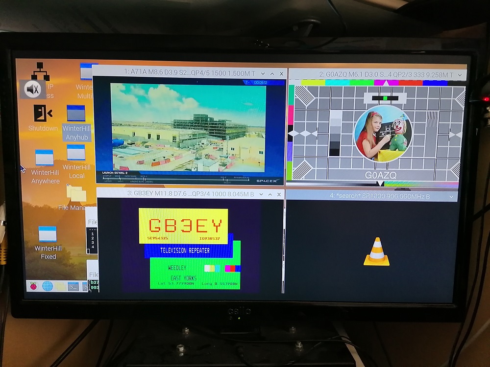

Hi Brian .... as requested ..
Can only assume that as EY is DVBS WH is saying NO !! Yes Offset 0. Start in Local.
Screen 2 is downloading sometimes OK when signal appears on 10499250 SR 333 although Ryde is a lot quicker.
Screen is saying "Search" "Header" with known signal present and sometimes decodes but have to click on Local to wake it up.
Have reloaded again with fresh SD card and same results.
Files won't copy. Photo too large and invalid extension but they look OK with no errors.
Graham M1ASR is building A WH, so will see if he gets similar results. Patience is a virtue !!

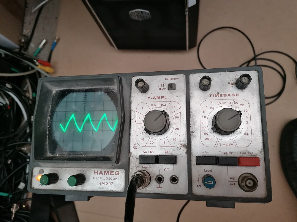

The GB3EY receive problem has been resolved. Tony found a sawtooth waveform on the 3.3v supply. Changing the 3.3v regulator module fixed it. Exactly why that caused only a receive problem above 1000MHz is unknown.
