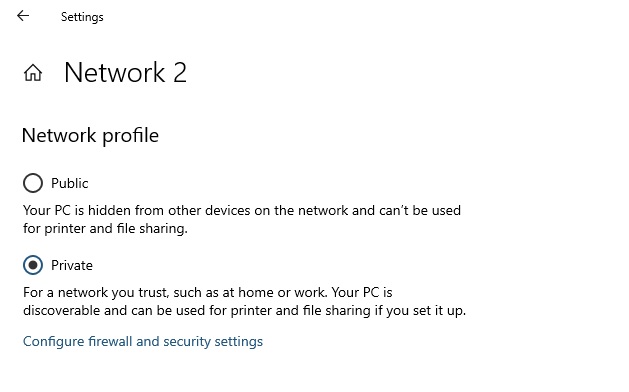

Just finished my Winterhill software setup and thought I would share a problem that I encountered.
Everything was working in Local mode but when I changed to Anyhub to use my main PC to view and control I couldn't get VLC to display anything even though the channel change and TS destination was correct and working.
To cut a long story short the problem was incorrect settings on my network.
Found the network profile was set to public and not private, this stopped the UDP stream from being received.
Everything works as it should now.
Just sharing in case someone else encounters the same issue.
- Network.jpg (35.25 KiB) Viewed 7067 times
Re: VLC on remote PC
I'm surprised you didn't get a firewall pop-up the first time you ran the PC Viewer. That looks like W10, so maybe it's different. I've used W7Pro64 for most of the development and testing.

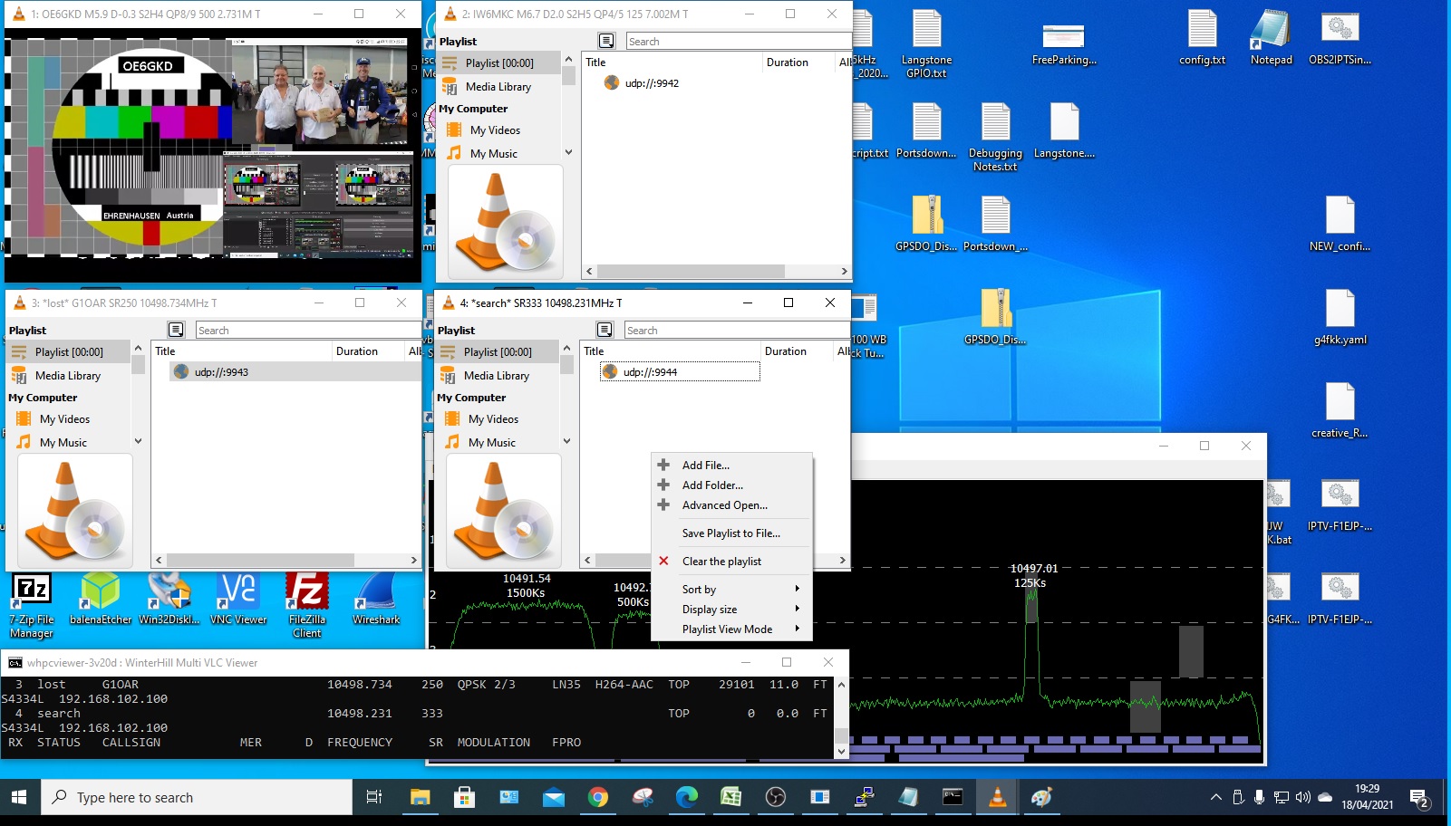

Hi Brian,
I've attached a picture of my desktop. If I right click any of the VLC windows I just get what you see on window 4.
When the pictures goes after a channel change, VLC shows what you see in the picture - er, if that makes sense?
All the best - Martin.

Which version of VLC is that?
Start a separate VLC and click HELP, ABOUT (top rightish)
I'm using 32 bit 3.0.12 on W7 at the moment. I'll check what's running on the W10 PC in the shack.
I haven't seen VLC screens like yours before.
I've just updated both my versions to 3.0.12 and getting the same results.
I've never seen VLC looking like that before either by the way. It looked like that when I first started whpcviewer
There was a Windoze 10 update a few days ago. Usually manages to screw something up
I'll do a power off restart after tea.
73, Martin
