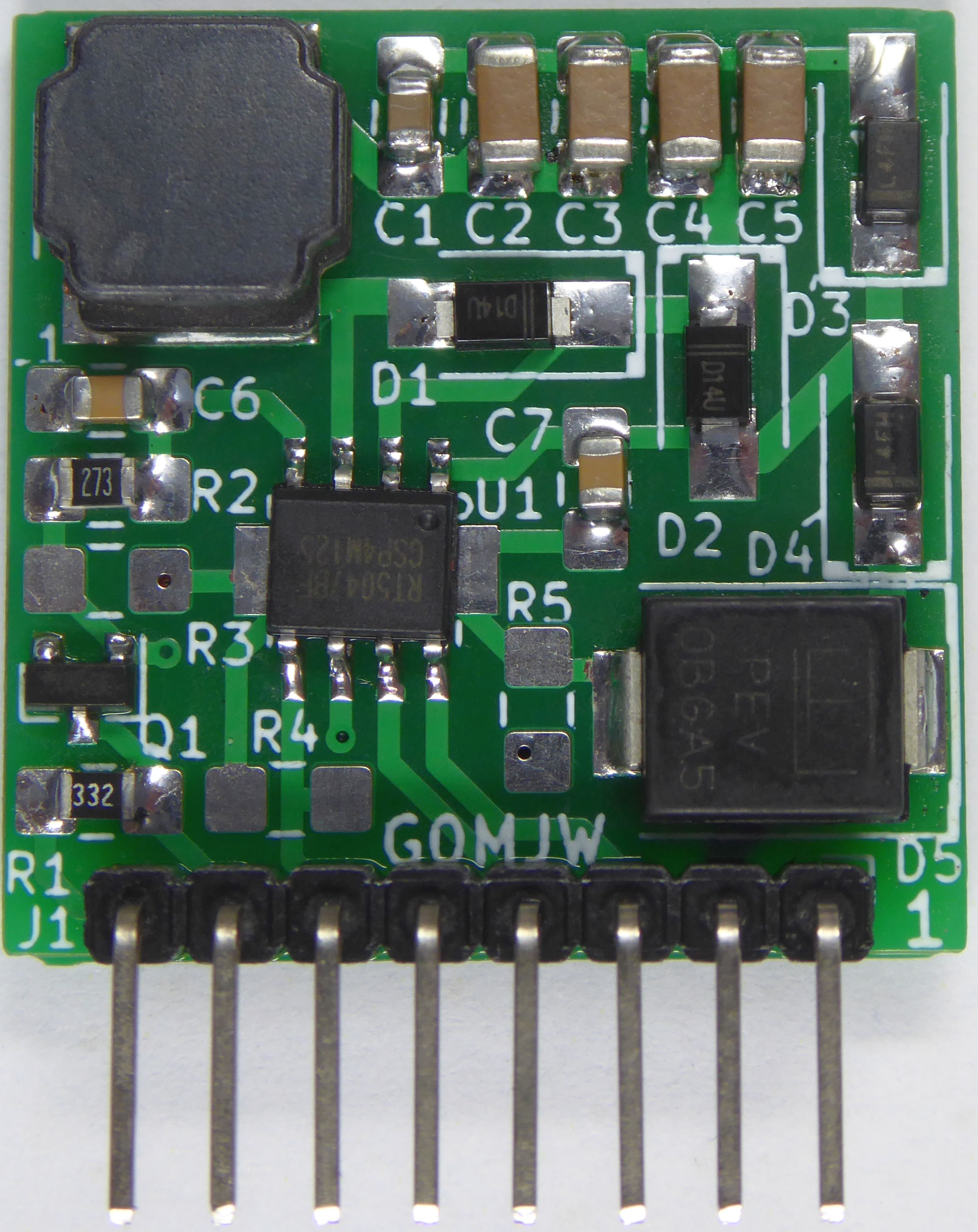

The U3 and U4 LNB PSU modules need to be constructed as part of the project. I believe that the PCBs are en route, together with another batch of the main PCB. Here's a photo from a development board that shows them. They fit into the sockets to the left of the PICs. There'll be a separate schematic and BOM for them.
The RT5047 board for the MiniTiouner isn't suitable for WinterHill.
Farnell have the RT5047A chips. There are several versions of RT5047.

It is a distinct project. I took the BOM parts off the main Winterhill BOM in the Wiki, they are still there but there in the spreadsheet but there no PCBs available yet, they are on their way from China. Meanwhile I have attached the BOM. Treat with great caution and if you find the correct Farnell parts add to the list for others.

I got mine from Farnell and Digikey on different occasions. The order codes are in the BOM file. RS don't appear stock them. I guess it's obvious but if you want to fit two modules, you are going to have to order twice as many of each part.
Also bear in mind the RT module is an order of magnitude more difficult to build as it uses an SMD IC that needs to have the tab underneath soldered and there are quite a few small parts close together. It's not very hard but not the best choice for your first attempt at surface mount. I would say about the time you start cursing through hole parts for forever having to turn the board over to solder them in and them dropping out, or not being straight, actually finding putting the SMD parts easier, that's when you are ready.
Here is one, not particularly well built. I didn't get the chip in straight.
R4 and R5 are pull down resistors and need to be fitted in the latest Winterhill PCB. Initially these resistors were on the main PCB but Brian realised that if we kept them on the module, he could detect in software if a module was plugged in or not, which might be useful in future.
