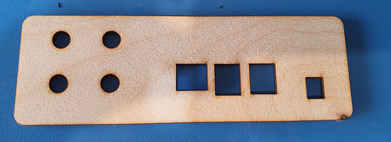

m1cdq
Posts: 115
Re: winterhill case?
Post by m1cdq » Thu Mar 25, 2021 11:51 am
just done a plywood test piece. I will be able to finalise the design once i have my own winterhill built
I will be able to do in acrylic for rear panel

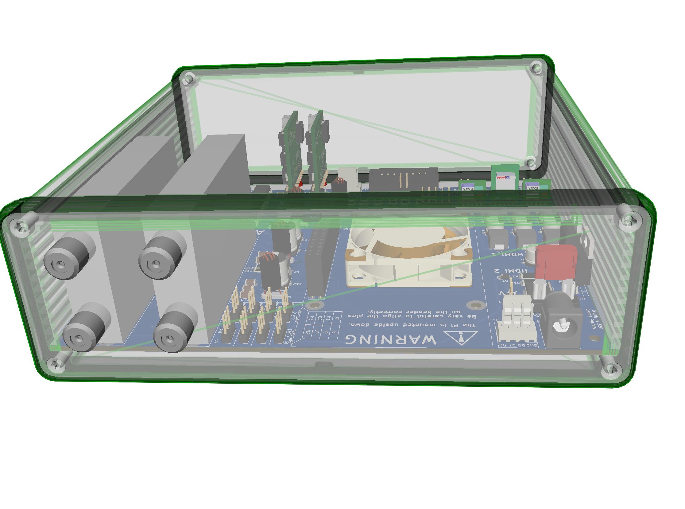

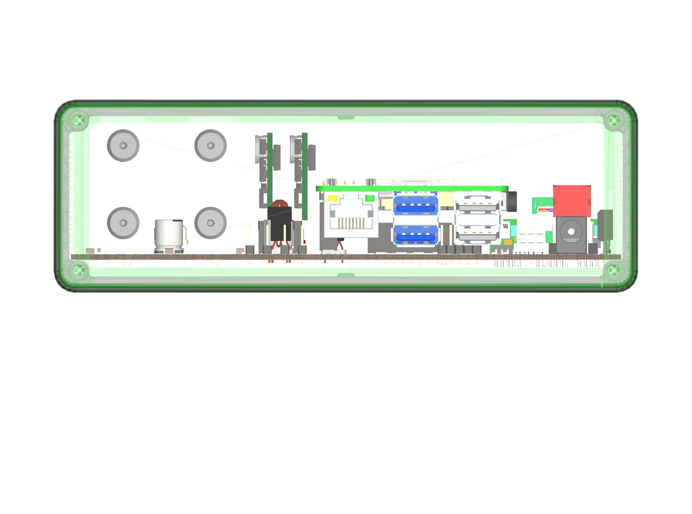

Posts: 2659
Post by g0mjw » Thu Mar 25, 2021 5:43 pm
All good points. I was going to say I had nothing to say on the QO100 net tonight but maybe I will show the one I built so people have an idea.
