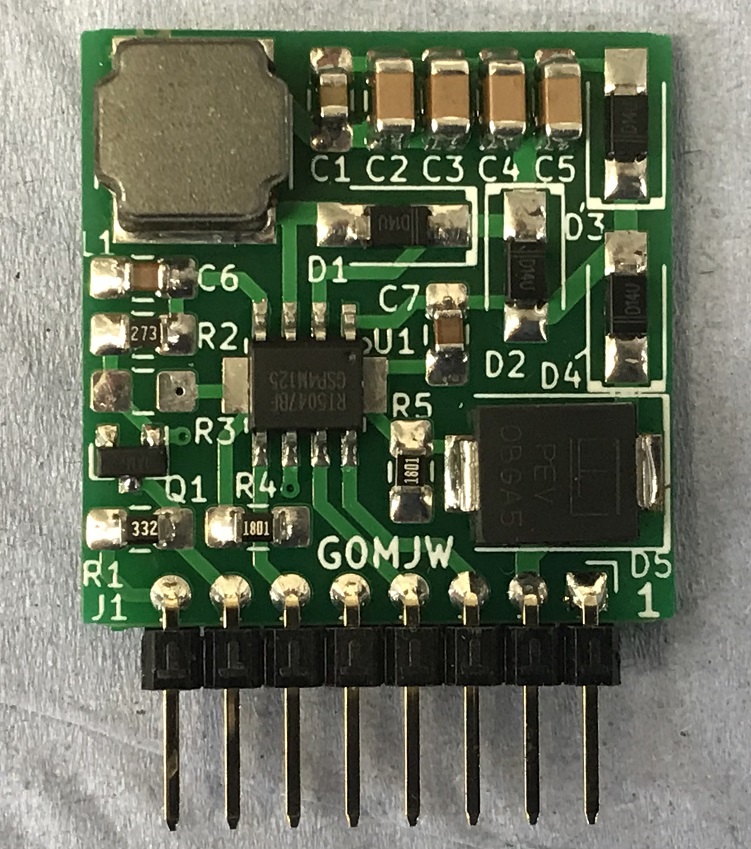

Post by G4KLB » Fri Apr 02, 2021 7:50 pm
Here's one I prepared earlier. (has the R4.R5 pull ups fitted as needed for the production main boards)

Post by G0LJF » Sun Apr 04, 2021 4:40 pm
Hi Mike,
I can confirm that those Farnell parts I selected all work fine.
I just tested it with a 30R resistor and it was able to supply 13V fine, and the 18V caused the short circuit overload LED to flash, as was expected.
So that's 433 mA on 13 V OK, and 600 mA on 18 V, overload condition.
I used a 68 R to check the 18 V and that was delivering 264 mA and working fine. The RT chip was not getting warm.
One thing, I could not get the 10 uH SMD inductor (on back order) so I used this leaded part from CPC PW00009.
Fit it horizontally on the board as it sticks out of the back of the main WH PCB - and there is currently nothing there to foul if you use the selected case.
Lastly, if you only have only one RT board, fit this in the U4 slot and not U3 as I did. Otherwise it cannot be controlled from Quick Tune.
I think this is important to note.
I am going to fit the second RT board when I receive it from BATC shop.
And finally, I soldered the lot in one operation (well 30 seconds) using 'proper' Lead alloy solder paste (CPC SD02698) and my hot air gun. I used a domestic electric cooker hot plate pre heated to 150 C for ten minutes, to stabilise, to pre-heat the assembled PCB first. The components on the reverse side I soldered by hand.
Update: My second RT board is now completed, installed, and tested. Solder paste makes it easy, maybe a bit off square but works FB.
