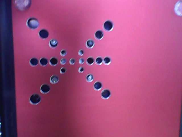

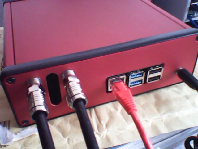

Here is my case
I recommend the Labgear F types (Screwfix) but you need a compression tool - I originally made my own from a slotted pipe, but the tool is best.
and ventilation holes

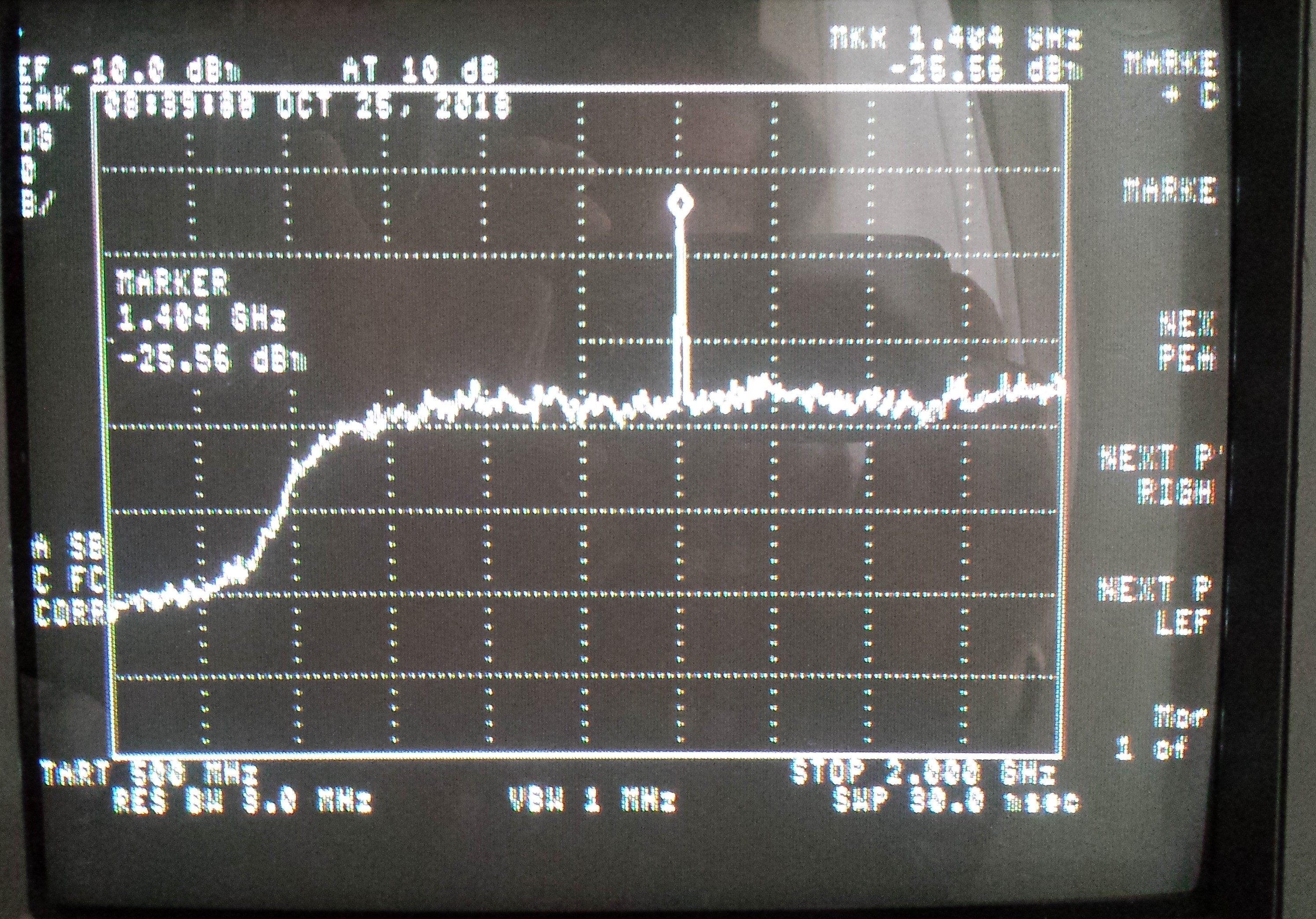

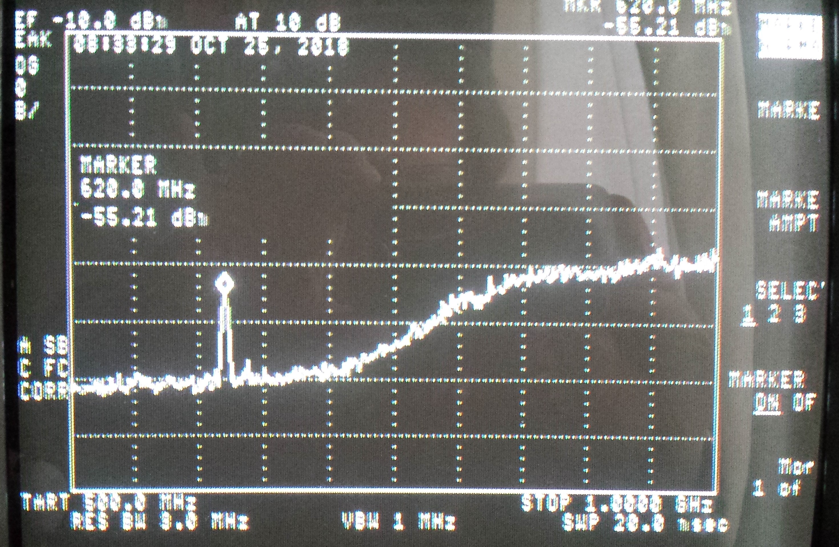

In reply to Brian, G4EWJ, on performance of modified vs unmodified Octagon LNBs.
Early on, I performed a test with an LNB using a 10GHz input signal to see what the IF output looked like. The LNB used was a PLL Octagon with a 27MHz crystal, generating 9750MHz as the LO. To me, it seemed that there was a significant gain loss (possibly 20-30dB) when the output signal appeared to be much below what looked like the lower cut-off point of the IF filter/amp. Why this HPF effect exists, I am not sure, but one reason could be the DC decoupling choke in the LNB and its decoupling capacitor forming a HPF for the IF.
Hence in this case, for an unmodified LNB (LO 9750MHz), input signals in the 10500MHz (or 10368MHz) range will suffer an LNB gain loss, which will have a direct influence on the effective noise temperature of the system and G/T which in turn will affect the C/No at the demodulator. The LNB or LNA gain is usually kept high so that down-stream noise makes little contribution to the overall system noise, but if this reduces then the tuner noise figure (10-12dB in this case) and cable losses between LNB and tuner become significant. Rough calculations show a 2-3 dB loss of C/No can result for an unmodified vs modified LNB.
Just to say that I use a similar mod. to you but change the crystal to 26MHz, locking if necessary, giving an LO of 9388MHz. In this way the output is in the normal IF range (950 to 2150MHz) for QO-100 input signals. I have modified 4 LNBs in this way and my 1.2m PF antenna gives MER 10.7dB on the beacon (it hasn't had its pointing optimised in a long time).
A way to compensate for LNB gain reduction, would be to add a low noise amp directly after the LNB to makeup for any gain loss.
Attached are a couple of spectrum analyser photos of my non-to-scientific test results at the time.
73 all
Jen G4HIZ

Hi Brian,
There are many colours, Black being one I never knew about - you could then receive Es'hail2 in total darkness!
Three case tips I have are
a) I used a pair of dividers to transfer the PCB component offsets from the PCB in-the-case to the front panel.
b) I had some Red nail vanish here (its for my motorbike tail light) so you can eliminate the glare from the exposed aluminium cuts-out sides using that.
c) Measure at least twice before you cut and use tape to protect the nice coloured anodized finish.

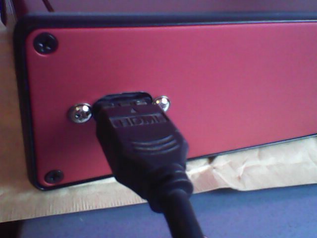

HDMI:
I have added a female full-sized HDMI socket to the rear panel on my case so I can use my WH stand alone.
Or for anything else requiring no added PC control, just a monitor and mouse and KB onto the Pi.
Or anything else you may require.
The tricky bit is the sharp right angle bend in the cable coming from the RPi Micro HDMI. This connector is right next to the inside of the case.
I bought a Micro HD-MI Male to HD-MI Female Extension Cable with Screw Panel Mount from Ali Ex then carefully cut back the stain relief that was moulded as part of the Micro end plug.
https://www.aliexpress.com/item/4001128 ... 5cb2alLZI5
It works, but it is tight. Takes some care in bending the cable so there is no residual strain on the Pi then offer it all up.

Re: winterhill case?
That's the front panel.
I used a 90 degree micro HDMI cable, fits nicely, with a panel mount HDMI adapter. Don't try to use a straight one as it probably won't fit.
