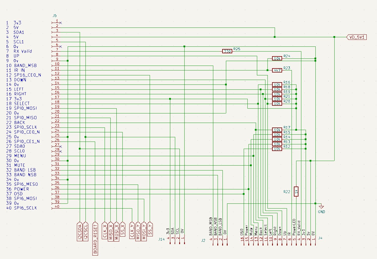

Post by G4EWJ » Sun Apr 30, 2023 12:29 pm
It looks like J4:4 (RX Valid) on the Ryde header, through R25, 330R.

Post by M0DQW » Mon May 01, 2023 10:07 am
Thanks Brian! That works a treat.
Matt
Posts: 2735
Re: Winterhill with Node Red
Post by g0mjw » Mon May 01, 2023 11:01 am
for reference:
Edit - I accidentally uploaded the not geo renumbered version.
Screenshot 2023-05-01 173638.jpg (242.48 KiB) Viewed 10932 times
