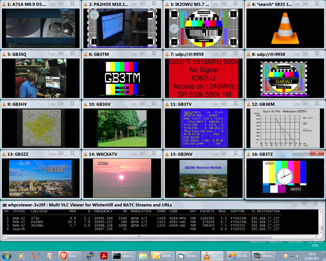

I'm working on a 16 screen version of the viewer at the moment that also shows BATC rtmp streams, so I'll see if I can detect a VLC window terminating and restart it.

A 16 screen version will be interesting! Will it be able to cope with two Winter Hills?

Yes, G0MJW and G4KLB have been using it with their 2 WinterHills. I haven't built my second one yet. You can also feed in MiniTiouner and other streams.
