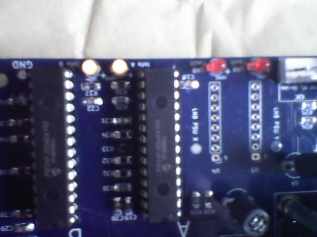

Right, This is all when locked onto the beacon (and PI no longer responding).

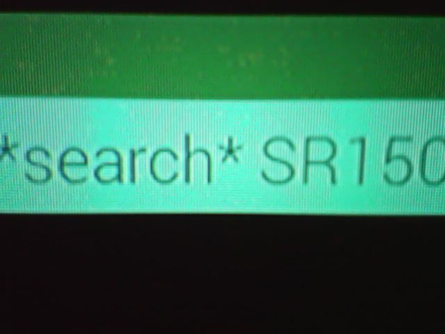

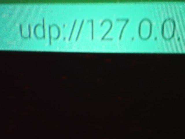

In lock-up mode, the Info A LED flashes whilst "receiving". VLC RX1 bar changed from "scanning" to an IP address.

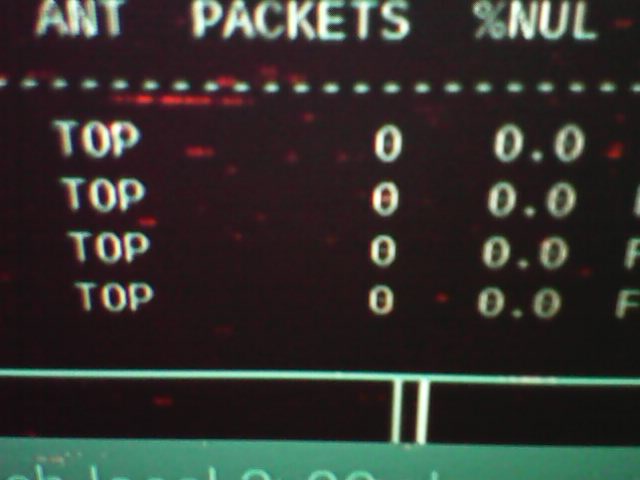

No packets are then shown as incrementing in the terminal window. All zero.
After a remote WH shutdown the PI chrome browser shows the default raspberry pi web site OK.

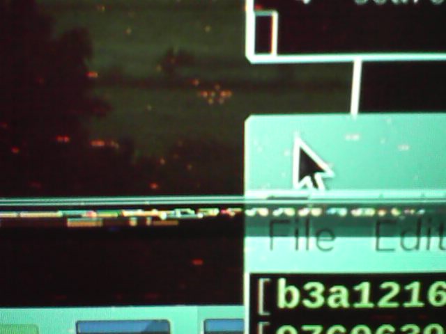

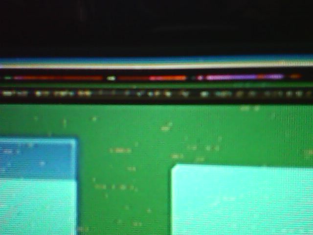

Here are shots of the colour bar (550 and 549). The others show how the VLC title bar changed from search to an IP AT LOCK-UP.
And the Rx packet count stops at zero.
The PIC A LED does flash however after the lock-up.
anything else?

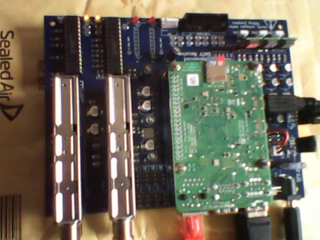

Any way to tell? Its a 4 GB PI4, I bought it about six months back then put Portsdown 4 on it (just the SW), never used it as I have P2020.
my board

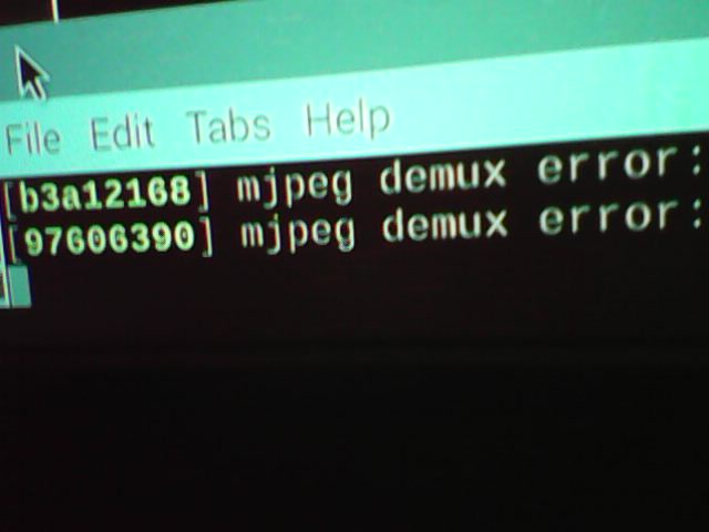

Oh I did see this error message too... on the PI terminal

That's the same as the one I used for the first prototype. I used the cheaper 2 Gb for the second one. I assume the voltage is OK and not dropping. Could you have a wiring fault perhaps? Very odd. Try a different monitor maybe?
Posts: 2738
Re: Install Problem
Post by g0mjw » Fri Apr 02, 2021 6:11 pm
I just realised I never tested it with a 4k monitor. Maybe that's the problem, assuming you are using a 4k monitor. I tested with a full HD monitor. Bad HDMI cables can create stange issues. I use mine exclusively in hub mode as I don't want another monitor and keyboard to deal with. It has run for months without crashing.

G0LJF
Posts: 106
Re: Install Problem
Post by G0LJF » Fri Apr 02, 2021 6:20 pm
Well I put my scope on all the supply voltages as that was the first thing I thought of as it looks like a noisy PSU.
But to re emphasise the problem is repeatable and only occurs the instant the WH acquires the beacon.
I had assumed it was due to my BiasT in some way so I had the scope on that too - all clear.
The only noise is very narrow impulse spikes are on the 1V1 about a few hundred mV. At 1.67 ms apart.
I am only a one TV house here - I do have PC monitors. I suppose I could try this one (I am looking at it now, but I guess you can't see it at your end).
I think that does HDMI.... worth a try.
Can you disconnect the LNB feed from NIM_A and NIM_B in turn and reboot and see if the problem varies if only PIC_A or PIC_B is in use. Change the LNB jumper matrix as required if you're using the on-board voltage generator.
I did try RX1 and then swapped to RX3 - same instant PI death as soon as the beacon is acquired.
BTW I am NOT using any jumpers or voltage supplies as my LNB is self powered off the bias T.

Have a look at the 3.3v waveforms on PIC pins 16,17,21,22. Possibly no activity on 21. If the PIC LEDs are flashing, then SPI data is being transferred, but is probably corrupted as the packet count doesn't increase.
