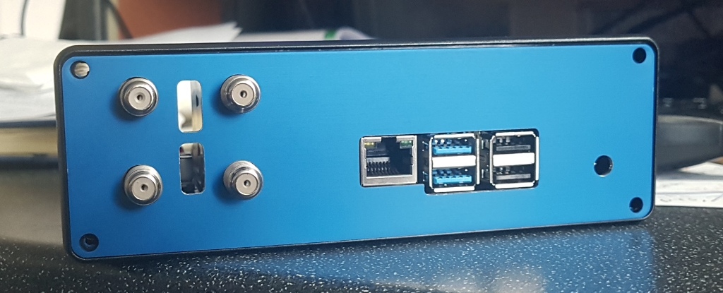

Here's my version of the back panel cutout.
Here's the dxf file for it, reference bottom left corner.
https://www.dropbox.com/s/dv7l48p0b541n ... l.dxf?dl=1
*** note this is with the PI flush up to the 16.6mm 40-pin header which is fully seated onto the board ***
I guess i need to mill a nice hole in the bottom for the fan intake next...

That is a very neat job Rob. You must have a mill, or extreme patience! You need a suitably artistically designed vent under the fan. I look forward to what you come up with. BATC logo? Raspberry Pi logo?

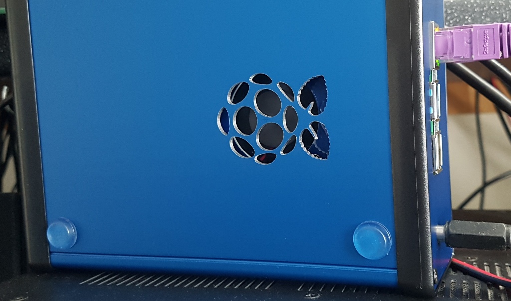

Post by M0DTS » Thu Apr 01, 2021 1:45 pm
Just for Mike,
I had a go, not too bad result.
The mill is a bit slow for 1.5mm cutter but it worked.
Posts: 2610
Re: winterhill case?
Post by g0mjw » Thu Apr 01, 2021 2:26 pm
Beautiful. You realise you are going to have to use it upside down from now on in order to appreciate that.
