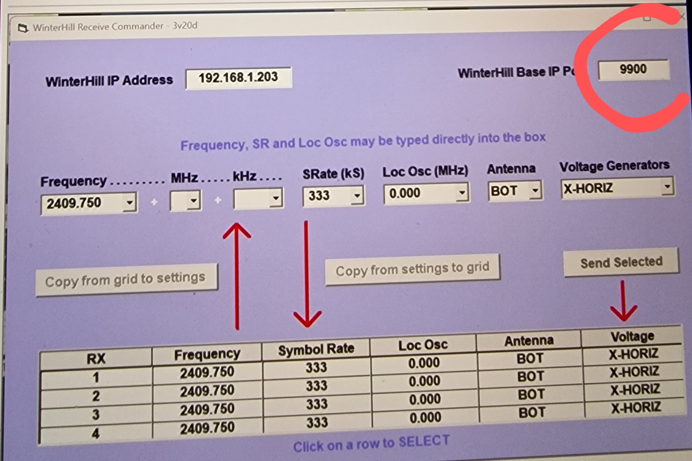

Is there away to change the WinterHill Base IP Port address, if using for address 9904 it just resets back to 9900, can this be changed?
G6HFS
Posts: 1527
Re: WinterHill Commander - 3v20d
Post by G4EWJ » Wed Sep 06, 2023 11:56 am
Are you running two WH's, or just experimenting? The base IP port in whpcrxcom has to be xx00.

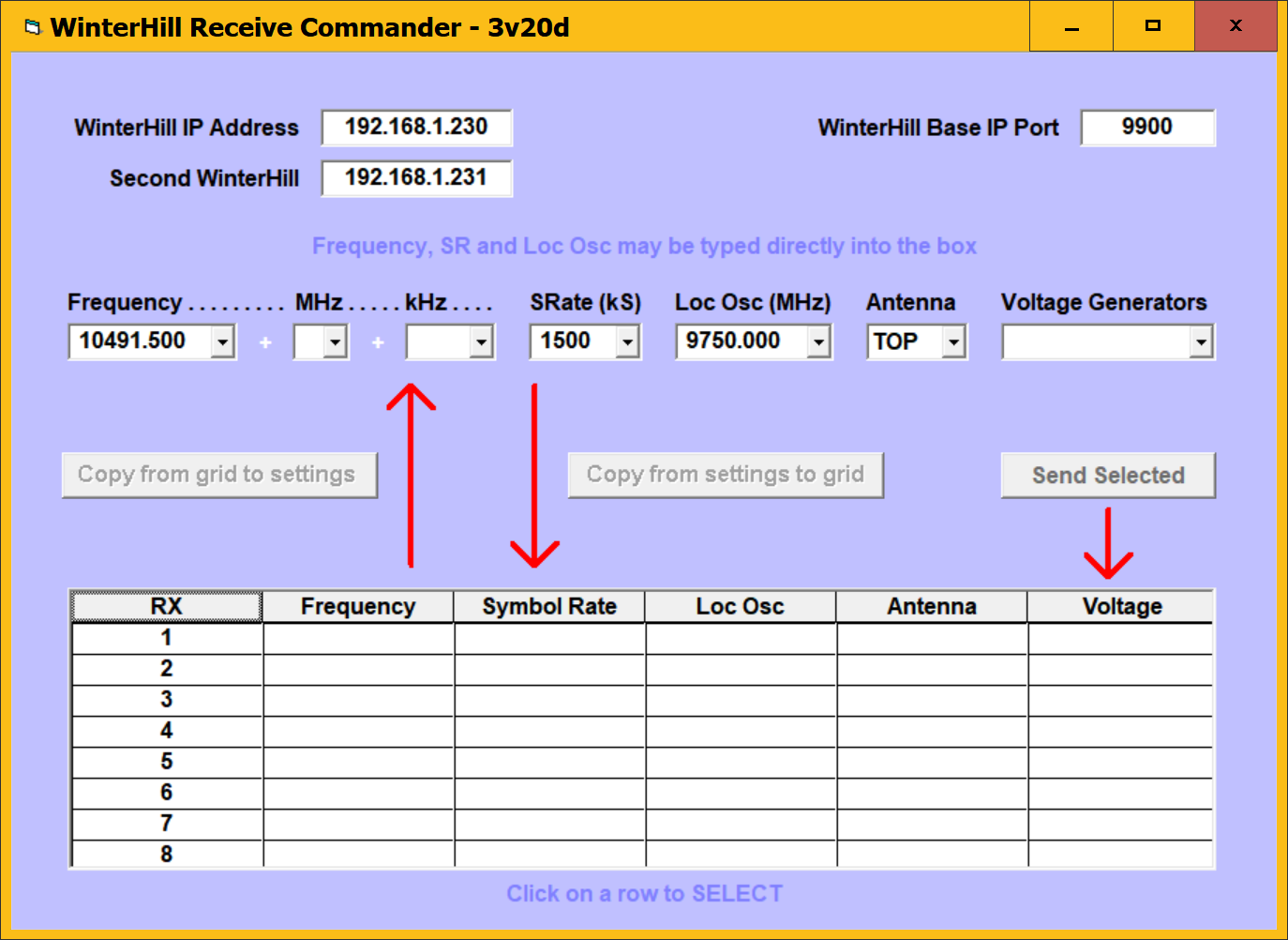

There's an undocumented feature which expands whpcrxcom to 8 receivers. It hasn't had much testing, so expect the unexpected.
Type CTRL-R
Receivers 1-4 go to a WH on the first IP address, which has been set to use base IP port 9900.
Receivers 5-8 go to a WH on the second IP address, which has been set to use base IP port 9904

Hi Brian
Thankyou for your reply and yes, have a second WH to test

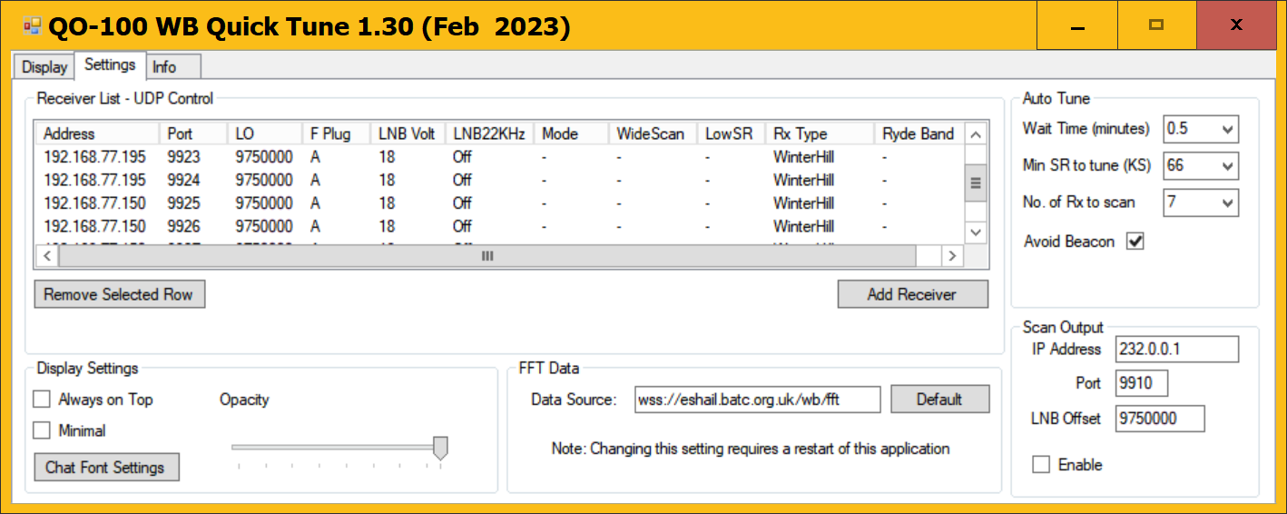

All works on WH’s, is there away to make QO-100 WB Quick Tune do the same.
G6HFS
Posts: 1527
Post by G4EWJ » Thu Sep 07, 2023 11:50 am
Yes, you set up QT for 8 receivers, something like this.
g6hfs
Posts: 338
Post by g6hfs » Thu Sep 07, 2023 12:30 pm
Brian,
Again many thanks for your reply all working great.
