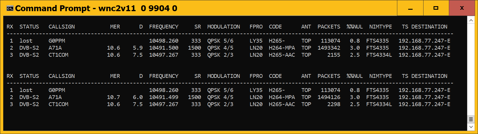

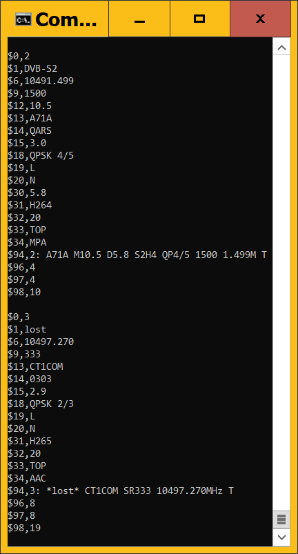

There are UDP textual data feeds on ports 9903 and 9904.
9903 shows a list of parameters for each receiver. You only get data for a particular receiver when the TS is being sent to that PC. $0 gives the receiver number. For the status number definitions, have a look at main.h in ~/winterhill/whsource-3v20/whmain-3v20
You could also look at the 4 line status display on port 9904. This gives the status of all receivers, as long as at least one of the TS is being sent to that PC.
