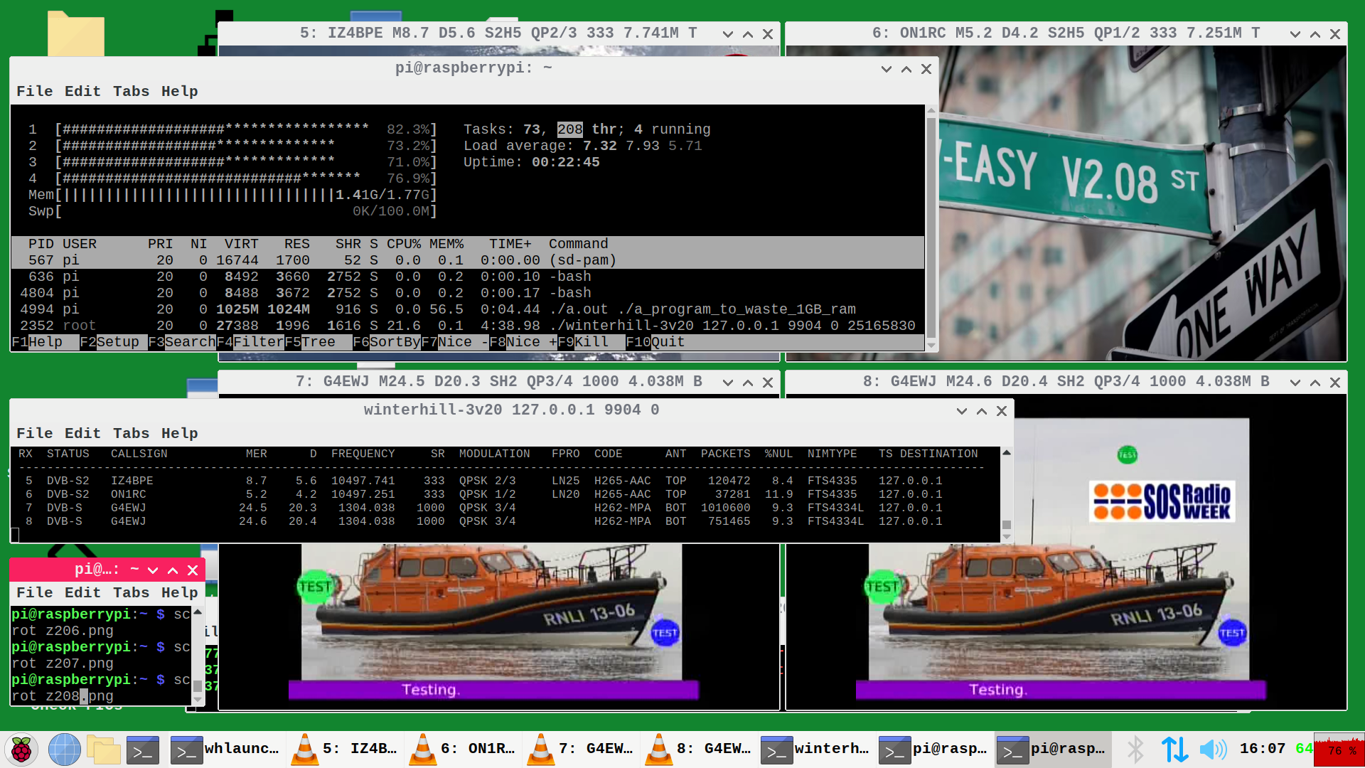

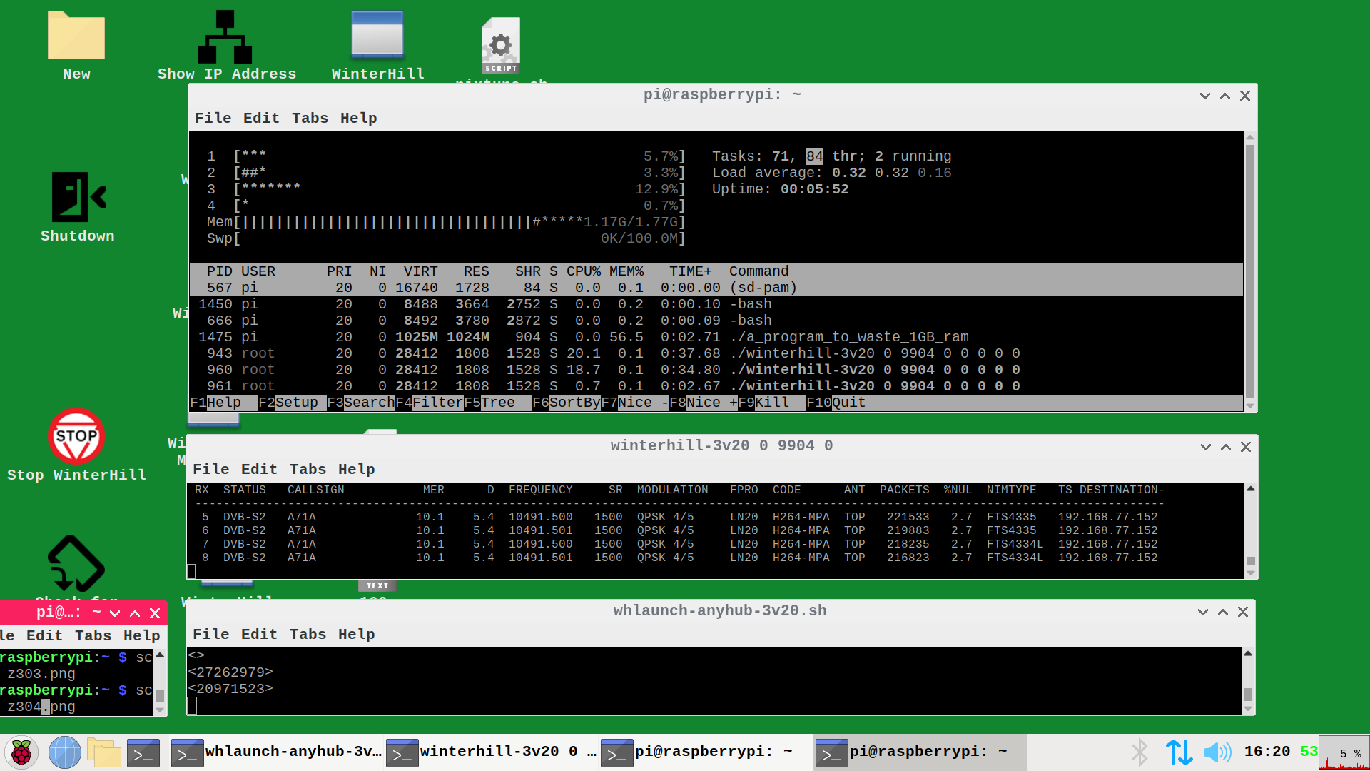

A question was asked at CAT22 earlier about the ram requirements for WinterHill.
I have only a 2GB RPi4, so I wrote a small program to waste 1GB of ram, to simulate a 1GB model. It looks like a 1GB RPi4 will be fine for WinterHill. When displaying on the RPi4, the amount of ram used may increase for higher video resolutions, but then it will probably also have cpu resource problems. Perhaps someone could try it.

AnyHub mode streaming 4 beacons. No local display on the RPi4. 600MB ram free.
Local mode. 360MB ram free.
