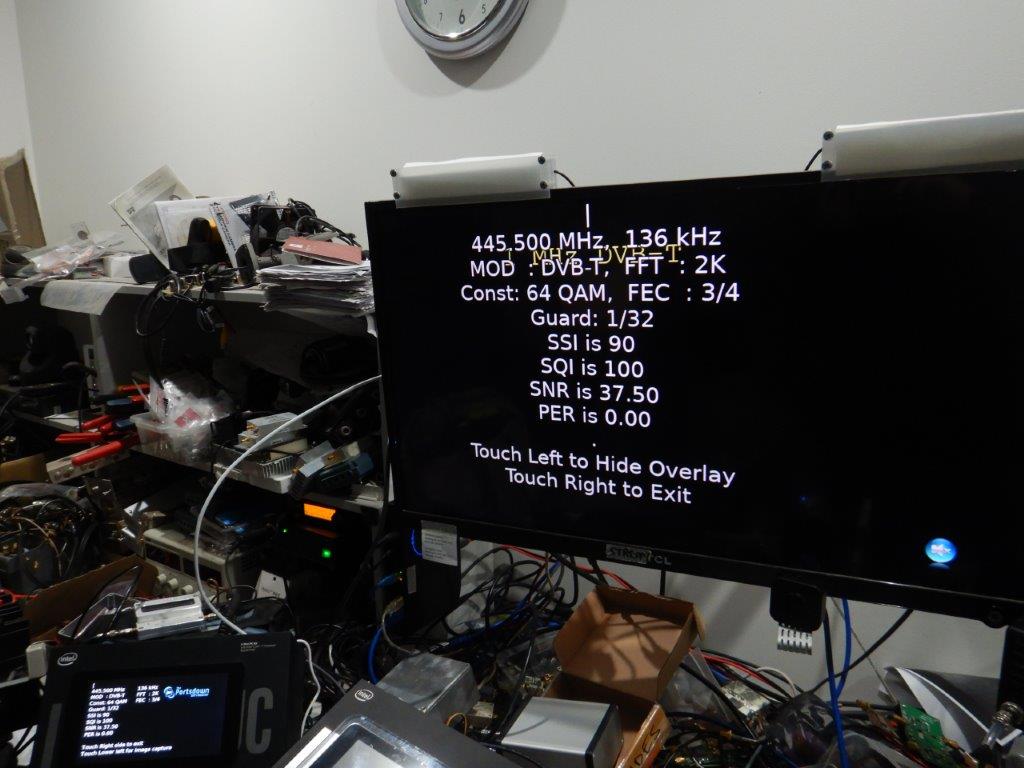

Realising I needed 2 Portsdowns now... Tx and Rx, I panicked and reached for the old HiDes dongle, it was second rate, but worked for a test
Looking for options I threw together a second Portsdown and sent some signals across the bench with a Pluto, not bad, got to 250khz

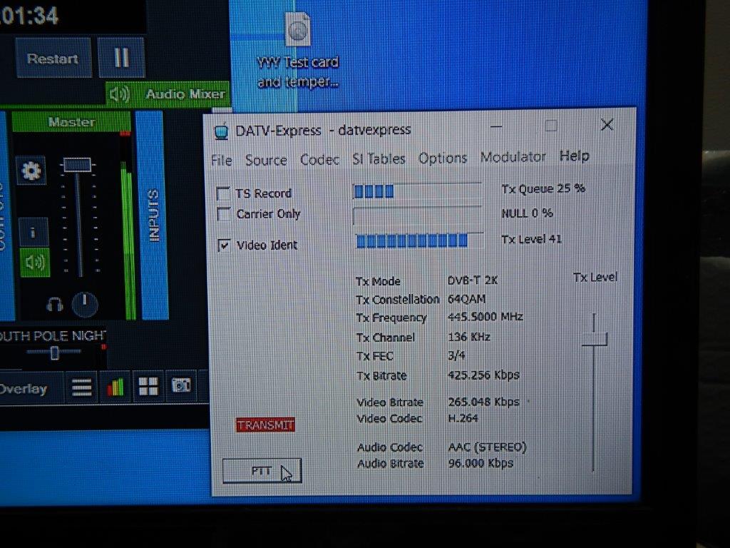

Tried Lime Mini and Charles's DATV express latest version tonight on the bench, my jaw dropped at 136khz, Lime is cleaner than Pluto
Well done Charles, that's the best experience with DATV express ever, this little Knucker thing has my undivided attention
There is likely others who've contributed too, you've all done a fantastic job chaps
Now to get out on 6 metres and make a contact, does anyone know what the distance limitation is yet?
The guard interval and the propagation Gods will dictate that I guess

136khz Rx Woo Hoo!
136khz Rx Woo Hoo!
136khz Tx DATV Gold
136khz Tx DATV Gold
