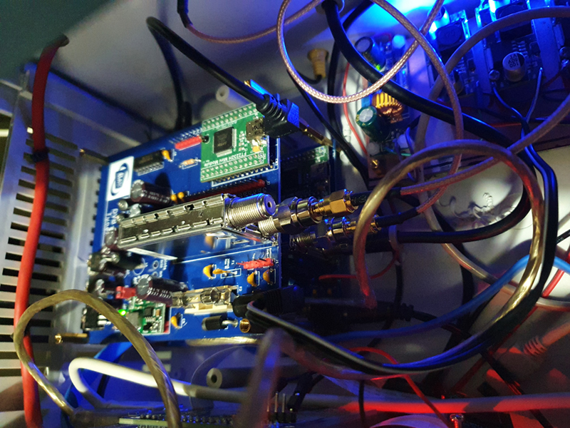

I've got my system built. the knucker nim arrived today. and fitted in to my portsdown4.
Now I know to switch between the minitioune and the knucker. i have to unplug one from usb and plug in the other and reboot
Will portsdown be updated to handle both at same time. As I'm looking at options at switching. poss a 2 position 4pole switch on the front panel to change between the 2. Cut and solder 2 usb leads but that may induce noise into the usb connection
As i have them stacked in my case

That's not a standard build so not supported, but it might be at some point as the Ryde has the capability. In the meanwhile you can get switched USB hubs where you can turn ports on and off. Perhaps that's a solution. No need to mess about with wafer switches.

I've a raspberry pi 4 and a lime-sdr plus mini-tioune batc board. Now they have released the knucker.
I've a standard build in a big case plus the newly released knucker up and running( sat watching BBC on it ). All I have left to fit is the pluto
then its around to building my PA's
For the time being I'm going switchable USB. just ordered off amazon arrives tomorrow. will do a small mod to bring 2 of the switches off the board on to the front panel. and use a suitable change over switch. i will update on how this goes so any others that are interested can do the same
