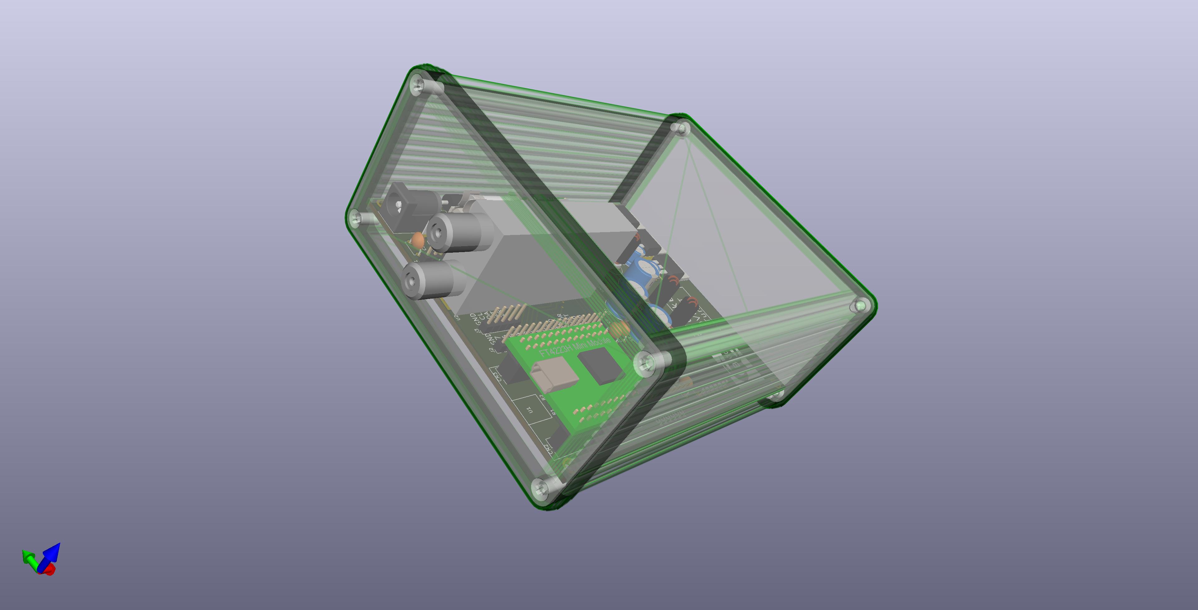

What is the Hammond box reference that fits for the Knucker PCB ? (What dimension for Knucker PCB ?)

It is exactly the same size at the BATC Minitiouner - Hammond 1455 series 103x120x53mm. The board is a little smaller 100x120mm and the tuner is not quite as tall so if it will fit in the new models isn't known.
