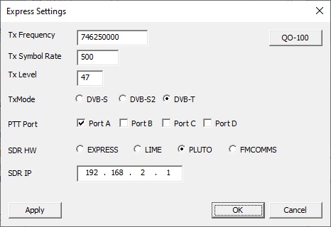

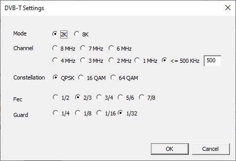

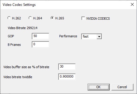

Ok, Knucker built and appears to be working. The next thing I need is a reliable method of generating DVB-T. I've got the latest DATVExpress (v.17), which refuses to generate 333kHz on the Pluto. It will generate 500kHz and 1000, but the displayed result locks up every few seconds. I've not tried any "Video Bitrate Twiddling" yet or had a look at the Pluto's output on the spectrum analyser either. I think the Pluto is something Charles is working on so not going to panic just yet :)

Pluto with Evariste 2711 loaded

For use with the C920, try setting H264 encoding, use “864 480 24 YUY2” and mono (MPA) audio encoding.
Charles has passed me the code for DVB-T transmission from the Portsdown. I have it running here using a Pluto, but it needs some changes to the Portsdown before I can release it. Only a few days at the most.
The Portsdown should eventually also work with Lime and DATV Express cards, but that's a lot of integration and testing, so I'm trying to get the Pluto performance to be rock solid first.
