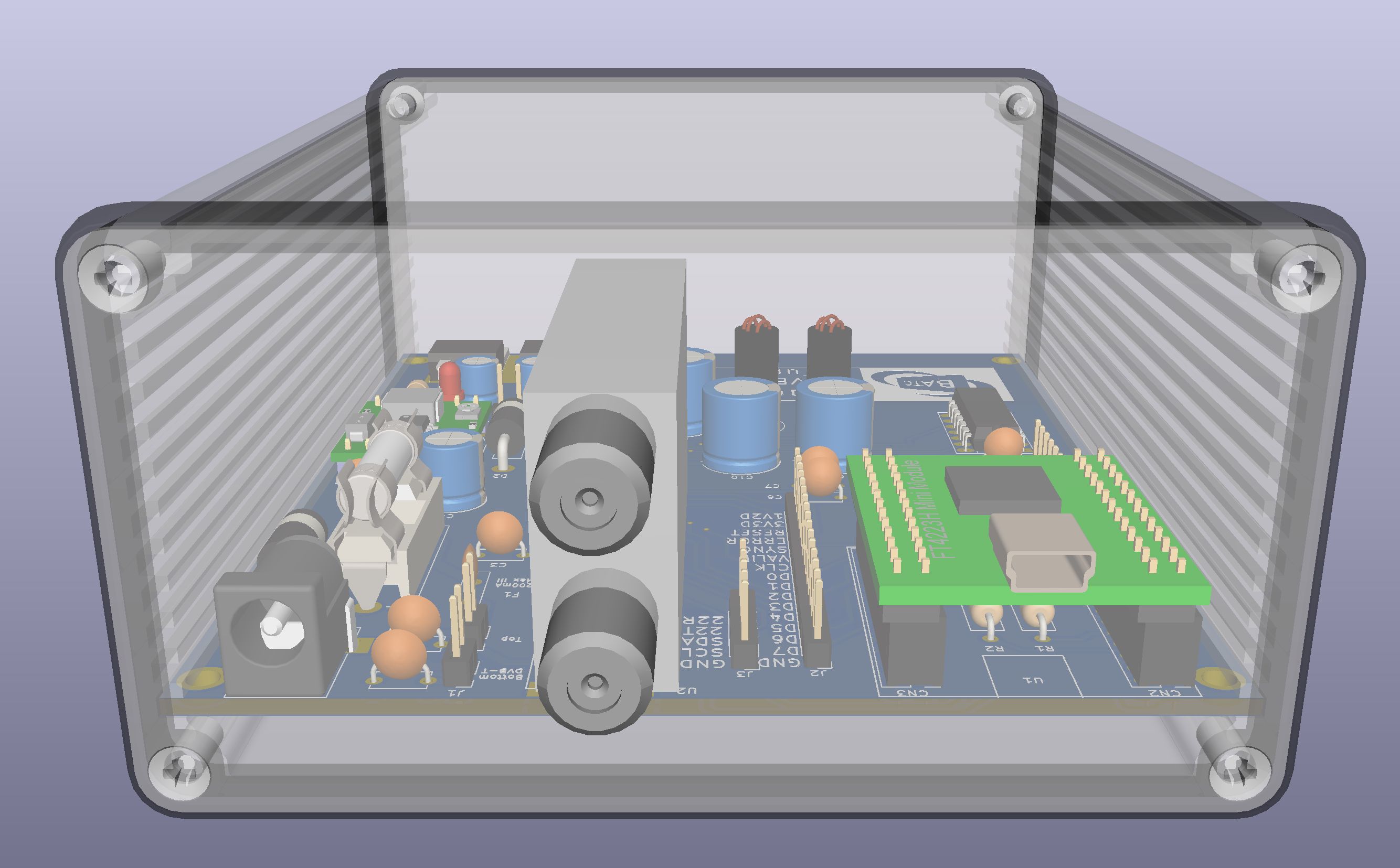

The STL file might be useful to many too. I mounted mine on the lowest shelf in the Hammond box, largely because that's where it was for the V2. The difference is the height of this tuner module is much less so it will fit. If you go on the Hammond website you can download a 3D CAD file of the box, that's what I have been using to check fitting as you can create a component in KiCAD with the VRML file like this.
Then fly through it (if you make it transparent) to see if things foul against the case etc.

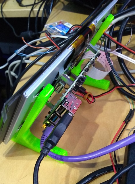

With a strong likelihood of additional touch-screens and RPi4's being pressed into service (RX/TX pair doing DVB-T) I designed a couple of stability feet to help prevent interim damage to the screen and RPi.
Qty 4 12mm M3 secure it onto the back of the screen and there are two small recesses in the bottom of each foot for 10mm diameter sticky feet to stop it sliding.
The system won't let me upload .stl files so message me g4xat AT ntlworld.com if you want a copy.

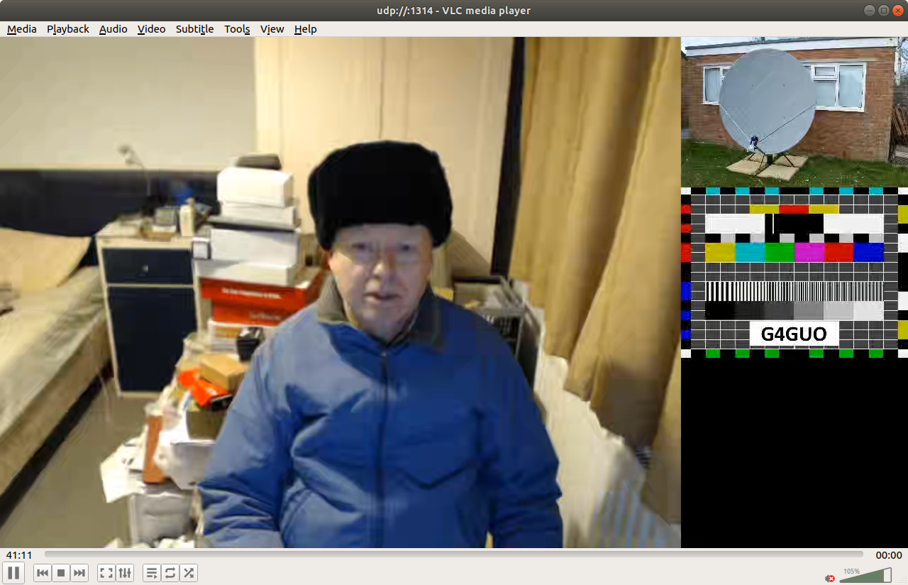

FWIW
(on PC) C920/OBS/RTMP stream (H264 + AAC via ethernet LAN)->
(on Jetson NANO) RTMP server/FFMPEG(h264_nvmpi) to (hevc_nvmpi)/DVB-T/LIME (437 MHz free space (500 KHz BW FEC 7/8 QPSK)) ->
(on PC) KNUCKER/VLC (500 KHz BW FEC 7/8 QPSK).
Nano is running hard on all 4 cylinders. The DVB-T TX stack is identical to the one being used on Portsdown.
Thanks to John's (G7JTT) thread on how to set up the RTMP server
Screenshot from 2021-01-19 16-48-56.png (798.49 KiB) Viewed 13801 times
- Charles

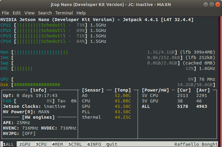

G4GUO
Posts: 736
Re: Knucker beta testing feedback
Post by G4GUO » Tue Jan 19, 2021 6:35 pm
It is in my shed so the ambient is about 8C but the box has no fan.
