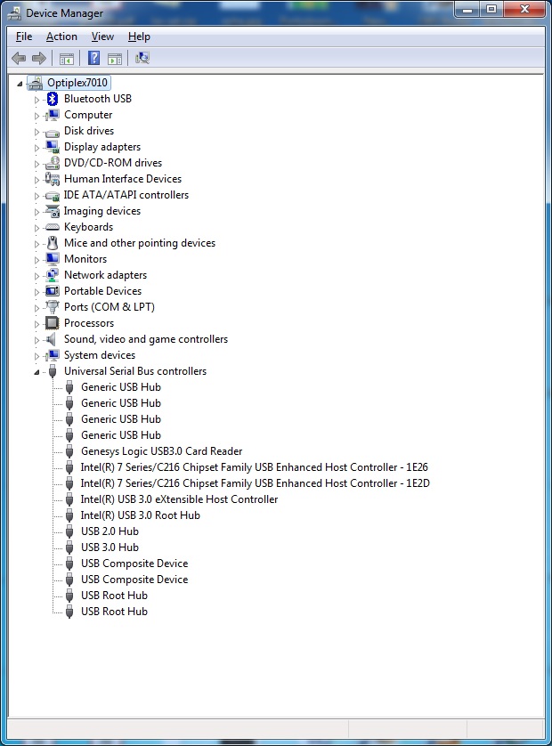

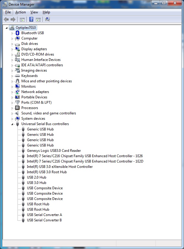

h) Plug in USB. Windows 7.
i) Iq drops to about 22mA, and two new "USB Controllers" Appear in Device Manager, "USB Serial Converter A" and "USB Serial Converter B".

Your Windows PC seems to be successfully talking to the FTDI USB module on the Knucker PCB, but that is all it will ever do, as there is no Windows software for the Knucker.
