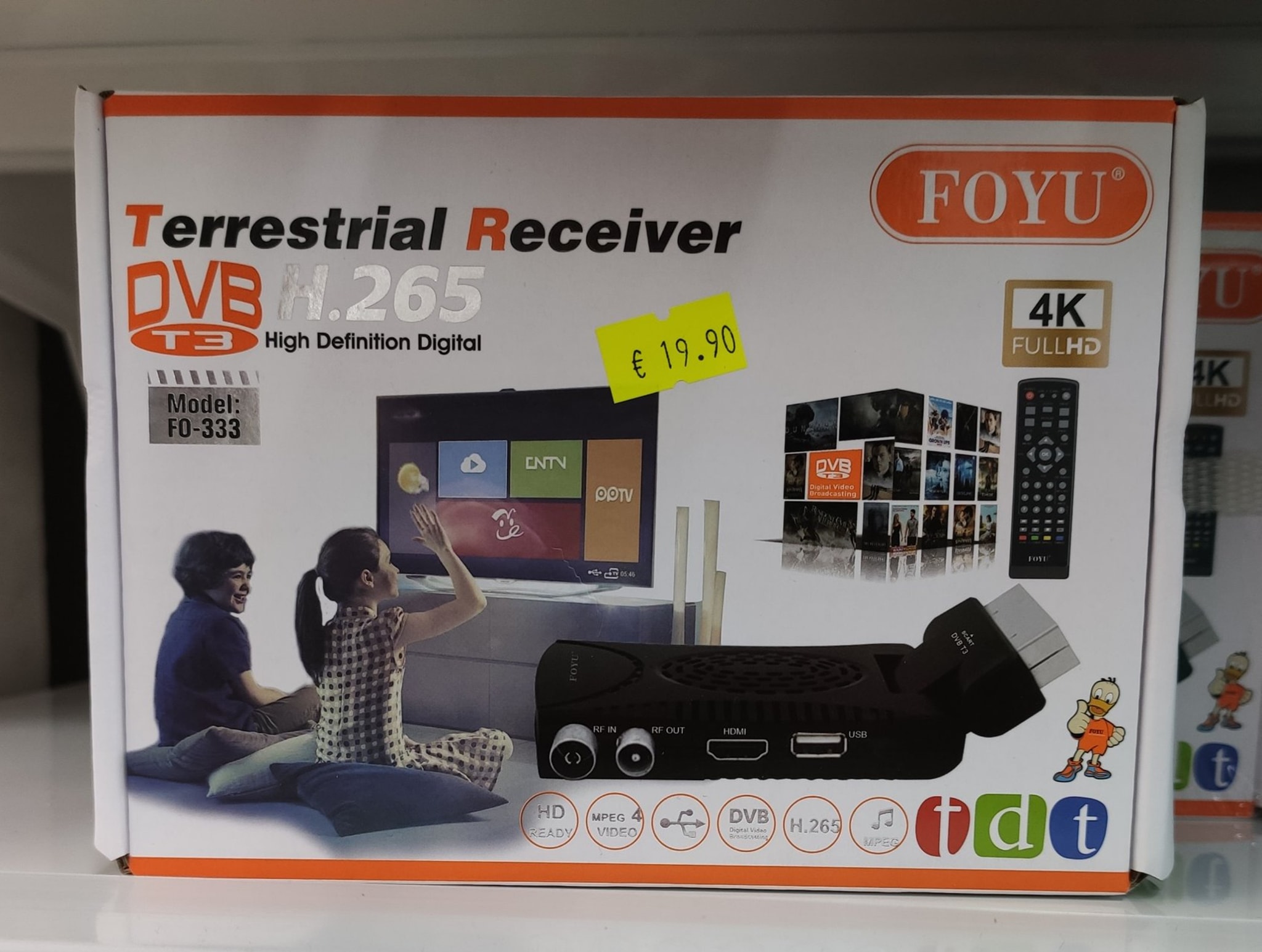

sorry, forgive me...but I could not resist...
is the Knucker ready for DVB-T3???

About DVB-T3,the Chiness are really very early !!!

Before anybody asks, it appears that the term DVB-T3 is a marketing term being misused to push Chinese receivers into countries switching to DVB-T2.
