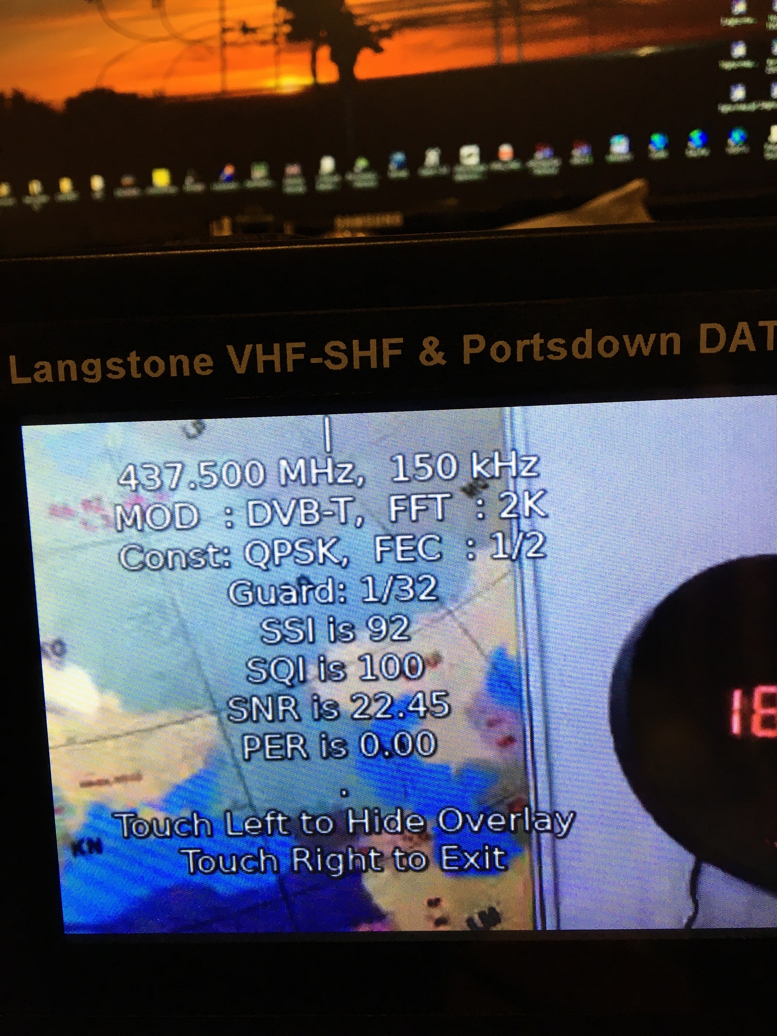

Post by G1LPS Terry » Tue Mar 09, 2021 5:36 pm
Noel Quoted
"You can set the Portsdown (and presumably Ryde in the future) to whatever bandwidth you want - within the limits that seem to be 25oKHz to 8MHz!"
I find that 150khz is the lower limit and its reliable at that bandwidth. 140 and 125khz just wont go. What's the lowest others are seeing ?
picture of M0DTS over 27km on mw's.

Just a quick test across the shack with PD4 each end (Pluto/Knucker) and its good at 250. Nothing at 125 though but the Pluto is TXing.
Once I found the pages to edit the SR send and RX BW I tried 150 and its good here.
I'll await "more experienced operator" comments as to the feasibility/capability' before messing with the menus any further.
What sort of 'gain' does a drop from 250 to 150 give?

I've just done some tests as well. 150 works fine from both Portsdown 4/Pluto and Portsdown 2020/Lime. Gain over 250 should theoretically be about 2dB.
