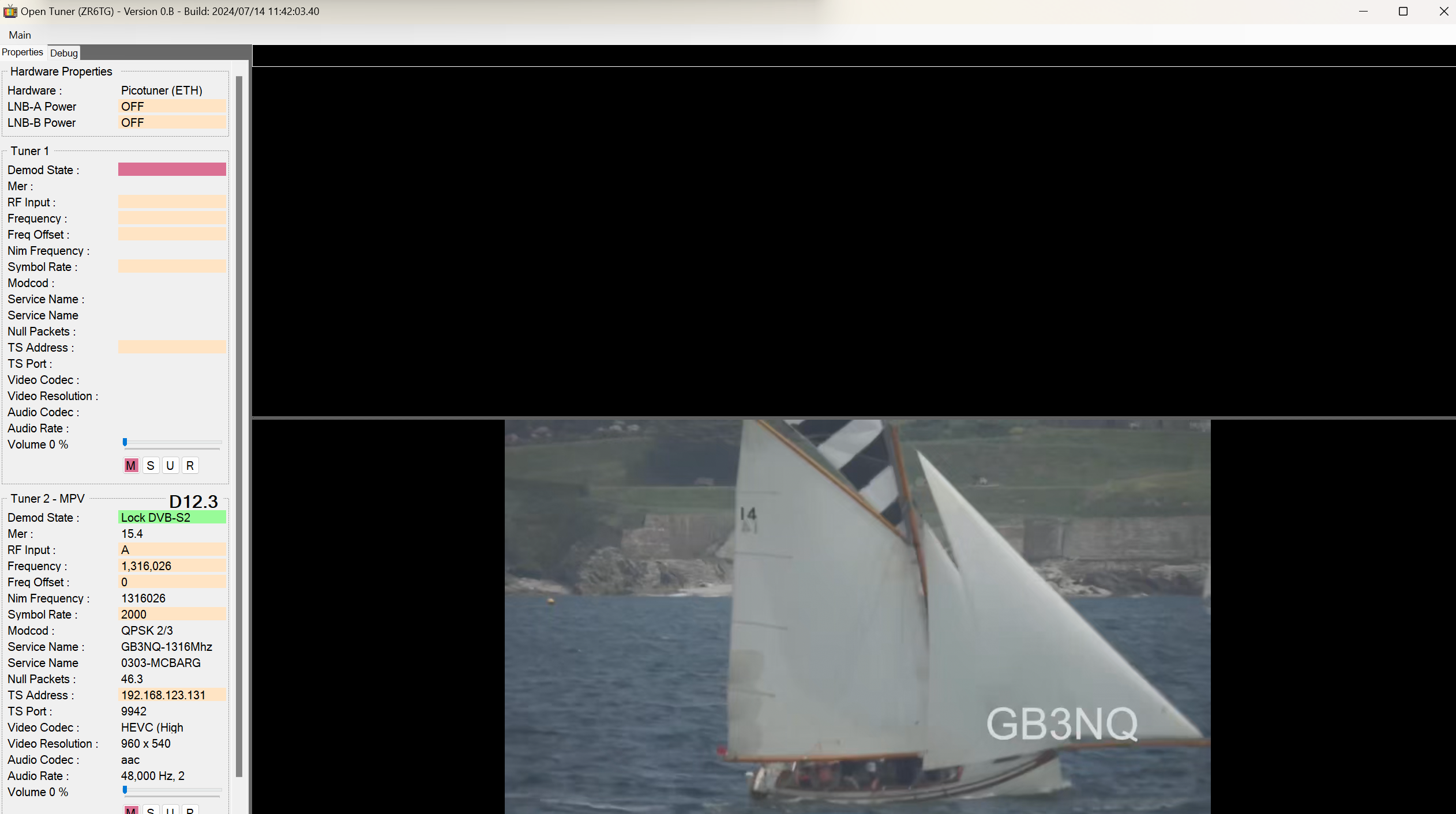

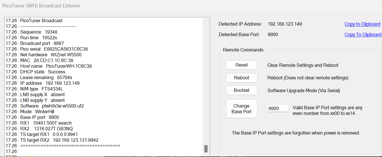

I have just modified my Ryde that I had added a Picotuner board to into the full Picotuner network version.
One thing I found was that it took a long time to get a network IP address. Still it did eventually. Once that was found and the LED stopped double flashing, I ran Opentuner and set it to receive the Picotuner. It all works but only on one channel. I must be missing something as I don't think it is the hardware (but I will check) It did receive two channels in the USB version.
Very pleased with the results so far. Screen dumps below
Martin G8LCE
Screenshot 2024-09-22 172700.png (75.96 KiB) Viewed 8158 times
Screenshot 2024-09-22 172736.png (1.04 MiB) Viewed 8158 times

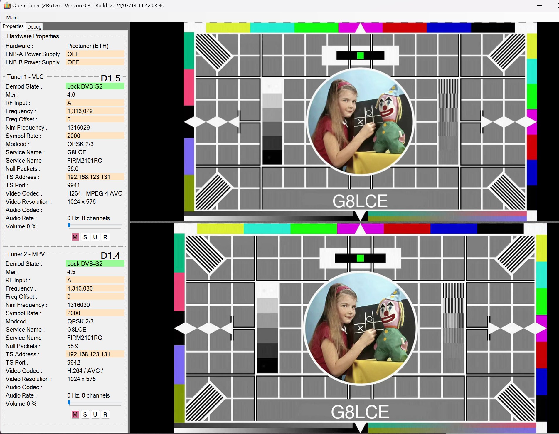

Hi Brian,
Works now I tried again! Not sure what was wrong the first time...
Screenshot 2024-09-23 113647.png (1.59 MiB) Viewed 7999 times
Martin G8LCE
