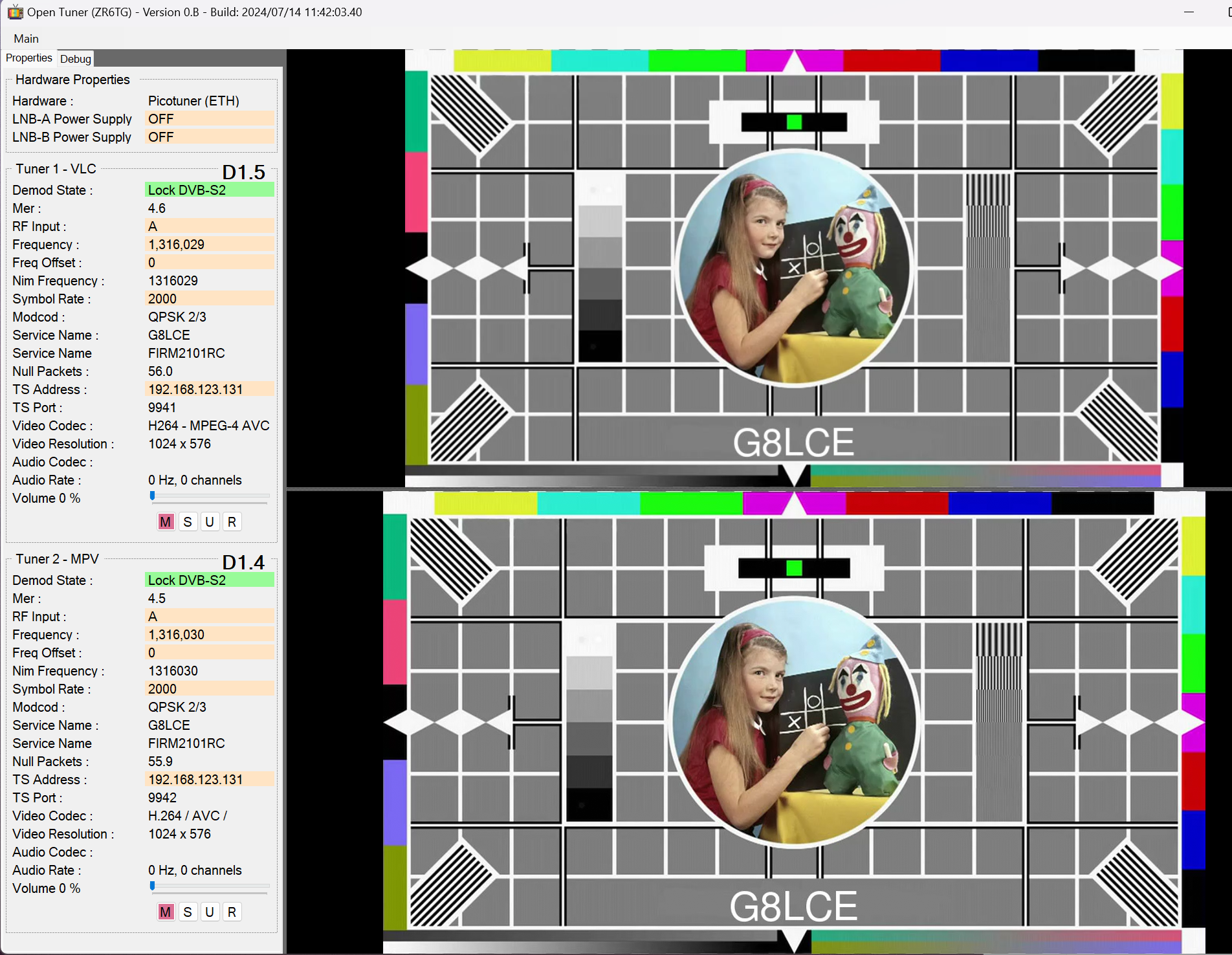

I have just modified my Ryde that I had added a Picotuner board to into the full Picotuner network version.

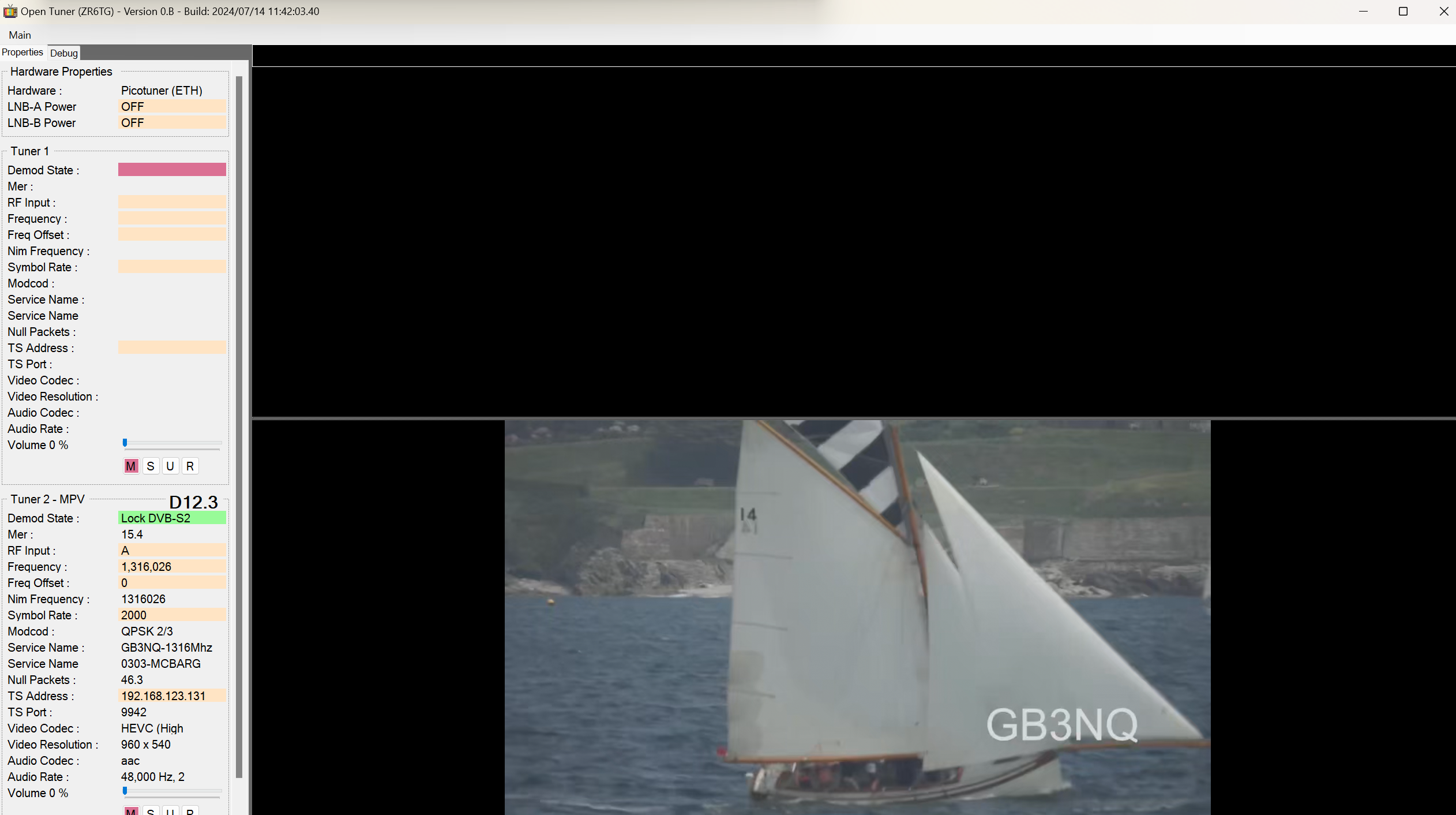

One thing I found was that it took a long time to get a network IP address. Still it did eventually. Once that was found and the LED stopped double flashing, I ran Opentuner and set it to receive the Picotuner. It all works but only on one channel. I must be missing something as I don't think it is the hardware (but I will check) It did receive two channels in the USB version.
Very pleased with the results so far. Screen dumps below
Martin G8LCE

The query now is why only one channel? I will have an investigation...

Post by g8lce » Mon Sep 23, 2024 10:37 am
Hi Brian,
Works now I tried again! Not sure what was wrong the first time...
Screenshot 2024-09-23 113647.png (1.59 MiB) Viewed 7986 times
Martin G8LCE

One thing I am not able to do (probably because I don't understand fully!) is to view the TS on another PC on the network via VLC. Once the tuner is 'tuned' I thought I should be able to see the TS stream from another VLC session on the network.
The thought was to see it in a vlc input on OBS Studio. Ah! Press the U
That makes it work!!!
Martin G8LCE
Posts: 1527
Re: Picotuner with Network
Post by G4EWJ » Thu Sep 26, 2024 2:19 pm
The PicoTunerWH can send each transport stream to only one IP address at a time - the address that the tuning command came from. Simultaneously viewing a TS on several PC's would need the PTWH to use multicast, which is on the to-do list.

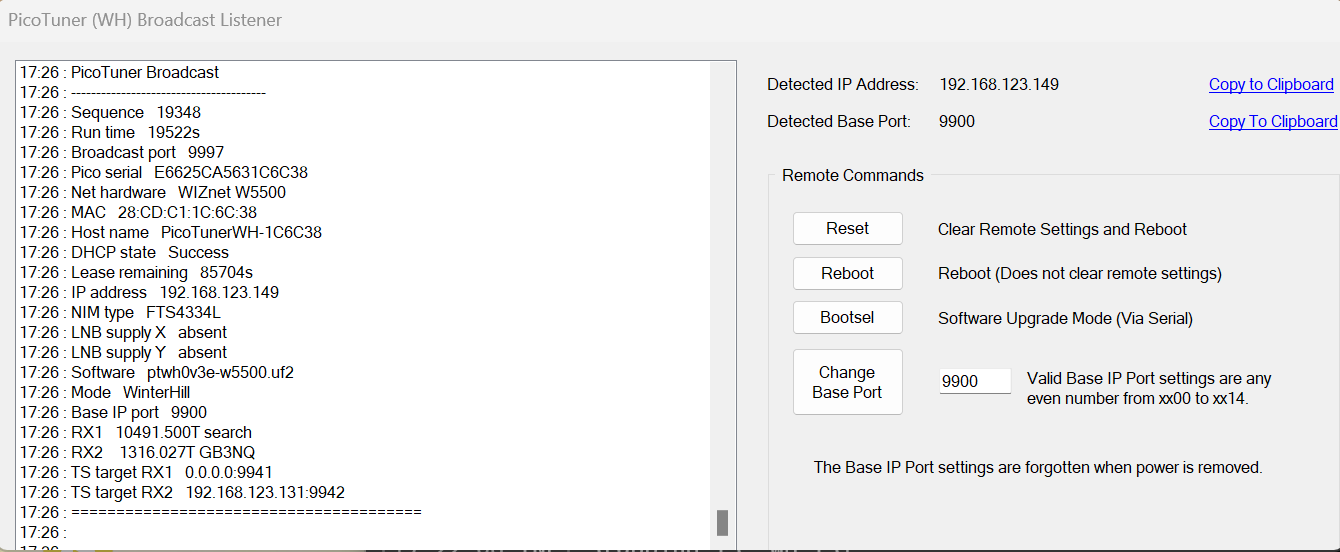

echo "[to@wh] rcv=1 freq=10496250 offset=9750000 srate=500 fplug=a" | netcat -uw1 192.168.xxx.yyy 9920
echo "[to@wh] rcv=2 freq=10498750 offset=9750000 srate=333 fplug=a" | netcat -uw1 192.168.xxx.yyy 9920
| is the vertical bar character.
Optionally add after 'fplug=a':
vgx=
to set the LNB voltage generator: vgx=off,lo,hi,lot,hit
The transport stream will be sent to the IP address that the tuning command came from. It is not possible to send the TS to a chosen IP address.
Receive the 2 transport streams on ports 9941 and 9942. e.g.
vlc udp://@:9941
Note that it is not possible for VLC to display the beacon on an RPi.
