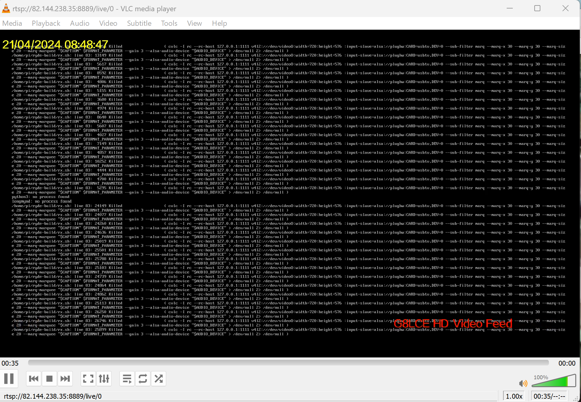

Yes Colin, I was not expecting to receive two 2M SR streams. It is just that I found this was happening to the Ryde when updated firmware and the Picotuner used. The sound was the first thing that failed after a long run. That was cured with a switch off/on. The Ryde worked for a while then stopped receiving and the software was still trying but came up with this:
Screenshot 2024-04-21 094902.png (1.28 MiB) Viewed 14477 times
After forcing an update of the software it was back to normal working again .
I will continue to monitor the system and report any problems.
This Ryde and the old Minitiouner worked well. I have used two Picotuners with this Ryde and had software problems after long periods. It takes a while to identify exactly where the problem is.
Martin G8LCE
