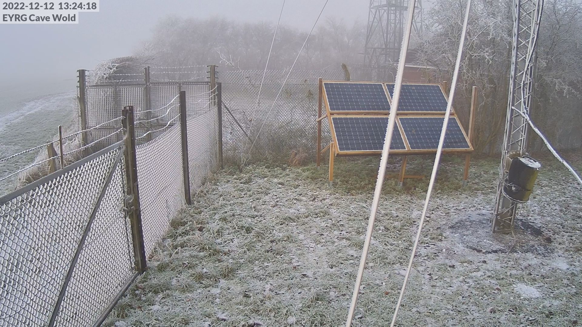

I'm trying to fault find remotely as I really don't want to go up to the site until it warms up a bit. You can see why; it's -5C up there!
EYRG Cave Wold.jpg (514.8 KiB) Viewed 11576 times
