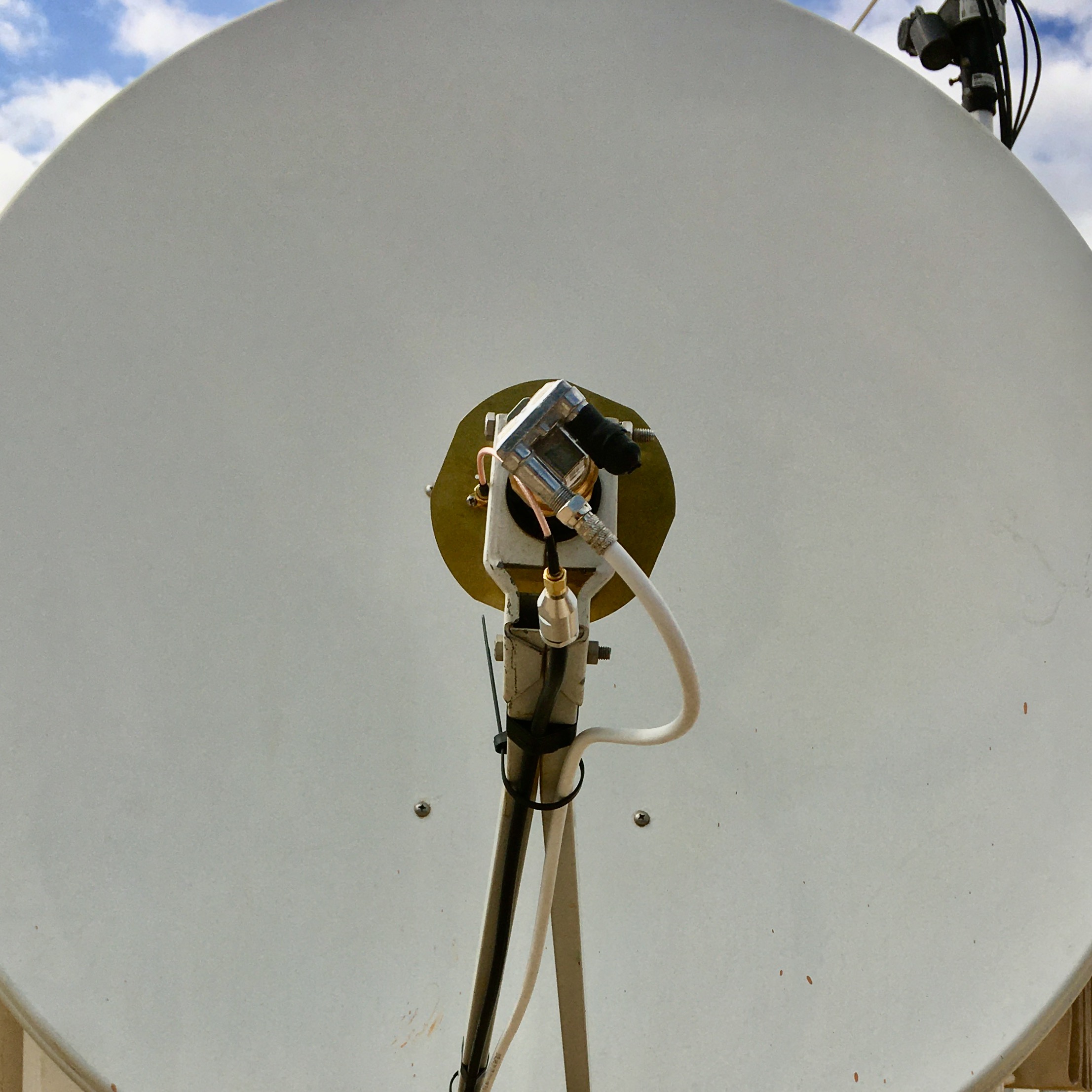

A cloud came by, so here it is on a 1.3m dish - rotated 90 degrees from the original position. It might not be exactly -34.1, but I think its close.
It still isn't receiving the beacon, so am I starting longmynd with the correct offset for a Bullseye LNB?
longmynd -i 192.168.1.33 7777 741500 1500
Michael EA7KIR
Re: Chicken & Egg on New Installation
Post by G8GKQ » Thu Apr 14, 2022 2:57 pm
Michael
I suggest that you look for the narrow band beacons first, and then peak the dish pointing on those. Then rotate the LNB to null out the narrow-band beacons and you are all set to receive DATV.
I NEVER start by looking for the WB signals. The narrow band ones are so much stronger and easier to align on.
