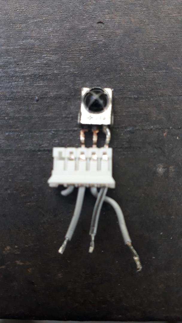

Post by G0SFJ » Sun Aug 15, 2021 10:12 am
I have put a "surplus" IR receiver onto a tiny socket from my junk bag (removed from a stb or router of some description or other): see pcture; note how I have crossed the pins successfully.
73 de andy g0sfj

Post by F1CJN_alain » Sun Aug 15, 2021 11:06 am
Hi
I am using the same on my Ryde from and old tuner.
It runs perfectly with a Samsung remote
