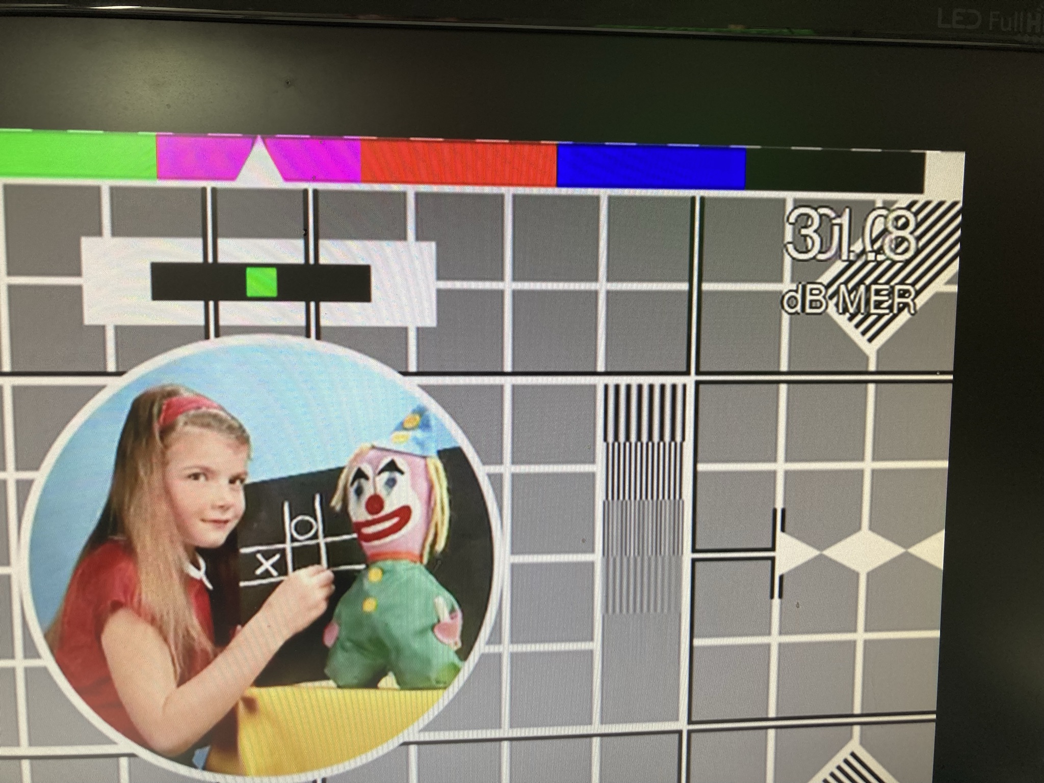

The default size/location for MER is:
Code: Select all
        MER:
            datum: TR
            x: 0.03
            y: 0.15
            w: 0.2
            h: 0.15
The "null" means use the default so you don't include that when specifying it manually and when specifying it manually you must include all 5 values (Datum, X distance from datum, Y distance from datum, width and height).
This for example moves it to the bottom left and makes it twice as big as the default:
Code: Select all
        MER:
            datum: BL
            x: 0.03
            y: 0.03
            w: 0.4
            h: 0.3

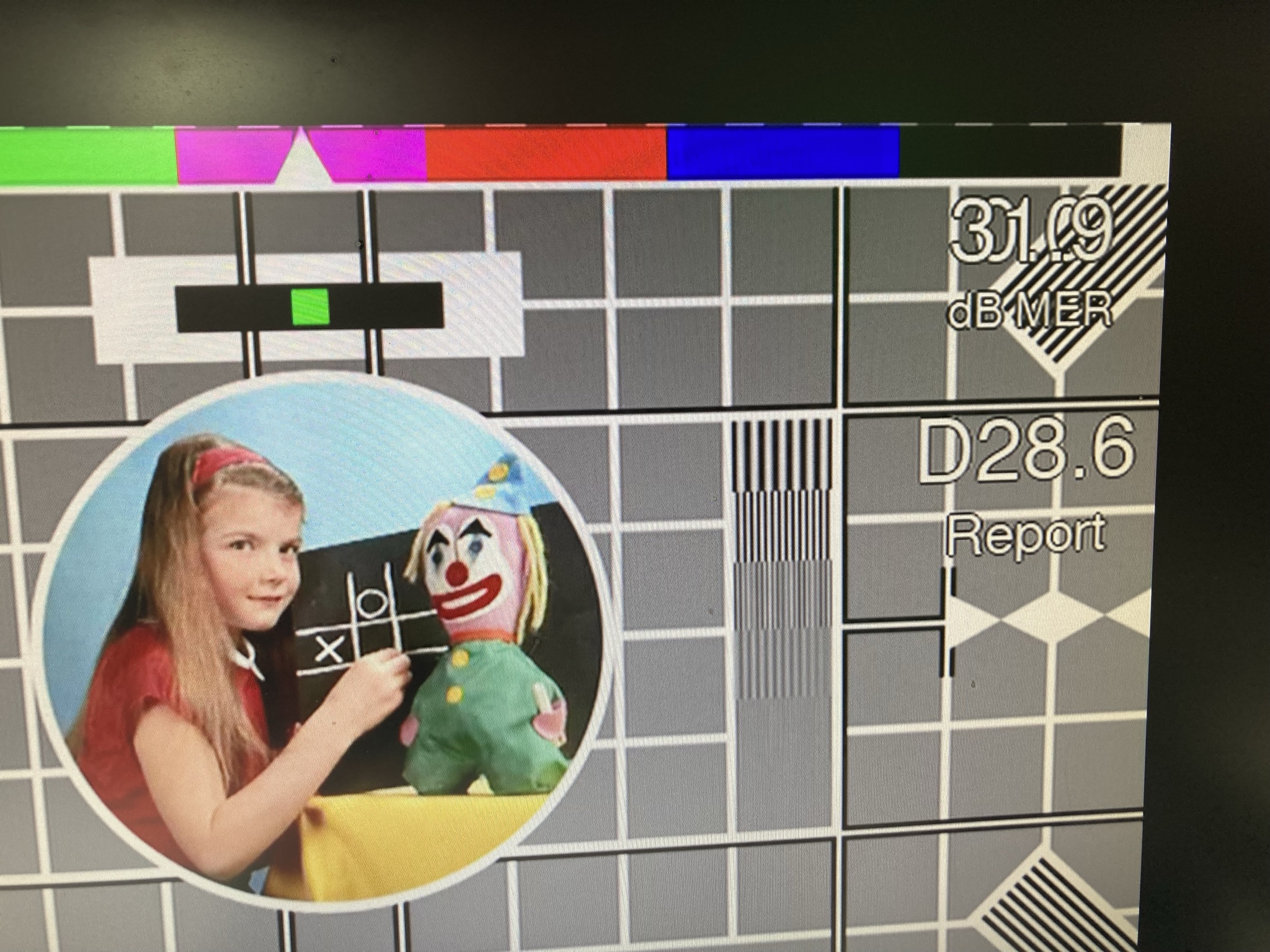

Note that if you want it to be in the same place when both active and inactive you need to put the code in both sections. e.g.
Code: Select all
osd:
    timers:
        USERTRIGGER: 10
        PROGRAMTRIGGER: 10
    active:
        MUTE: null
        MER:
            datum: BL
            x: 0.03
            y: 0.03
            w: 0.4
            h: 0.3
        REPORT: null
        PROGRAM: null
        FREQ: null
        SR: null
    inactive:
        MUTE: null
        MER: MER:
            datum: BL
            x: 0.03
            y: 0.03
            w: 0.4
            h: 0.3
Tim

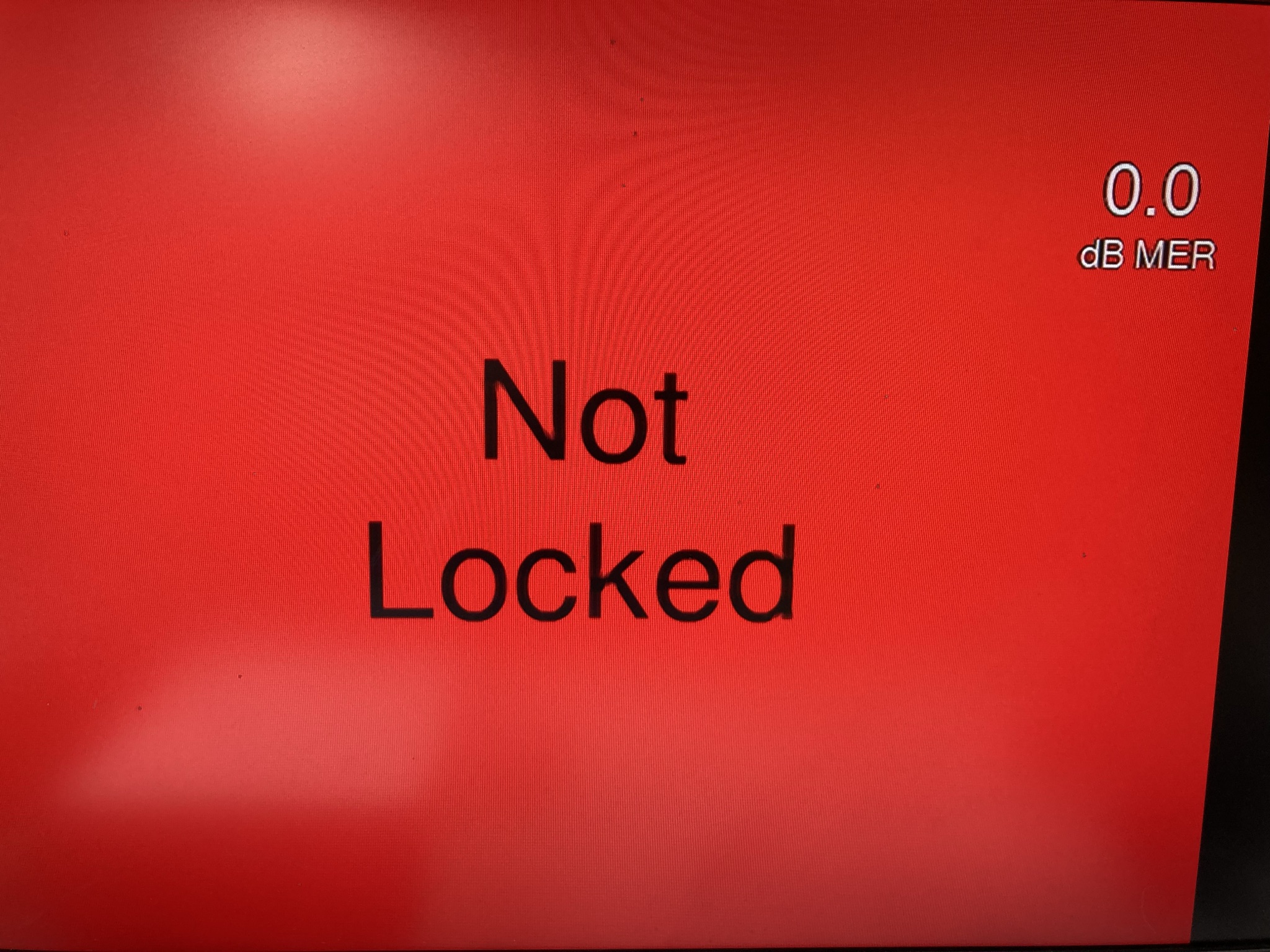

My effort seems to be partially correct. It displays 0.0db MER continuously when no signal is received. When a signal is received it displays the new MER value over the top of the 0.0db MER, both values are then displayed continuously. Have I missed something?
Duncan G7VVF
Re: Customising the Ryde information display
Post by G8GKQ » Tue Jul 27, 2021 10:48 am
Hi Duncan
I think that a reboot should cure that problem. An old display layer was not properly cleared while you were setting it up.
Please let us know if that works.

Post by G7VVF » Tue Jul 27, 2021 11:14 am
Thanks Dave,
I had rebooted the Ryde (from the shutdown menu) after I had uploaded the modified config file. However this time I rebooted both the Pi and the MiniTiouner by removing power to both and now the MER display works correctly.
many thanks
