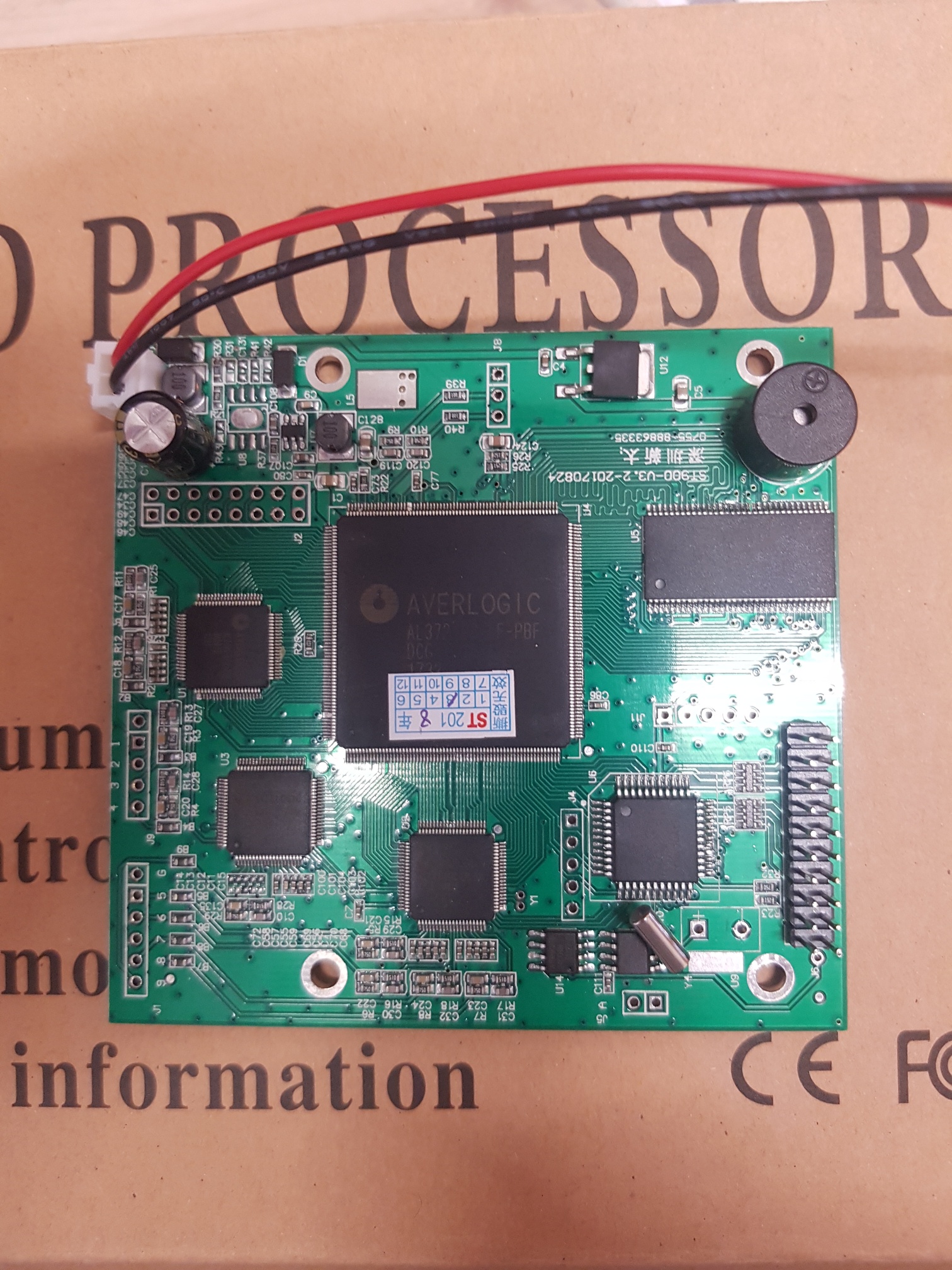

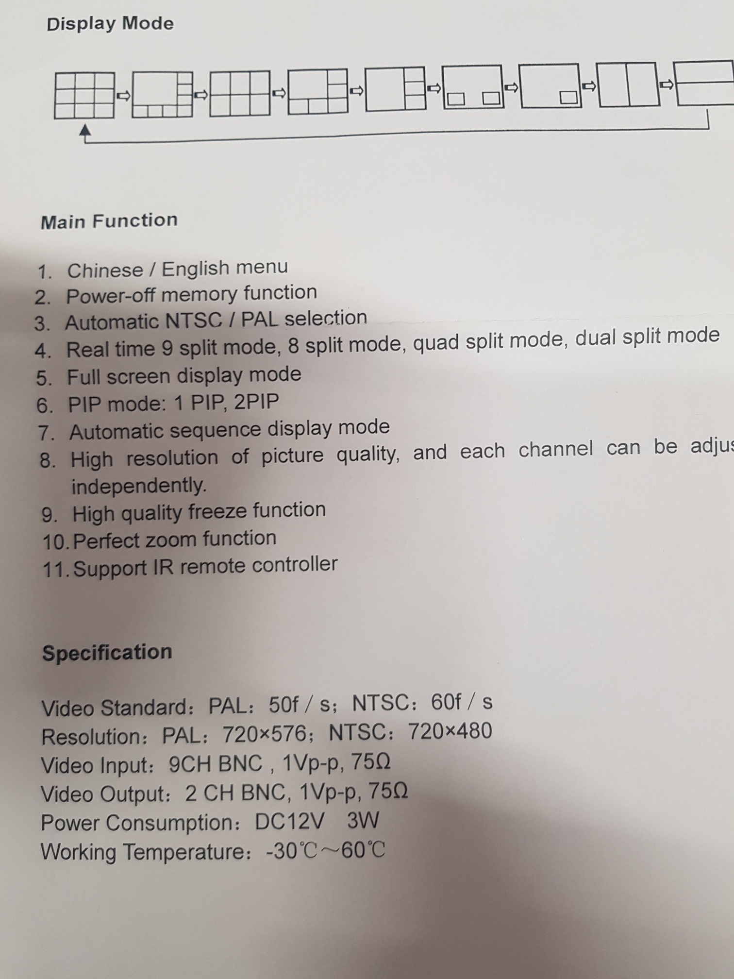

We use this small video processor that can be controlled via RS485.
One command and the display switches.
You can output 1 to 9 video signals at the same time.

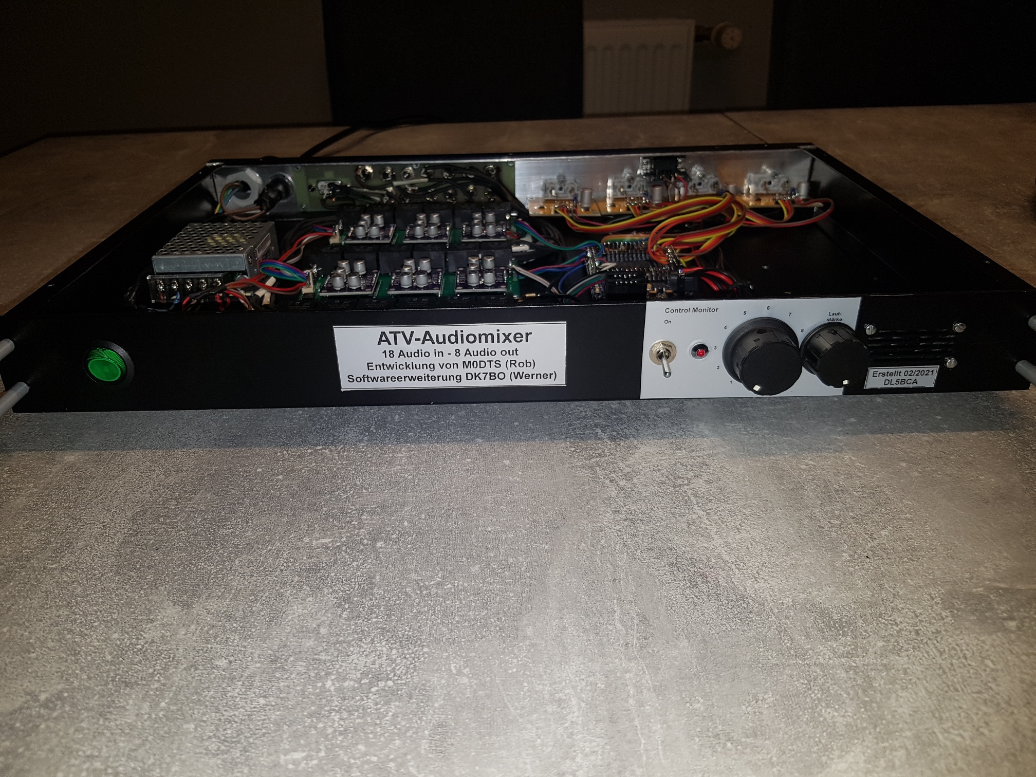

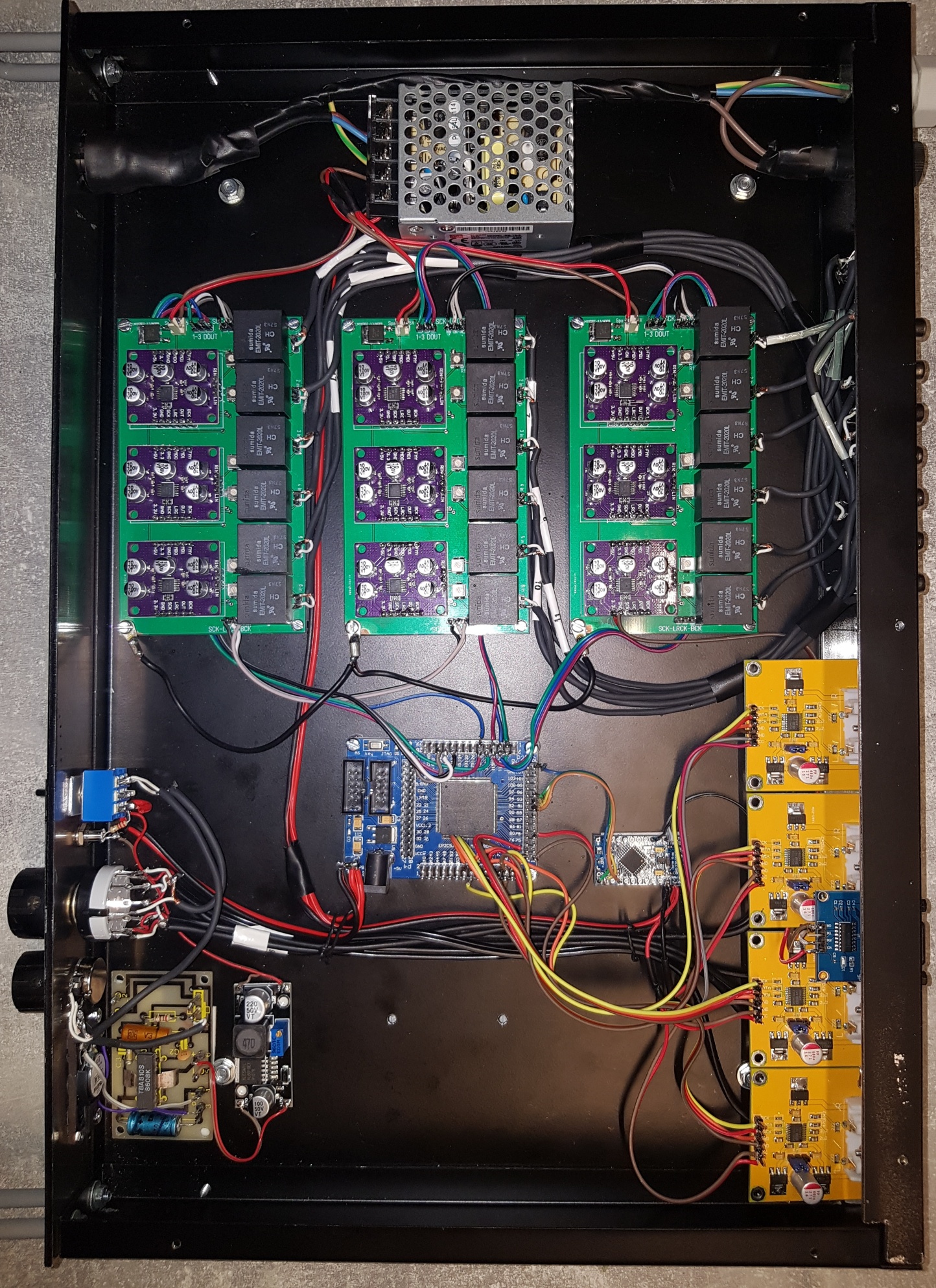

The sound is mixed accordingly with a mixer (developed by Rob M0DTS).

I did look at controlling a quad split device and the python code can be modified to put a pulse output on the relays like a button press. I changed to switching the video through the relays as the quad split is adding another analogue to digital conversion. I also thought about using a HDMI quad split may be an answer as this would be HD ready and this is a future project.
