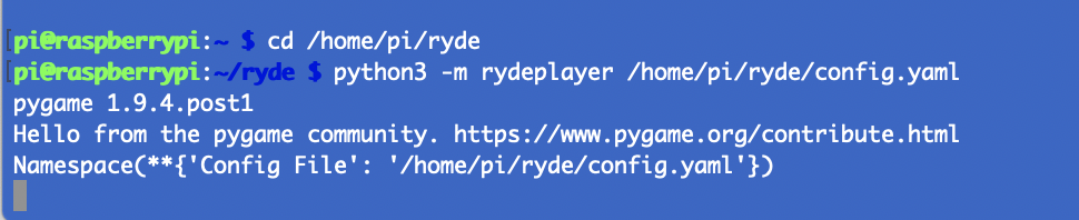

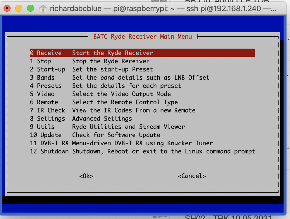

It is an Acer monitor connected to the PI's HDMI. I have selected this mode on the menu.
The monitor works in that it displays a raspberry pi command line.
I ran the two codes you suggested with the results in the screenshots attached. Neither of these returns me to a command line prompt.
The third screenshot is just to show that some Ryde software is loaded and running. I can navigate through these menus, and select items.
I am puzzled because the first time I loaded the software it was all fine and decoded a test picture from the Portsdown no problem. All I did was shutdown and a few days later restarted it and it failed to work properly.
Richard
Richard

Re: Ryde software 403 forbidden
Hi Richard
You have an HDMI Monitor (or cable) problem of some sort. The monitor is not negotiating a valid display resolution with the RPi. The response should be something like this:
Try selecting HDMI safe mode in the video output menu and rebooting. That at least should get you a picture.

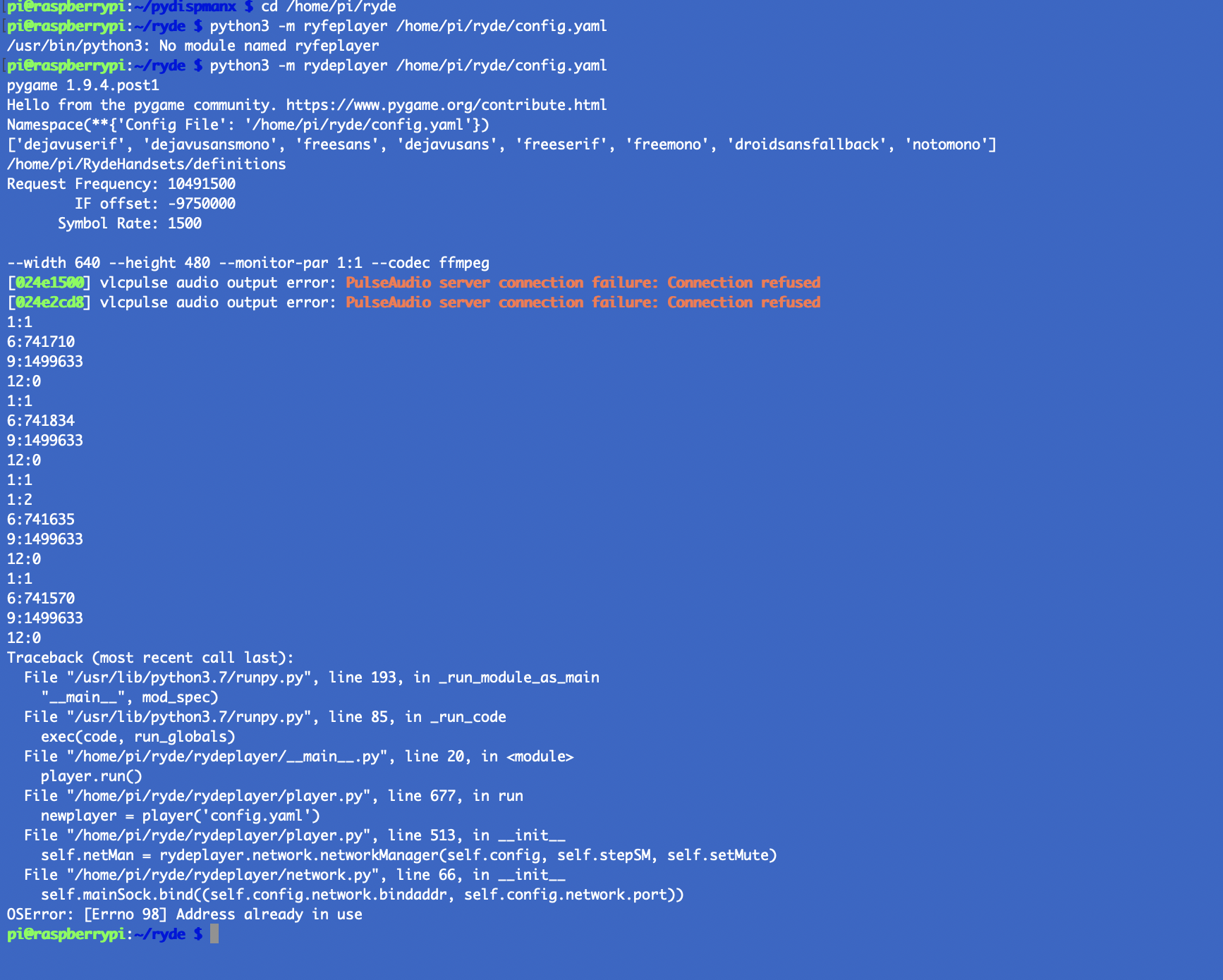

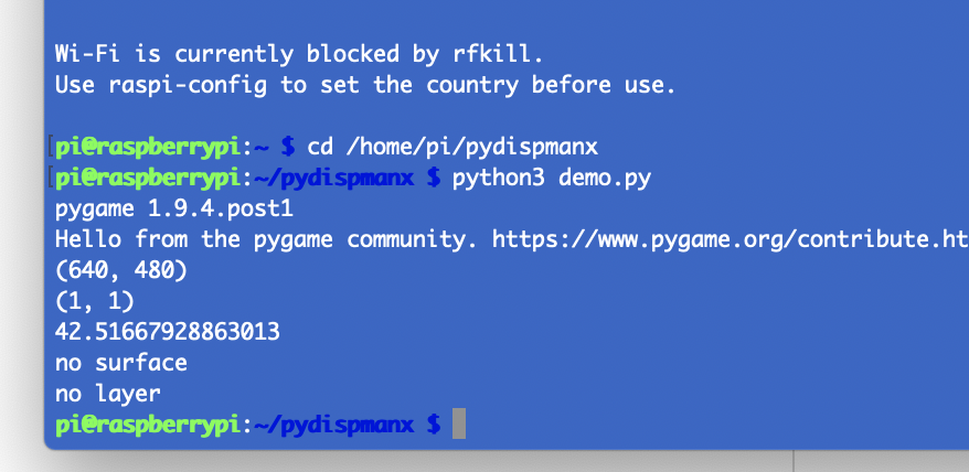

I have a brand new PI 4 and a brand new HDMI cable. The problem still persists in both normal and safe mode and on two different monitors.
I ran the two routines you send me before and the results are in the screenshots attached. The first looks a bit like your example so that's a step forward. The second I can't quite get my head around but maybe it will make some sense at your end.
Thanks and best wishes
Richard
Richard

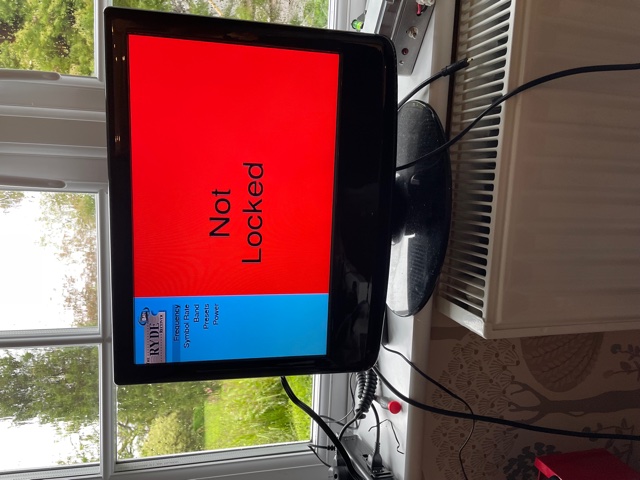

Using composite video I can get a picture - see attached.
Richard
Richard
