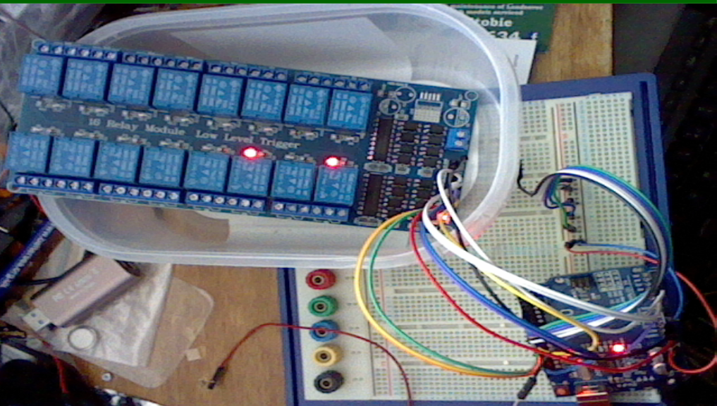

g8lce
Posts: 435
Re: Control system for Rydes at a repeater
Post by g8lce » Thu May 06, 2021 9:30 am
Under the lid of the prototype
Inside the box low res.jpg (1.37 MiB) Viewed 4896 times
Yes it is a lot of wires!
Martin G8LCE

Martin G8LCE
g8lce
Posts: 435
Post by g8lce » Sun May 16, 2021 12:03 pm
I have now tweeked the delays a little and removed a few lines:

This stops the received signal relay firing while the RPi is booting and other streamlining...
Martin G8LCE
