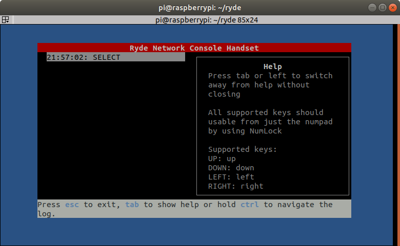

Ryde Network Console Handset
This lets you push buttons on the Ryde using a keyboard over the network. Useful for long distance remote control or if you haven't built an IR or GPIO interface yet.

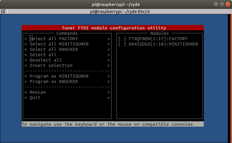

Tuner FTDI module configuration utility
This lets you program the FTDI 2232H modules from the Pi. Useful if you don't have easy access to Windows or want to program multiple modules quickly. It has all the configurations internally so you don't need to keep track of finding the right config to use. It is important to note that running this while Ryde is running will cause Ryde to lose connection to the tuner.
