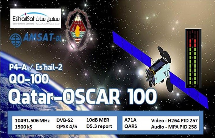

Not exactly a high priority but judging by the number of times we have to use the volume control between different stations on the BATC net, the option to bring up an audio level on the OSD would be a very useful feature.
Could be positioned on the side of the OSD screen which I think still needs a tidy up :-)
Or maybe we need this on the Portsdown input??
ryde info2 (Small).JPG (106.66 KiB) Viewed 4197 times
