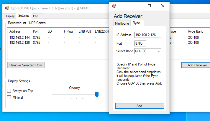

Thanks to some excellent work from Tim MW0RUD and Rob M0DTS, Quick Tune and Ryde now work together. So you can have Quick Tune running on your Windows PC, and have it control up to 4 Ryde receivers on the same network.
The get this latest version of Ryde (202101260) log in to the SSH console and type menu. Use the arrow keys to get to the Update option, select it and follow the instructions. The update should preserve your remote control selection, but will restore the "factory" presets, so you may need to reset your QO-100 LNB LO frequency. Those of you who have edited your presets may want to save your preset file beforehand and manually edit the details back in to the new file.
You can download Version 1.21b (or later) of Quick Tune from here: https://github.com/m0dts/QO-100-WB-Live ... /tag/1.21b. After starting it, you need to enter the IP address of your Ryde, and click on the drop-down to select the QO-100 band. Quick Tune will then use the QO-100 settings from your Ryde.

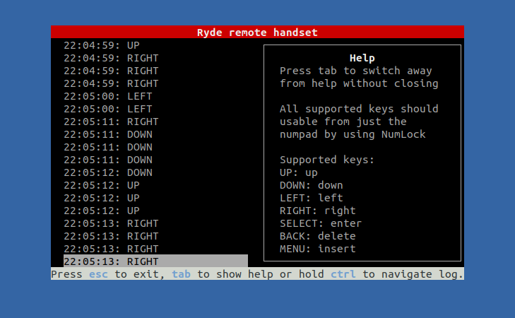

And now a quick tease for an interface that wasn't ready in time for this release:
Tim MW0RUD
