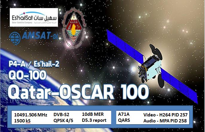

Works well - thanks Tim and Dave.
I think the layout could do with a tidy up at some point - I know it's on the to-do list!
I would suggest something like this:
ryde info.JPG (80.4 KiB) Viewed 5119 times
