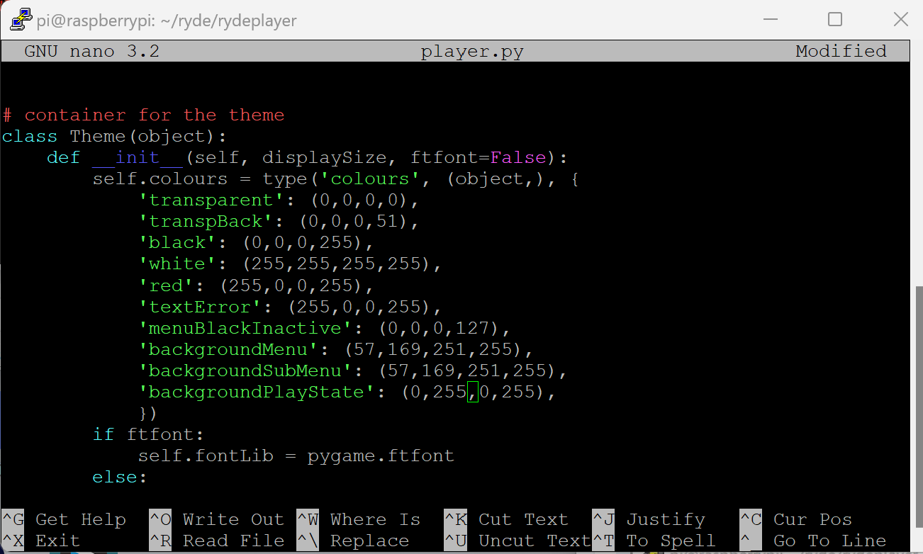

To change the background colour
cd /home/pi/ryde/rydeplayer/
nano player.py
then go down to where it says :
Screenshot 2024-04-04 092941.png (81.49 KiB) Viewed 8029 times
and change the colours of 'backgroundPlayState': (0,255,0,255), . This has already been done in this example to green. It goes RGBI
Martin G8LCE

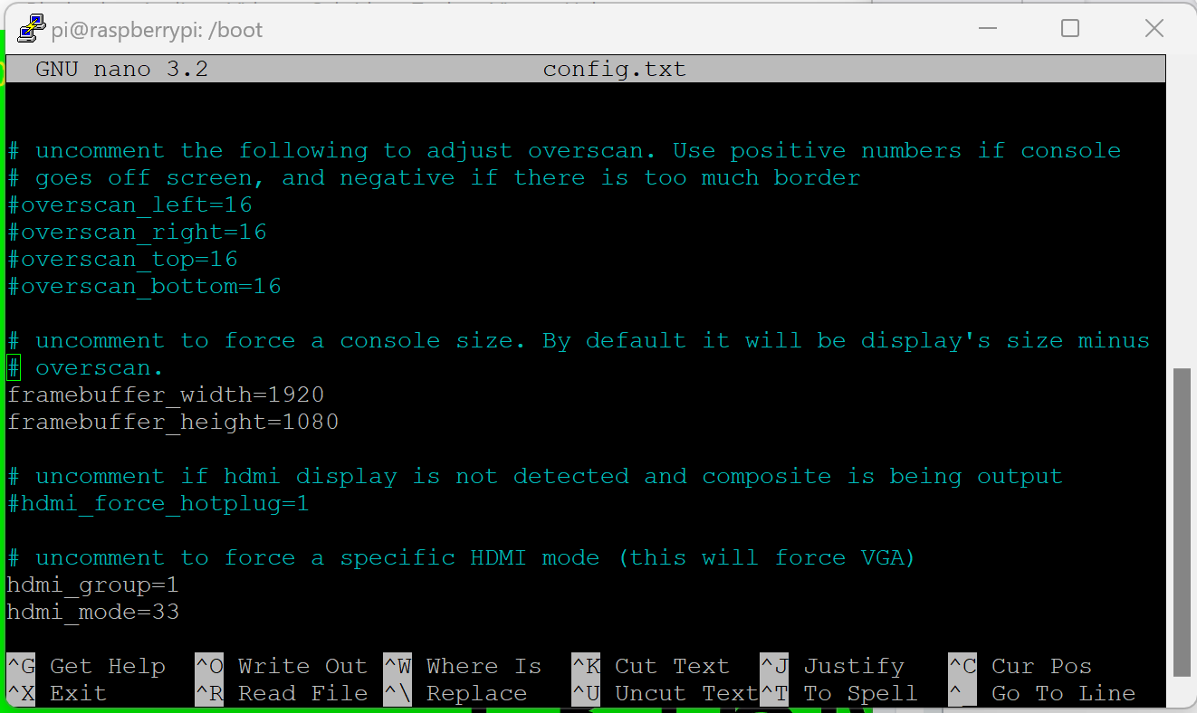

Now for the HDMI screen...
I have a Ryde that has been updated and the HDMI output decided to go low resolution and 4 by 3! To force it to 1080 and 16 by 9 I did the following editing:
cd /boot/
sudo nano config.txt
and changed the text that is now white:
Screenshot 2024-04-04 112340.png (69.52 KiB) Viewed 8020 times
Martin G8LCE

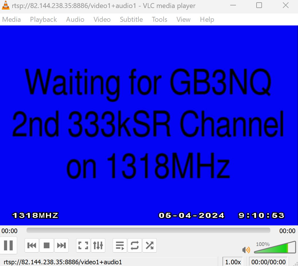

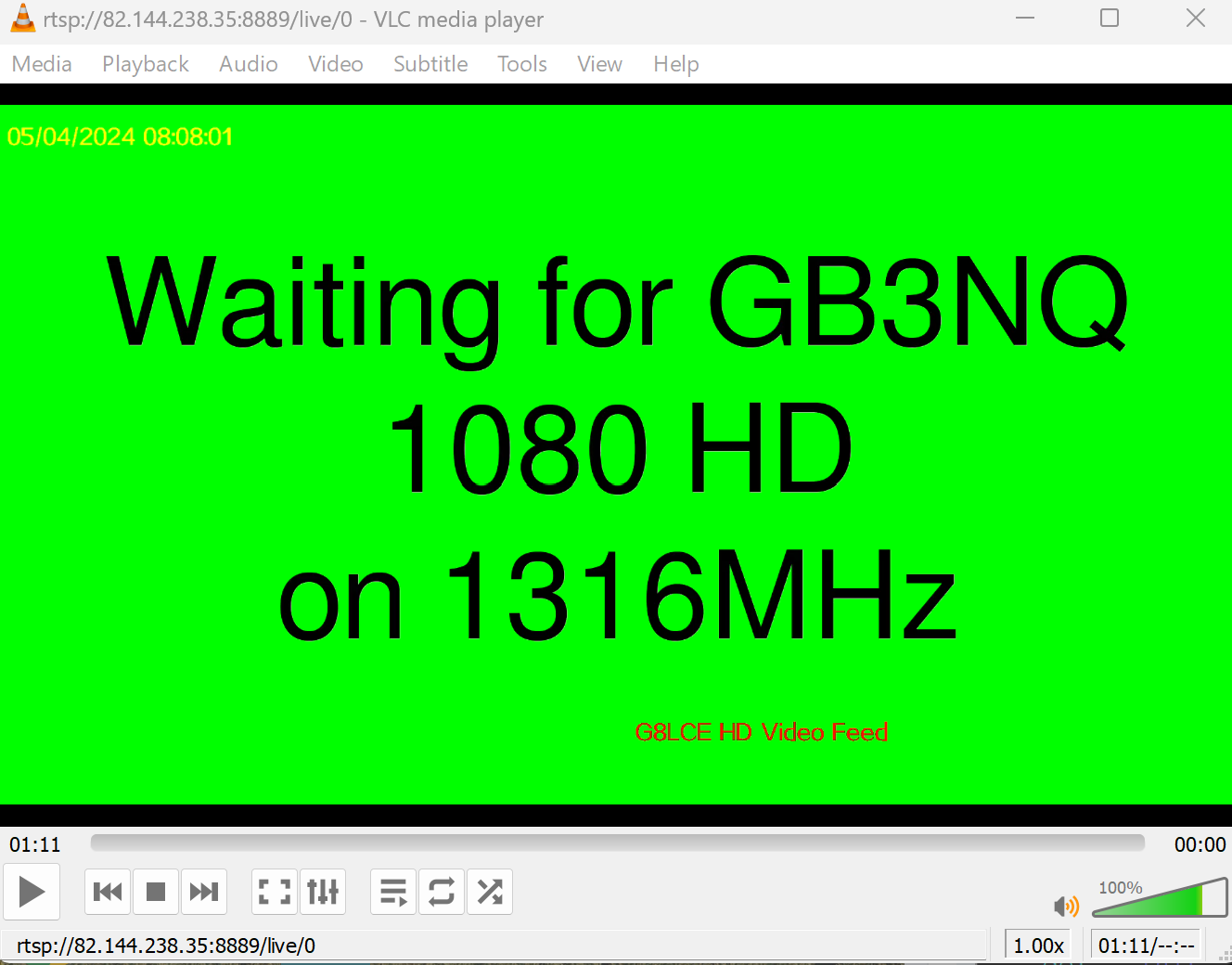

Some examples of above editing:
Screenshot 2024-04-05 090828.png (174.07 KiB) Viewed 7902 times
Screenshot 2024-04-05 091100.png (292.71 KiB) Viewed 7902 times
Note that you may have to redo the editing after a software update
