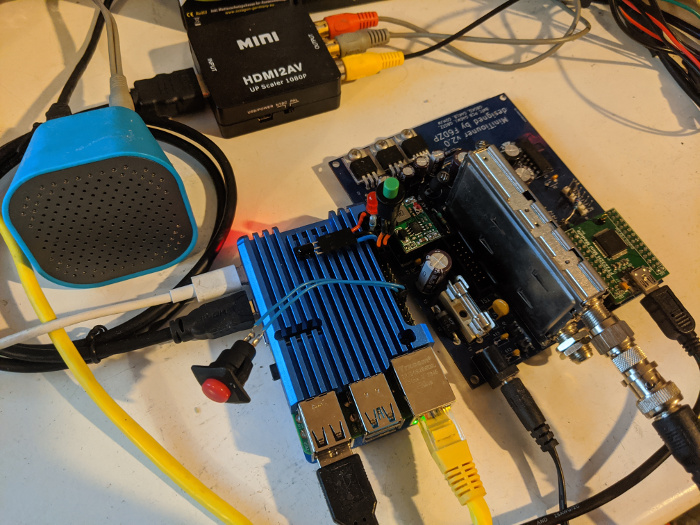

Thanks to all beta testers who have been really helpful with getting it stable enough to publish and particularly to Dave for help specifying the project, initial debugging and particularly for doing all be integration and build system. My dev hardware is much less elegant and complete than Dave's:
Issues and feature requests (that aren't already on the list) as well as pictures or descriptions of unusual setups or testing are welcome and encouraged.
