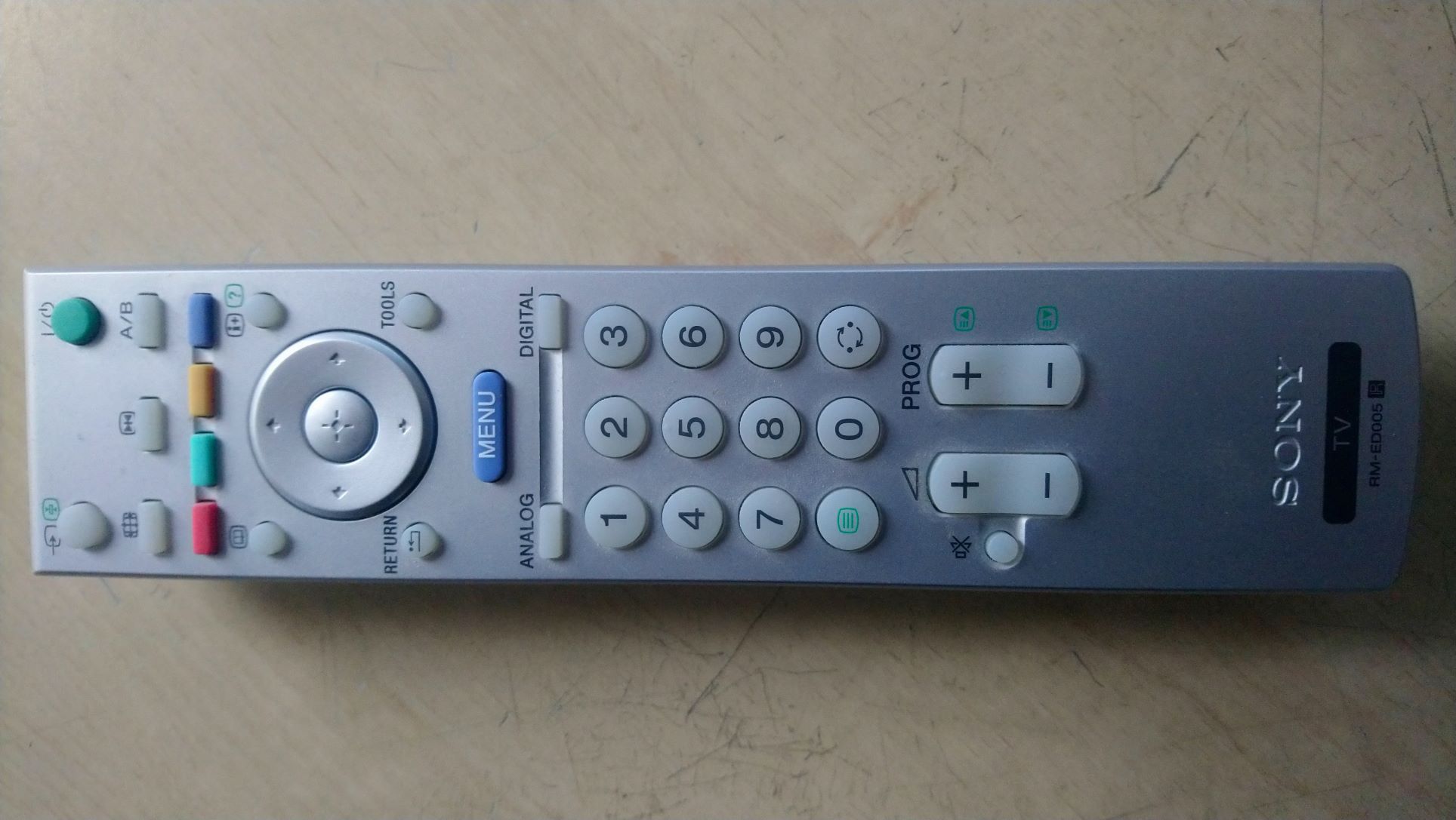

Adding Sony RM-ED005
driver: sony
buttons:
POWER: 0x10015
UP: 0x10074
DOWN: 0x10075
LEFT: 0x10034
RIGHT: 0x10033
SELECT: 0x10065
BACK: 0x970023
MENU: 0x10060
MUTE: 0x10014
VOL+: 0x10012
VOL-: 0x10013
CHAN+: 0x10010
CHAN-: 0x10011
ZERO: 0x0009
ONE: 0x0000
TWO: 0x0001
THREE: 0x0002
FOUR: 0x0003
FIVE: 0x0004
SIX: 0x0005
SEVEN: 0x0006
EIGHT: 0x0007
NINE: 0x0008
OSDTOG: 0x1003f
