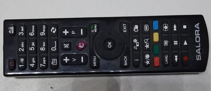

Hi, Just added a solora RC-5 Remote...
driver: rc-5
buttons:
POWER: 0x10c
UP: 0x114
DOWN: 0x113
LEFT: 0x115
RIGHT: 0x116
SELECT: 0x135
BACK: 0x10a
MENU: 0x12b
MUTE: 0c10d
VOL+: 0x110
VOL-: 0x111
CHAN+: 0x120
CHAN-: 0x121
ZERO: 0x100
ONE: 0x101
TWO: 0x102
THREE: 0x103
FOUR: 0x104
FIVE: 0x105
SIX: 0x106
SEVEN: 0x107
EIGHT: 0x108
NINE: 0x109

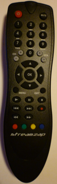

A streamzap remote. I've mapped the stop (square) button to OSDTOG.
Code: Select all
driver: rc-5-sz
buttons:
POWER: 0x2894
UP: 0x28a1
DOWN: 0x28a8
LEFT: 0x28a2
RIGHT: 0x28a7
SELECT: 0x28a4
BACK: 0x28ad
MENU: 0x28ab
MUTE: 0x2897
VOL+: 0x289b
VOL-: 0x289e
CHAN+: 0x2898
CHAN-: 0x289d
ZERO: 0x2880
ONE: 0x2883
TWO: 0x2885
THREE: 0x2886
FOUR: 0x2889
FIVE: 0x288a
SIX: 0x288c
SEVEN: 0x288f
EIGHT: 0x2891
NINE: 0x2892
OSDTOG: 0x28b3

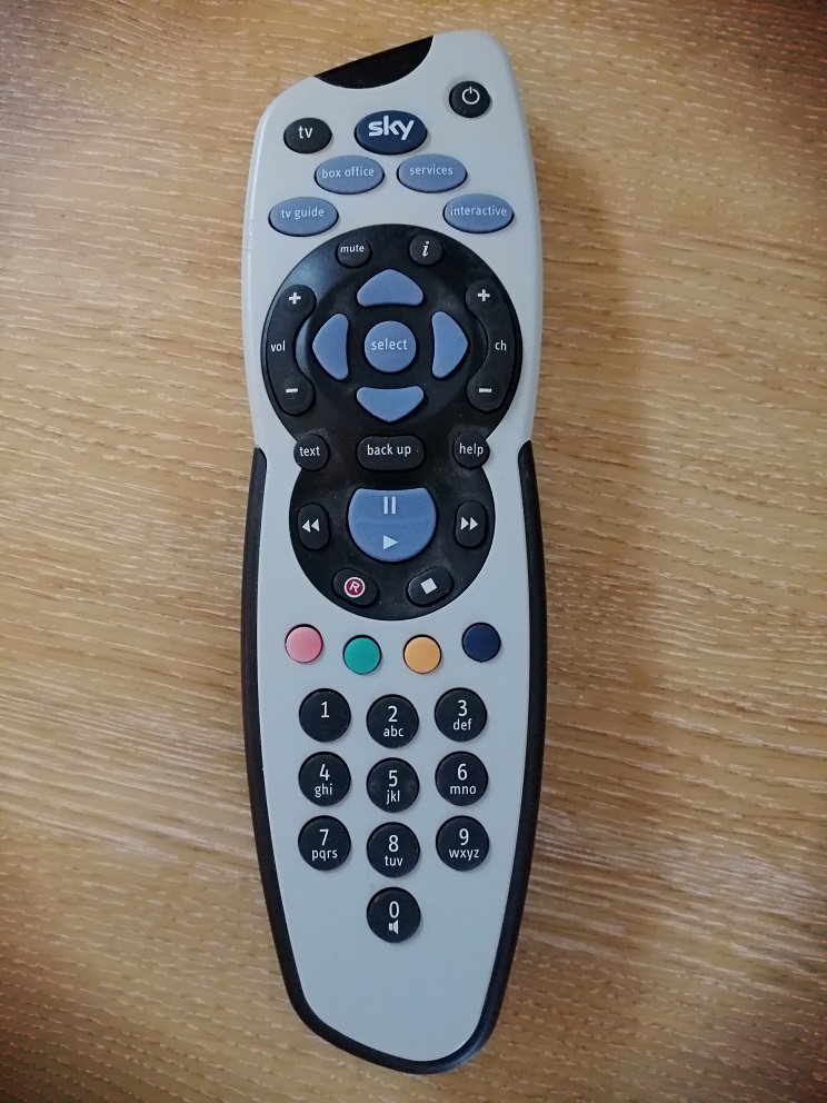

Today I have built a Ryde Rx, great job! I am using a Sky remote and provide the details below:
(The OSDTOG is the i button)
driver: rc-6
buttons:
POWER: 0xc0c
UP: 0xc58
DOWN: 0xc59
LEFT: 0xc5a
RIGHT: 0xc5b
SELECT: 0xc5c
BACK: 0xc83
MENU: 0xc80
MUTE: 0x117
VOL+: 0x114
VOL-: 0x115
CHAN+: 0xc20
CHAN-: 0xc21
ZERO: 0xc00
ONE: 0xc01
TWO: 0xc02
THREE: 0xc03
FOUR: 0xc04
FIVE: 0xc05
SIX: 0xc06
SEVEN: 0xc07
EIGHT: 0xc08
NINE: 0xc09
OSDTOG: 0xccb

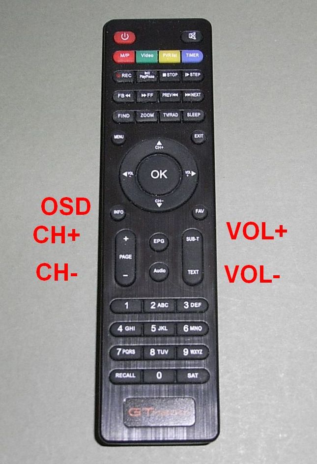

GTMedia Remote control codes for Ryde.
driver: nec
buttons:
POWER: 0x311
UP: 0x347
DOWN: 0x34b
LEFT: 0x357
RIGHT: 0x353
SELECT: 0x304
BACK: 0x352
MENU: 0x343
MUTE: 0x310
VOL+: 0x342
VOL-: 0x34f
CHAN+: 0x308
CHAN-: 0x35e
ZERO: 0x31e
ONE: 0x31d
TWO: 0x31c
THREE: 0x346
FOUR: 0x315
FIVE: 0x314
SIX: 0x345
SEVEN: 0x300
EIGHT: 0x31f
NINE: 0x31b
OSDTOG: 0x313
