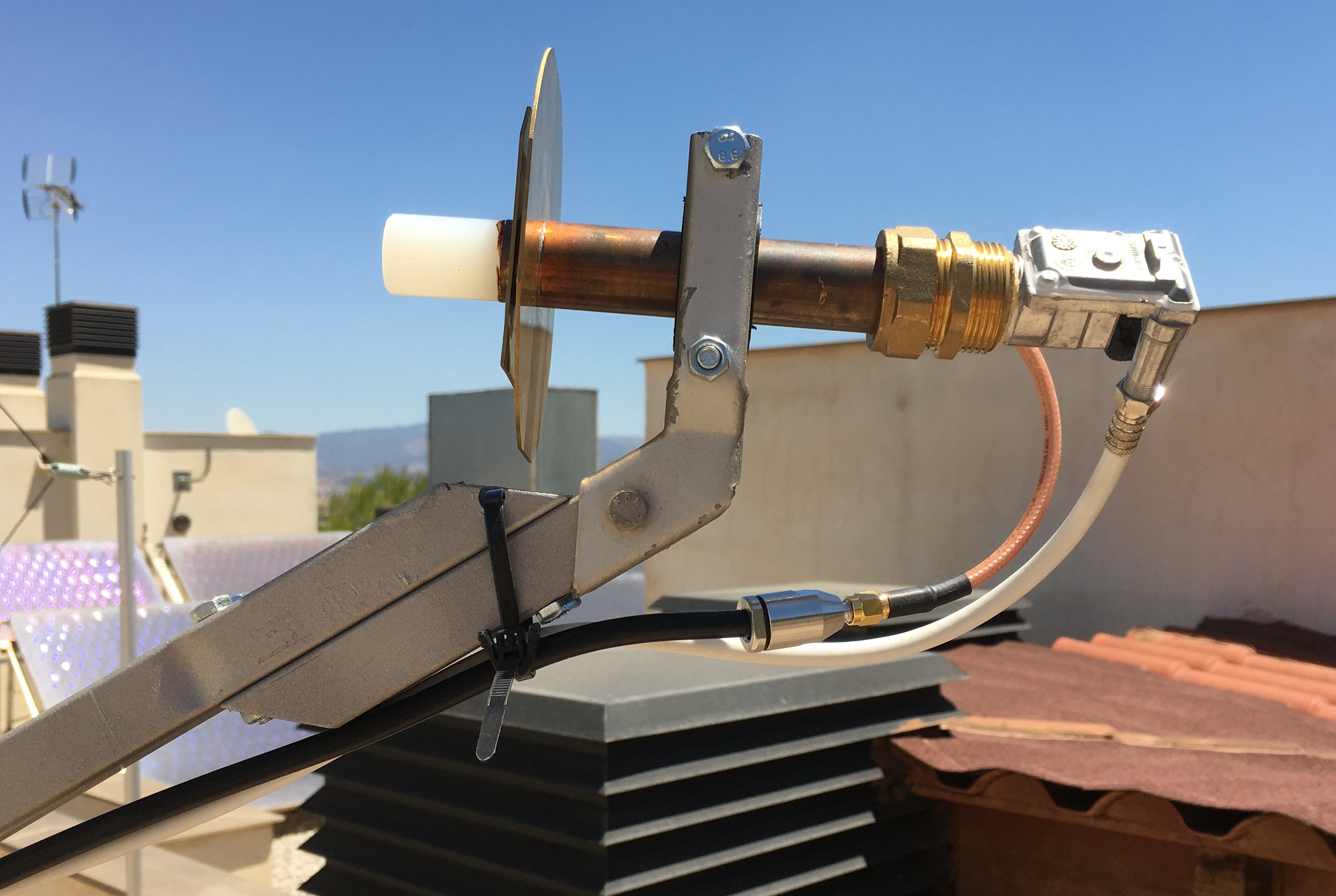

I’m thinking of extending the arm by an inch or two, instead of buying a printer.

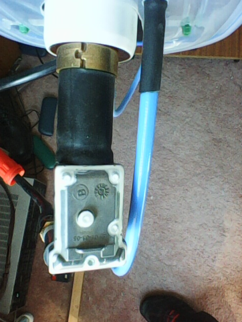

Well I have no printer so I made an offset (oval) mount from a 22mm straight copper solder connector (knock the middle insert stop pins off first).
Then I mounted that, off centre, in a piece of 40mm plumbing pipe.
Then filled the gap with Polyester resin. And finally milled the surfaces flat.
Worked for me. I tapped a 3 mm hole for a locking screw straight into the lot.
But with an N-type socket (use the min SMA footprint/1mm pin ones only) it is even worse - less clearance, and again worse with Heliax or 1/2 corrugated coax.

There is no magic to the length of the copper pipe behind the patch feed, it is low loss so make it longer if you need more clearance. Polarisation rotation may be an issue if more than a few metres long or if you try to bend it. Unlikely situation in practice.
Don't neglect wood as a material for making things with if you don't have a 3D printer (Prusa Mini, Flashforge Dreamer NX, Creality are all OK). Wood is easy to get, easy to machine, cheap, sustainable and if treated will last longer than the transponder.
Don't extend the arm. Just raise the height a bit so it fits. It won't make a significant difference to the gain within reason. what is important is the focal plane.

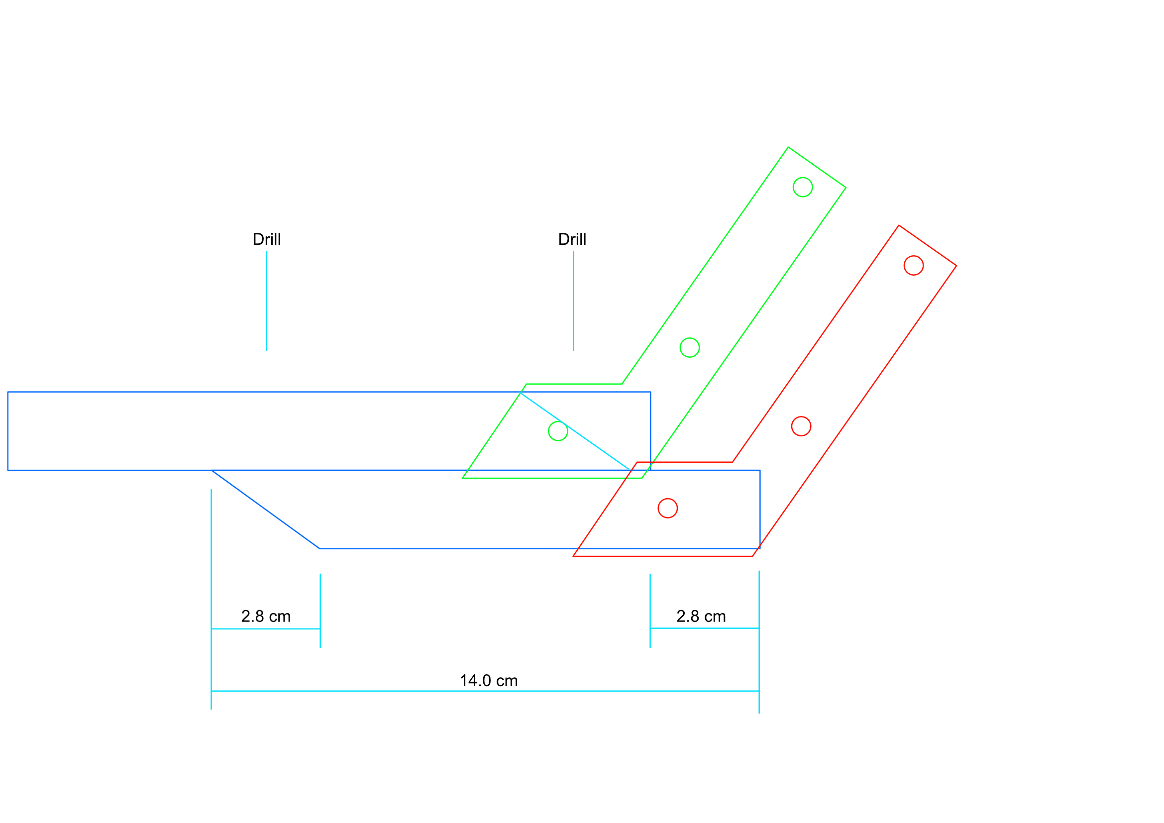

Here's how I ended up lengthening the feed arm, whilst maintaining the axis. GREEN=Original,RED=Modified.
NB Mike G0MJW - SMA pigtail as you suggested.
BUT - I'm still only getting 7.3 MER., using a Gibertini OP 125 L 1.3m Dish, AND after aligning everything to the NB CW Beacon. The signal level drops by 10db on wrong polarisation.

I would suggest a proper lens, not that one, but it will sort of work. The HB9PZK design is a lot better. Make sure it is at the focus. 10dB difference is not good though, nothing like. Should be 20dB at least. You need to get the polarisation rotation correct. Also this can be impacted by not being at the focus, but not by that much. I assume you tweaked it by rotating the LNB looking for a null in the opposite polarisation?
Edit - in the photo the edge of the pipe at the front looks very rough? I assume that's just the photo?
Edit 2 - are you sure you rotated the polarisation offset the right way?
