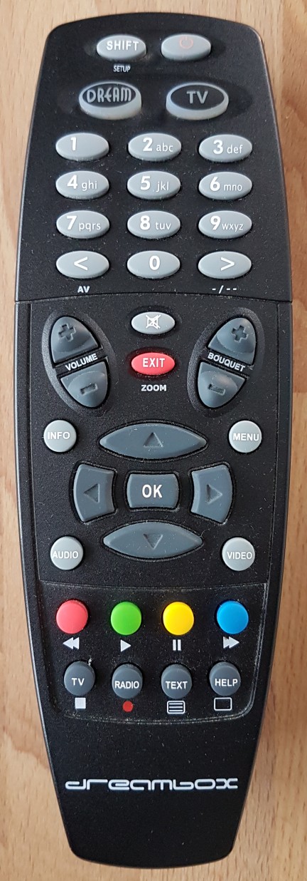

Dreambox URC39931RJ0-06 (TV):
dreamboxurc39931.yaml:
Code: Select all
name: Dreambox URC39931RJ0-06 (TV)
driver: rc-5
buttons:
    POWER:  0x0c
    UP:     0x50
    DOWN:   0x51
    LEFT:   0x55
    RIGHT:  0x56
    SELECT: 0x57
    BACK:   0x7e
    MENU:   0x52
    MUTE:   0x0d
    VOL+:   0x10
    VOL-:   0x11
    CHAN+:  0x20
    CHAN-:  0x21
    ZERO:   0x00
    ONE:    0x01
    TWO:    0x02
    THREE:  0x03
    FOUR:   0x04
    FIVE:   0x05
    SIX:    0x06
    SEVEN:  0x07
    EIGHT:  0x08
    NINE:   0x09
"BOUQUET+" is CHAN+, "BOUQUET-" is CHAN- and "Exit" is BACK.

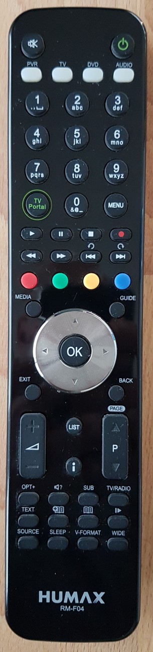

Humax RM-F04 (PVR):
humaxrmf04.yaml:
Code: Select all
name: Humax RM-F04 (PVR)
driver: nec
buttons:
    POWER:  0x1000
    UP:     0x1011
    DOWN:   0x1015
    LEFT:   0x1012
    RIGHT:  0x1014
    SELECT: 0x1013
    BACK:   0x1041
    MENU:   0x100e
    MUTE:   0x1018
    VOL+:   0x101f
    VOL-:   0x1040
    CHAN+:  0x1010
    CHAN-:  0x100f
    ZERO:   0x100c
    ONE:    0x1003
    TWO:    0x1004
    THREE:  0x1005
    FOUR:   0x1006
    FIVE:   0x1007
    SIX:    0x1008
    SEVEN:  0x1009
    EIGHT:  0x100a
    NINE:   0x100b

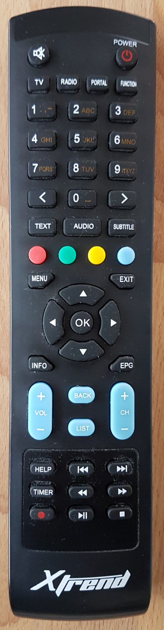

Xtrend KT1252-XHY (TV):
xtrendkt1252.yaml:
Code: Select all
name: Xtrend KT1252-XHY (TV)
driver: nec
buttons:
    POWER:  0x0a
    UP:     0x10
    DOWN:   0x16
    LEFT:   0x12
    RIGHT:  0x14
    SELECT: 0x13
    BACK:   0x1e
    MENU:   0x0f
    MUTE:   0x0b
    VOL+:   0x1d
    VOL-:   0x20
    CHAN+:  0x1f
    CHAN-:  0x22
    ZERO:   0x00
    ONE:    0x01
    TWO:    0x02
    THREE:  0x03
    FOUR:   0x04
    FIVE:   0x05
    SIX:    0x06
    SEVEN:  0x07
    EIGHT:  0x08
    NINE:   0x09
