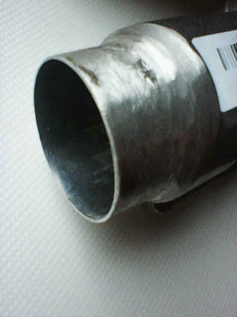

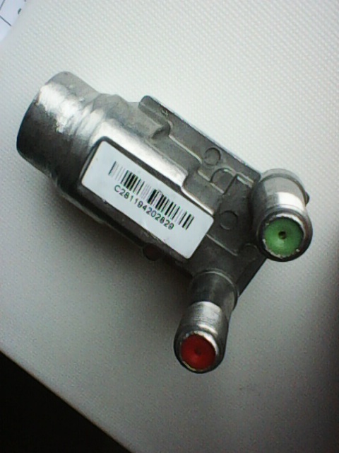

Bullseye LNB mounting in the POTY - is this the right subject for this?
If this helps, I used an upturned belt sander [held on a workbench at a nice height for my chair] with coarse grit to quickly and easily slim down the Bullseye LNB so that it can fit into the 22 mm POTY tubing.
I had done this trick with my Black Buster Red Rocket LNB too, but I filed it manually and that took two days I recall. I don't want to do that again.
The trick is so make sure you measure any LNB outer diameter FIRST to make sure it can sit into a 20.5 mm ID pipe when slimmed down. Mine was 23 mm OD.
The other advice I can offer is to readily and frequently check the fit as you go, by sliding on a piece of 22 mm pipe, wiggling it firmly, and note the scratch marks - these are located on the higher parts and so may be selectively sanded or filed off next.
Keep on repeating the above process, and take it steady. You can get a inference fit.
Lastly, if you don't cut off the LNB's horn first, you can maybe use that in a chuck on a lathe? For turning the LNB OD down to fit. I wish I had realised that first, but I needed to measure the Bullseye's metal thickness.
Final result. Just tried it and its at least as "good" as my GPSDO locked Black Buster Red Rocket on the beacon and maybe <0.5 dB better MER. Initial findings only, but its not worse. No 25 MHz reference required, so hopefully less Phase Noise.
Don't forget you will need a lens for your POTY, and to mount the POTY in an offset plastic disc to enable proper dish focus (see G0MJW Mike's advice, Fri Apr 15, 2022 2:17 pm).
73 Mike

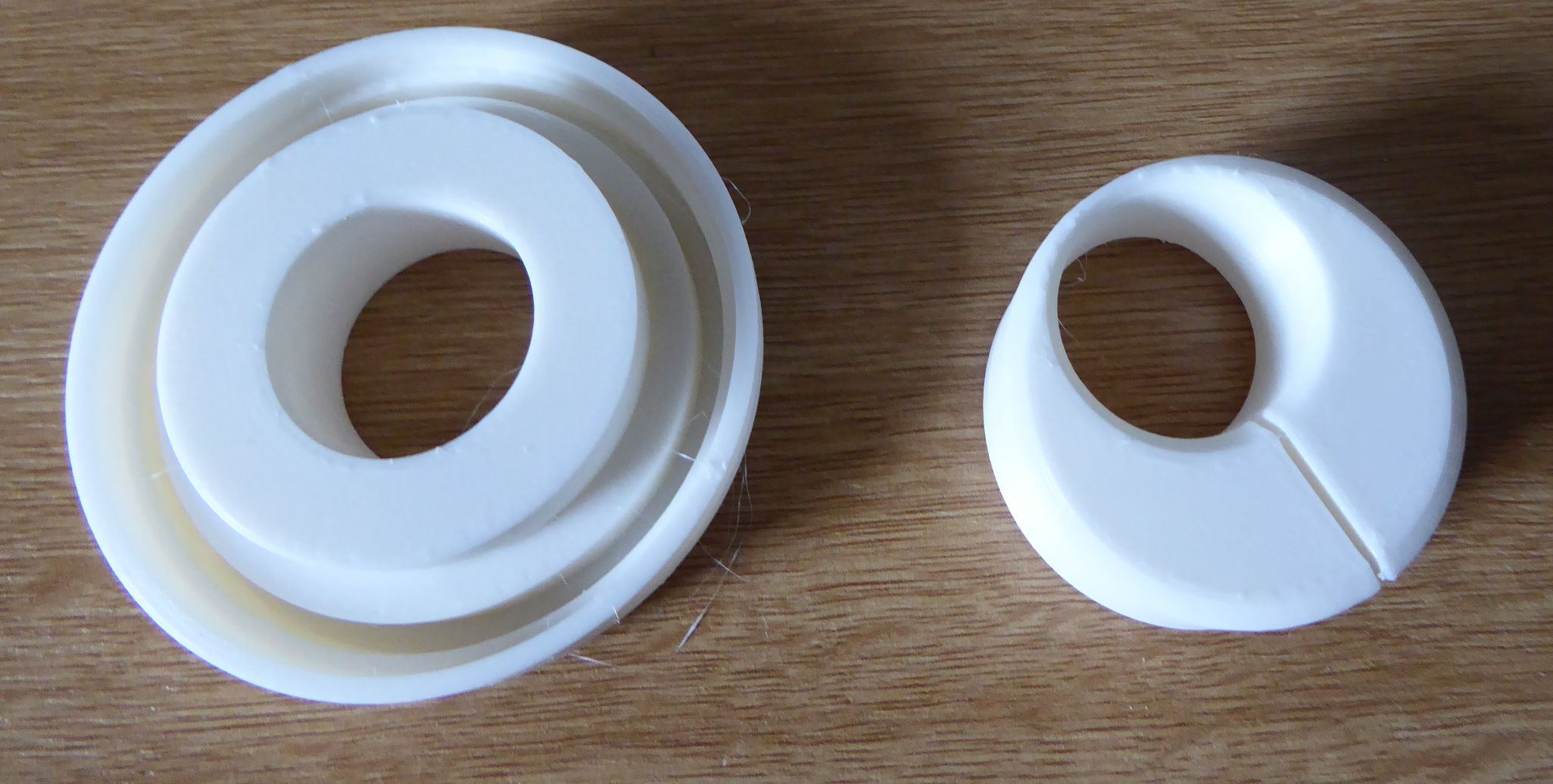

It isn't necessary to cut up the LNB any more, though you can for a compact solution. The simplest thing to do is cut a 22mm hole in the plastic front on the LNB and shove the 22mm pipe in until it meets the horn. A more sophisticated approach is to replace the plastic cap with a 3d printed adapter - Colin, G4EML posted a design in another thread. They work well.
I took a few to CAT (No, I don't have any to send). A 3D printer is becoming a must-have accessory.
