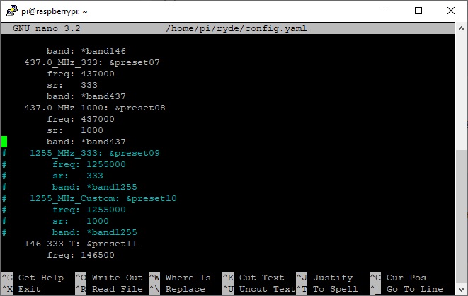

If it's of any use Robert, I just "commented out", rather than deleted, the 1255MHz channel entries (I don't yet have 23cm), to shift the new DVB-T pre-sets into sight as it were. It's probably a good idea to copy the original config.yaml file to something like config.yaml.ORIG so you can retrieve it if things go horribly wrong. It'll save you having to rebuild the SD card at least,
I logged into the Ryde via SSH (using PuTTY) and entered the command...
cp /home/pi/ryde/config.yaml /home/pi/ryde/config.yaml.ORIG
(this does the file copying)
...I then then typed...
sudo nano /home/pi/ryde/config.yaml
and inserted # at the start of the lines I wanted to be ignored. Let's see if I can add a picture to illustrate...
When you're happy with the editing you press <CTRL> X and then type Y to save the changes then press return to save the file name and exit the nano editor. Be careful not to add any extra spaces into any of the lines you want to keep; YAML is very fussy about indenting.
73, Martin

Post by VK3IE » Sat Nov 13, 2021 9:08 am
Yep all good Martin and thanks
That was the plan just to # them out and see what happens

Post by radiogareth » Sat Nov 13, 2021 12:04 pm
Thanks Martin, Worth adding this 'how to' to the Ryde wiki docs perhaps, worked for me just now. Don't want the 1000kS on the menu really and that brought the two 'T's into view.
