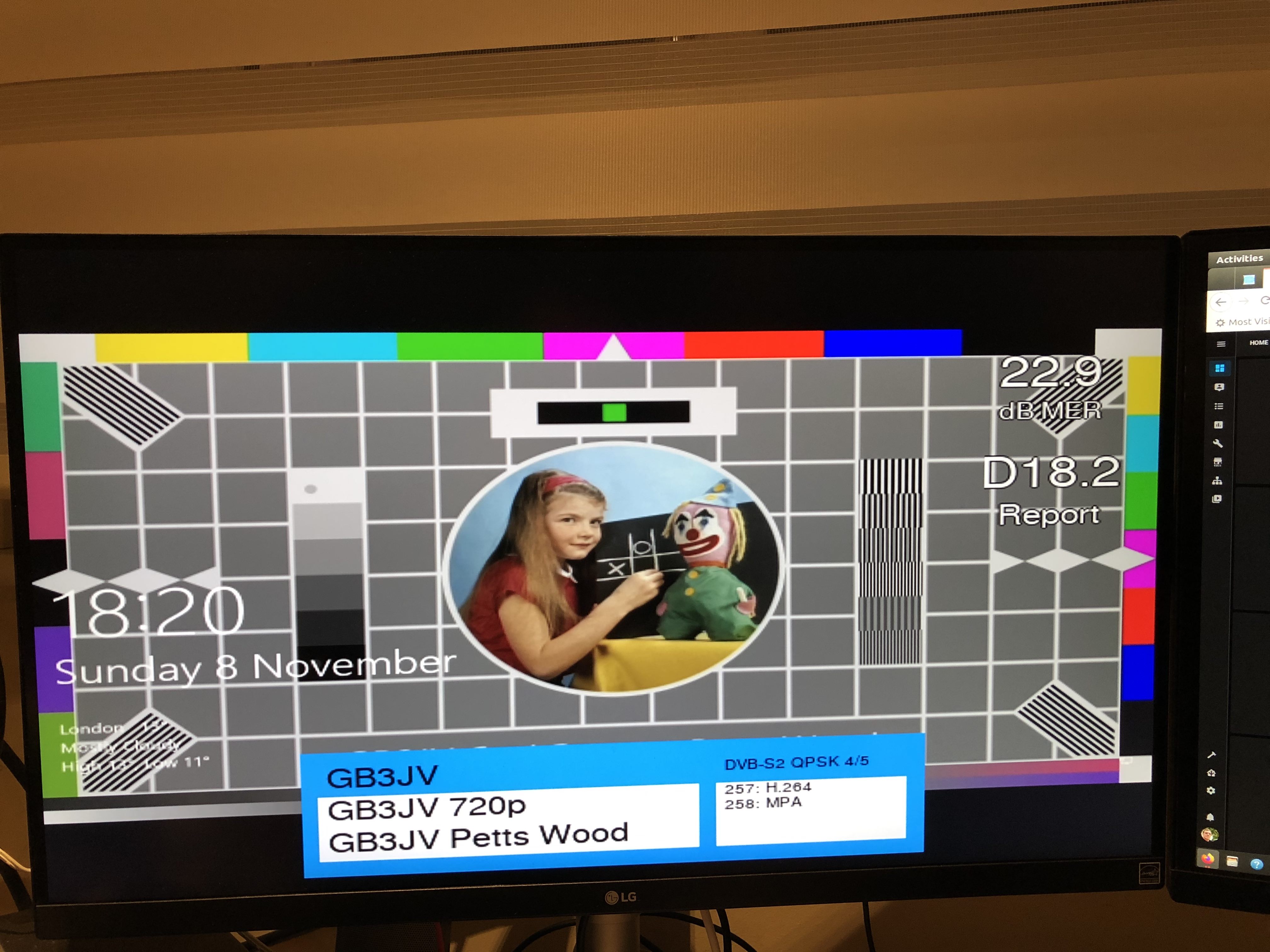

Showing issue with HD signal not in correct aspect ratio
I think the 4k issue was me getting confused with the preset issues, however the issue I am seeing is shown above.
BR
Justin

I have reproduced the problem that you were having entering 3404 MHz tuning frequency with a 5150 MHz LO above the signal frequency. I think that it is a calculation error in the prgram - all our testing has been on low side LOs. We'll look at getting that fixed.
The 20 seconds to lock-up is excessive. However I am concerned that you may have had some multipath on the signal as it dropped out a few times after lock. Signals seem to lock in about 3 seconds on my build here. Please could you try it on a clean RF feed?
