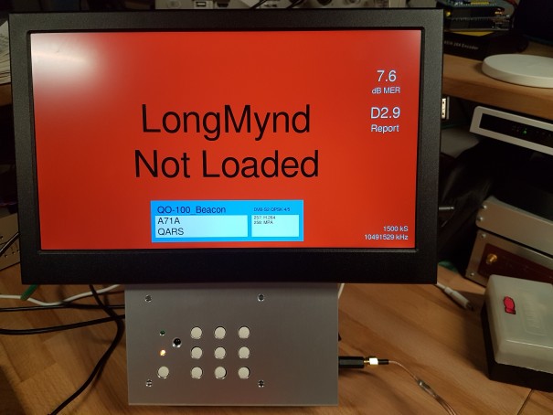

since the last development update I have a strange behaviour of the Ryde receiver.
When I start the whole system from a cold boot (except the MTPro v2, it is powered by another source) or a warm boot (sudo reboot on ssh console), Ryde starts and shows the "Longmynd not loaded" screen, but my RX led goes on,sometimes not and I can hear the audio of the QO-100 beacon:
In this case the keypad seems to be unresponsive for most of the buttons (only SELECT, BACK and OSD seems to work).
As soon as I start the receiver from the "menu" on the SSH console all works very well and the keypad is full responsive.
Maybe some differences in init on startup and via the console menu?
I already did a complete deletion of the Ryde stuff and a new install from the "install_ryde.sh" script.
Any ideas?
73, Thorsten

Post by dl9sec » Fri Jan 08, 2021 6:09 pm
Hi Dave,
as you told me via QO-100, I checked cable and monitor. It was indeed a bad quality HDMI cable which seems to make the parameter detection of the monitor unstable and caused that strange behaviour of the Ryde receiver. I changed the cable and it seems to work well again.
Thanks for the hint.
