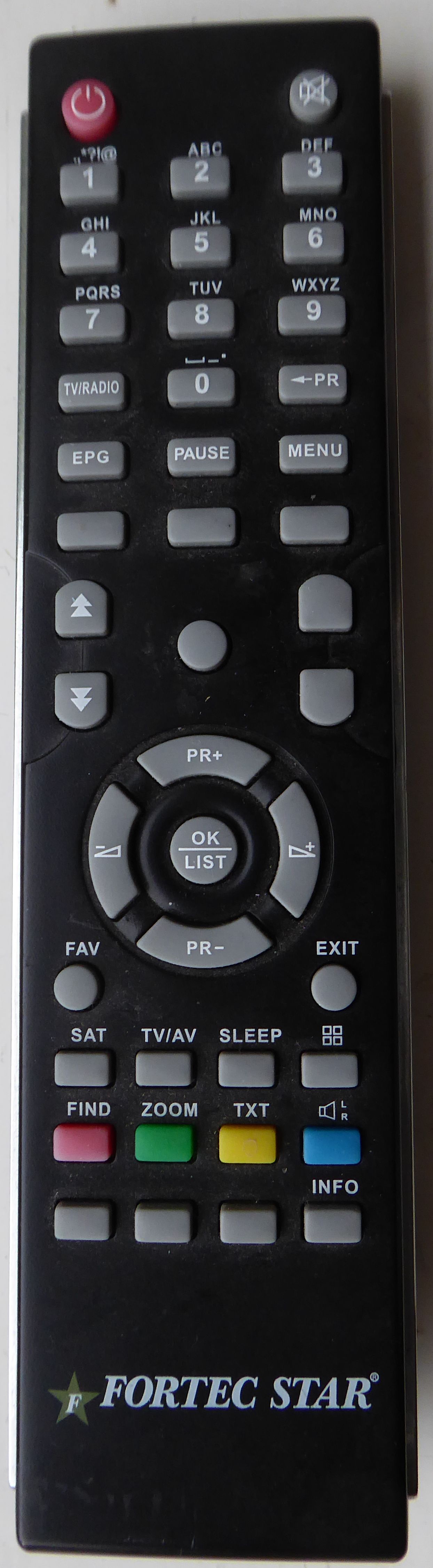

Fortec Star
nec x
buttons:
POWER: 0x1fddc
UP: 0x1fdda
DOWN: 0x1fdd2 #CH+
LEFT: 0x1fd99 #CH-
RIGHT: 0x1fdc1
SELECT: 0x1fdce
BACK: 0x1fd5c
MENU: 0x1fd95
MUTE: 0x1fd9c
VOL+: #Right
VOL-: # Left
CHAN+: 0x1fddd
CHAN-: 0x1f8dc
ZERO: 0x1f8d7
ONE: 0x1fd92
TWO: 0x1fd93
THREE: 0x1fdcc
FOUR: 0x1fd8e
FIVE: 0x1fd8f
SIX: 0x1fdc8
SEVEN: 0x1fd8a
EIGHT: 0xfd8b
NINE: 0x1fdc4
This one does not have arrows but does have volume and channels in a similar format.

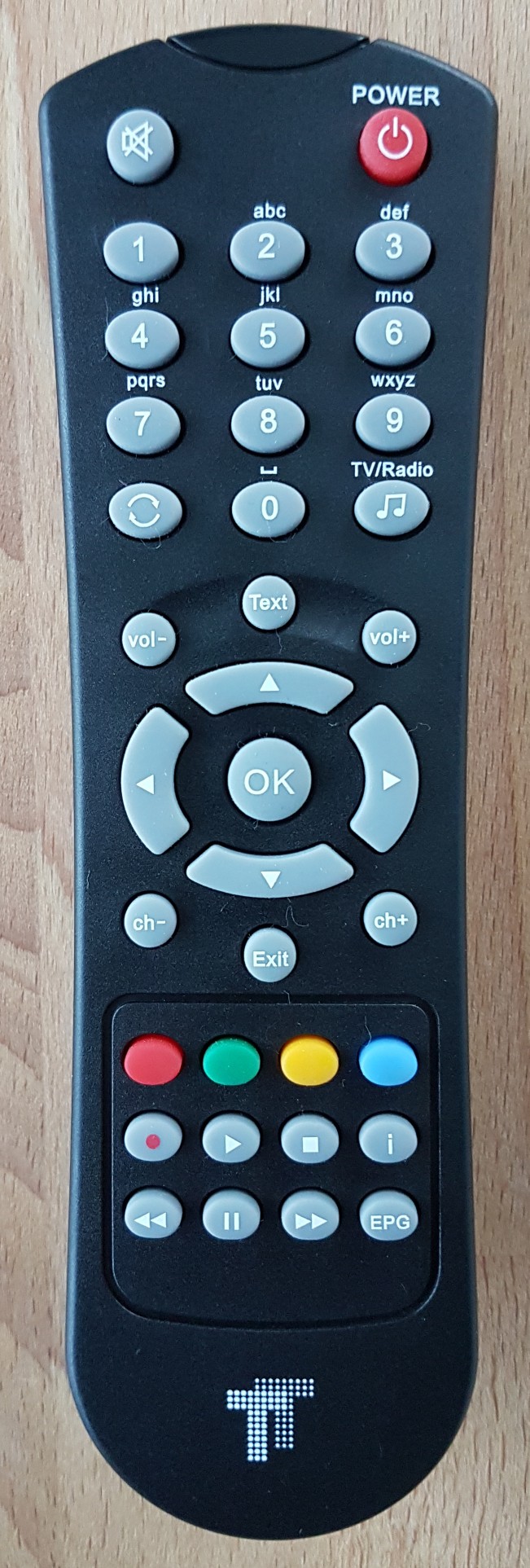

TechnoTrend TT-connect remote control:
TT-connect.yaml:
"Text" is MENU, "OK" is SELECT and "Exit" is BACK.
Works very well together with a Vishay TSSP4P38 @ 3V3.
73, Thorsten

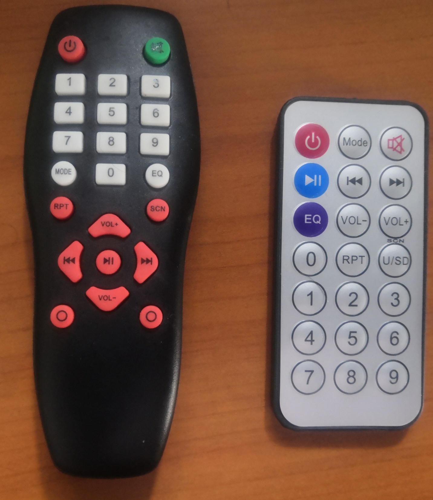

MP3 Player Remote
Code :
driver: nec
buttons:

MODE = MENU, EQ=BCK, RPT=VOL-,SCN=VOL+
Saro VU3OBR

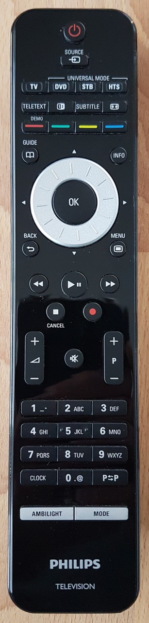

Philips RC 4492/01B (TV):
philipsrc4492.yaml:
philipsrc4492.yaml:
Code: Select all
name: Philips RC 4492/01B (TV)
driver: rc-6
